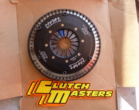

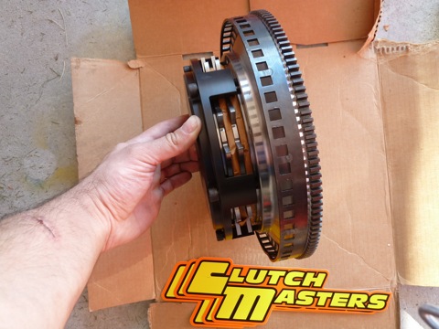

Damn impressive output! Was just in my friends APR stg 3 s4 this morning made me think of your car minus 300hp or so lol. What clutch you running on it currently? South Bend, Clutchmasters, etc by chance?
My friend has RS6R in his car with 22 psi , he scared of my car , he always say I need a helmet while I'm loging your car lol runing CM 725
Idk why you asking , but for DD 850 siries a lot better , I didn't know while ordered mine

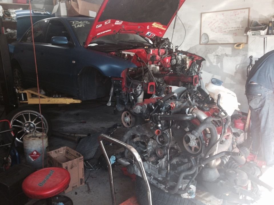

so the season is over , I decided to work on the car some more , and shoot close to a 1000 hp , there is few last races I had 3 weeks ago
the car plastidipped now and looks like this
right after this even I took the car a part
so new heads , over sized valves , intake , inlet pipes , 85 mm throttle body , will see what happens .
ps I don't need to freaking fast car , someone buy my 911
