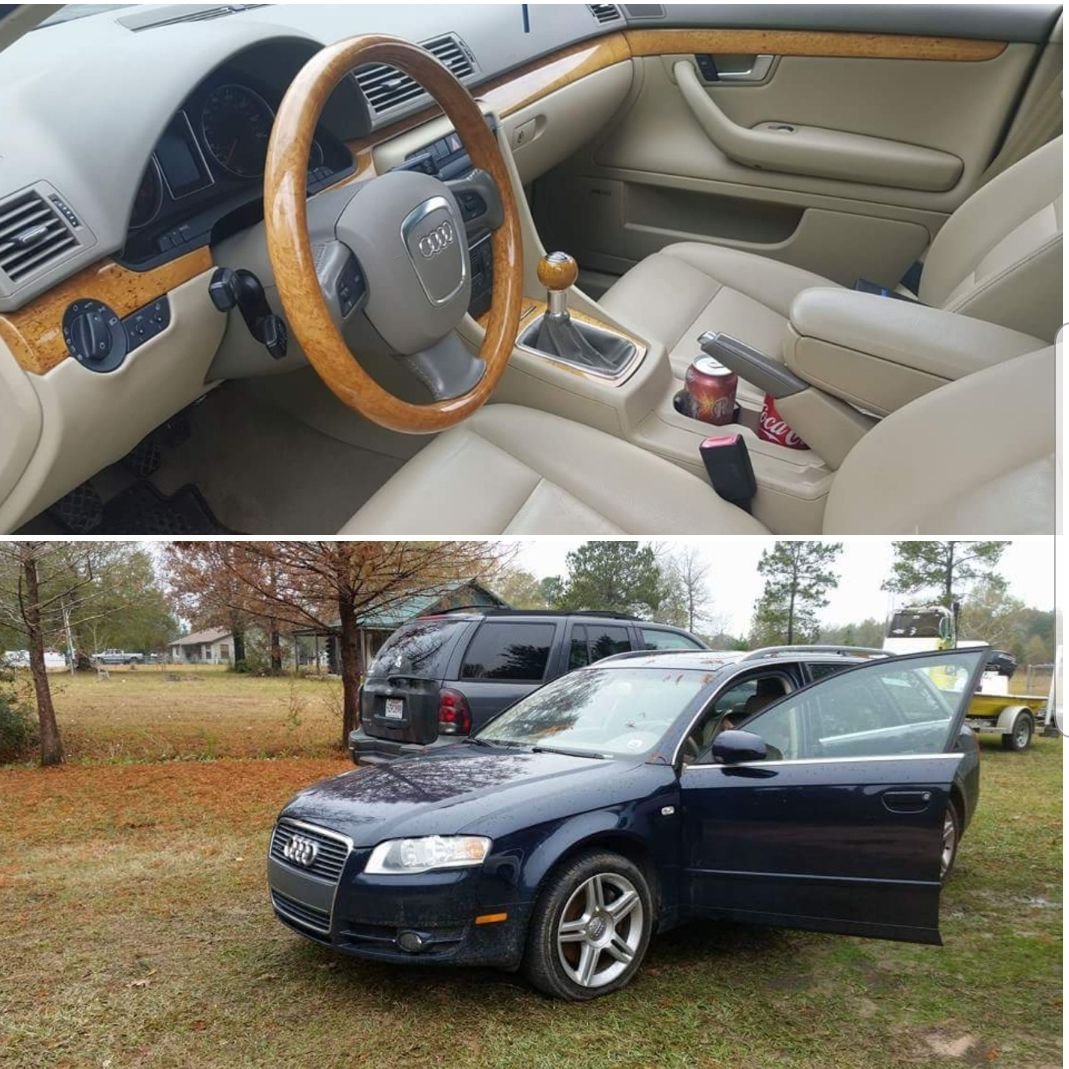

I'm currently stuffing (actually has more room on the sides than the 4.2) a W12 in my B7 A4 Avant with a 6spd manual transmission. I will be maintaining the AWD setup as well. The engine and transmission are mated finally and have a twin disc clutch setup between them. The engine wiring harness has been modified and rerouted to fit the B7 factory ecm box and harness boot. I had to pull the harness apart to move several sensors that went into the car and out a different location into the engine bay. I had to condense a lot of wiring. Getting the harness through the original harness boot was a job in itself. The boot didnt want all those wires ran through it and fought me the whole time but I finally got it done and the wiring fits and looks like it came that way from the factory. Next phase is removing the interior so I can start running all the necessary wiring inside for relays, fuel pumps, exhaust dumps, ect. I look forward to gathering information from the forum during this build.
My difficult project
Interior after removing fish scale trim and installing light birch trim from 3 different audi models. Wanted all black interior but Avants are hard to come by. I picked up this avant and the A8L W12 for 2500.00 total so this project is way under budget considering the cost of the engine alone through scrapper sites.
