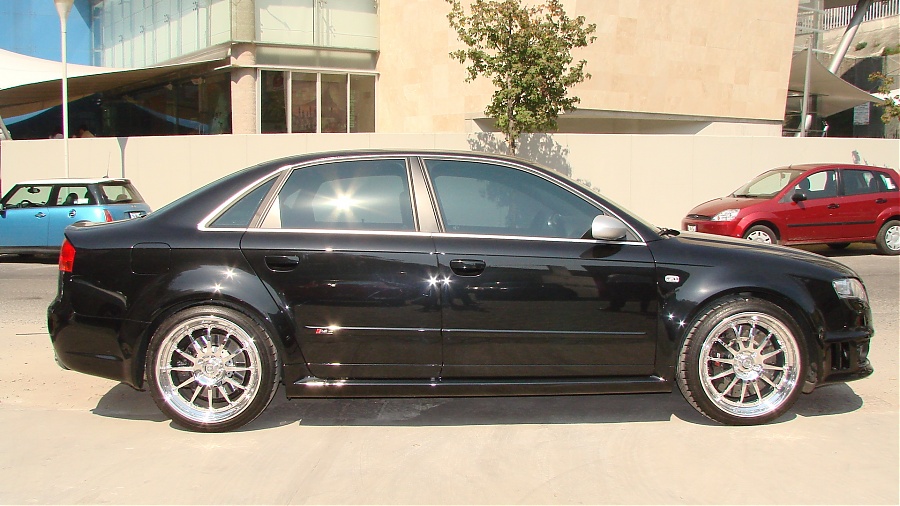

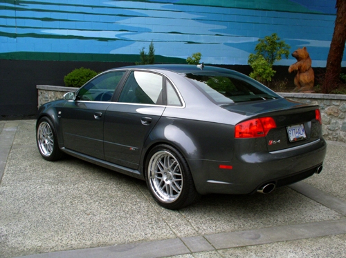

Let me clear a few things up. The reverse drop center rim design is not exclusive to HRE wheels, nor is it designed by HRE. Any 3-piece wheel that uses the same parts as HRE (as most of our competitors do) will have this exact problem. I agree that the design can be improved, but at a huge investment. Standard wheels (non-R and competition series), and the monobloks will not have this problem, as they do not have the well in the center of the wheel to collect water during rain driving.
With our 840R/590R/890R series wheels, we can get 2.5" lips on this car. With the 790R/940R series, we can get 3" lips. 540/540R/C-series wheels will most likely be 1.5" lips.
here are some RS4 photos (this is all i have right now):

So the non monobloks do vibrate in the rain? Can you help us understand why this is caused? This is the first time I've heard this...

Any "R" series wheel has the drop-center towards the inside of the wheel. This creates a trough between the drop center and the face of the wheel. I have personally never felt the vibration, but we don't get that much rain here in Southern California. It depends on what speed you are at, and how much it is raining, but a vibration is definitely possible. this trough can fill up with water and throw the wheel out of balance...it only takes a little bit of water.

Are you talking about where the spoke meets the rim? I see that the end of the spoke practically lays on the rim, rather than where you see the bolts. If it were to meet where you guys put the bolts, would it prevent the rain vibration? Is the vibration fierce enough to throw the alignment off?

The trough is behind the face of the wheel, between the back lip and the spokes. The vibration isnt insane, but depending on the car, how much water has accumulated, and speed, the amount of vibration varies. Can be a little shake or can feel like someone put the wheel weights in the wrong place.
