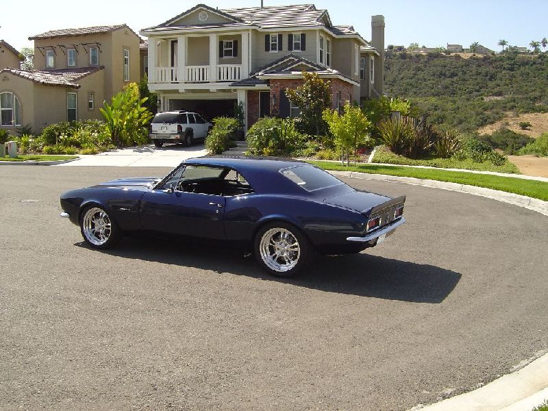

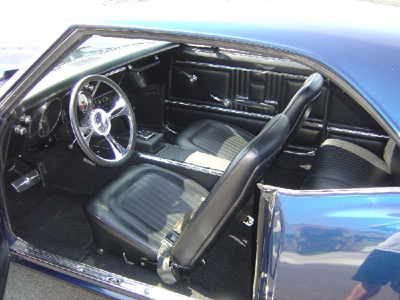

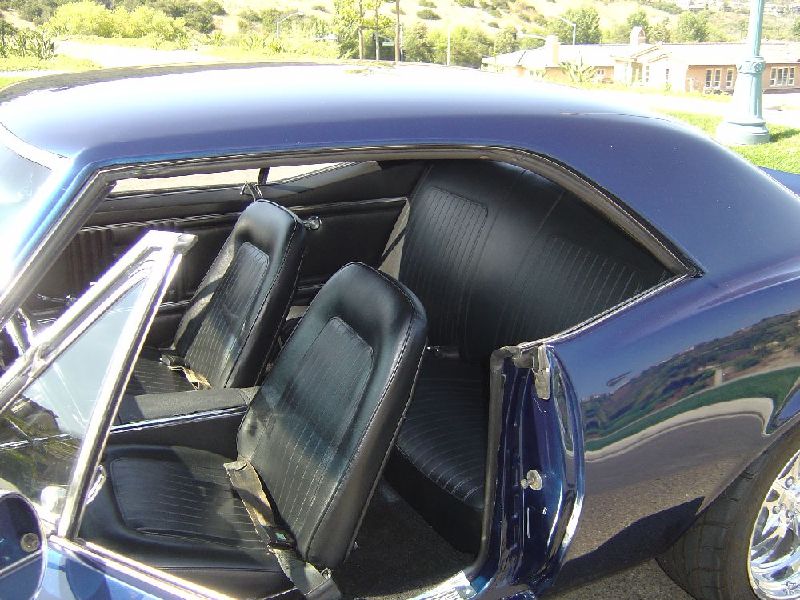

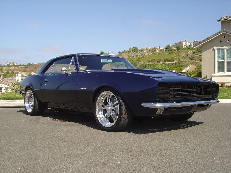

1967 RS Camaro built to pro touring specs. New 6.2L 376 ci. LS3 and 6L80 6 speed auto trans conversion completed 1500 miles ago. Out of a 2010 Camaro donor car. Just over 500 horsepower from this cammed motor with bolt ons. You read it right, 6 gears from this electronically controlled automatic. The front suspension has been updated with all new geometry from the ATS tall spindles and AFX suspension package. The rear suspension is an upgraded solid axle set up with a 10 bolt posi and 3.73 gear ratio. C5 Corvette brakes bring this 3340 lb Camaro to a stop in a hurry. Billet Specialties 18" Fast Lane wheels, DSE narrowed fuel tank(for future mini tub), shaved/painted firewall, and Corbeau TRS leather seats. The body, frame and interior were completed in 2004. About 5000 miles ago. With the conversion came a nearly new car that drives like a dream and is extremely reliable
I know I forgot something, too much to list

Wow, this is really nice car!! Good luck.

Wheels
Billet Specialties Fast Lane
Front: 18x8 (4.5” BS) 235/40/18 Kumho Ecsta MX studs/lugs M12x1.5(Corvette hubs and brakes)
Rear: 18x9.5 (5.5” BS) 275/40/18 Kumho Ecsta MX studs/lugs 7/16 (Camaro hubs)

Corbeau TRS front seats in black full leather
Corbeau black camlock harness belts
OER center console without gauges. Gauges in dash
Billet Specialties windshield wiper post covers
Billet Specialties rear view mirror with bowtie
Billet Specialties Fast Lane steering wheel Black leather wrap/small bowtie horn button
