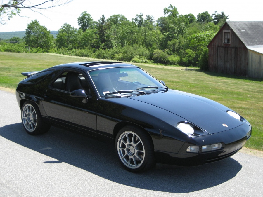

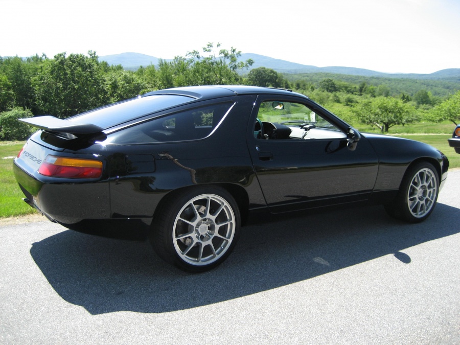

1987 Porsche 928 S4 5 speed Black/Black
-40% limited slip, 133k miles, lived in VA area ‘87-’04. I have owned from ’04 to present. No dash or pod cracks.
-Clean carfax, tons of service records, original window sticker. Hidden 6 disc cd changer, folding rear spoiler.
-silicone pan gasket, new motor mounts
-new shocks, springs (custom valved Bilsteins and Hypercoil 600/400lb springs)
-Custom 1 piece forged 18” CCW wheels to 928 offsets: 9.5” front and 10”rear 19.3 lbs and 20.6 lbs. Bridgestone 760 tires 265/35/18 and 275/35/18. Carl Faucett front under brace. Aluminum belly pans, all intact.
-new all aluminum C&R radiator, new cooling fans, water pump, timing belt, PK tensioner, cam sprockets, crank and oil pump sprockets.
-"full monte" done under hood done: intake and cam covers off and powder coated, and everything refreshed under there: Knock sensors, gaskets, wot switch, gaskets, thermostat, heater valve, plugs, plug wires, caps/rotors etc.
-Full respray in ’05 single stage black.
-rebuilt steering rack, new ps hoses
-new H4 euro 8" headlights and new driving lights
-Venture shield clear bra
-New fluids every season. M1 engine and Redline 75/90 gearbox.
-new battery, clutch master, clutch slave, clutch lines,oil hoses, windshield.
-all new fuses and relays.
-2008 rebuild of A/C system and uses R12
-2010 new Timing Belt, PK tensioner, “Engine Guardian” 2 bearing water pump
-new axle shafts, upper control arm bushings, tie rods and lower ball joints
-New Bridgestone 760's 5/2011
-Other upgrades: sport seats, GTS shift ****, short shifter, new shift linkage components, full GTS brakes, 33 bar bias valve, stainless lines, drilled rotors, GTS aero mirrors, H4 euro headlights, lomas X pipe, removable high flow cats, GT resonators, club sport rear muffler, tinted windows, Momo wheel.
-Mechanical work performed by David Chamberland and a/c by Earl Gillstrom
A/C is cold. Car runs great, runs cool, sounds great, shifts great, and everything works like it should.

some pics

sweet 928, what a classic! manual is pretty hard to find on these.
