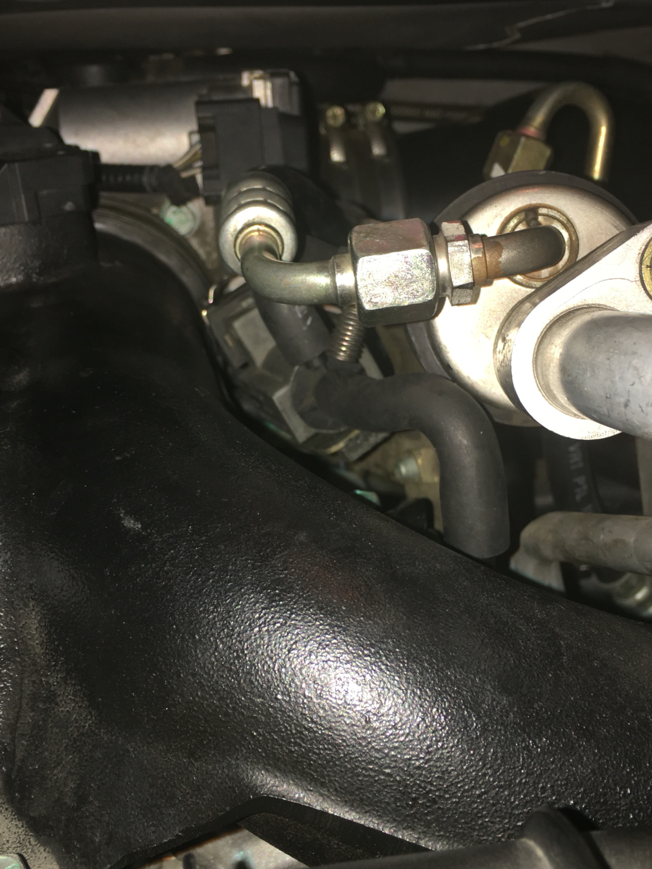

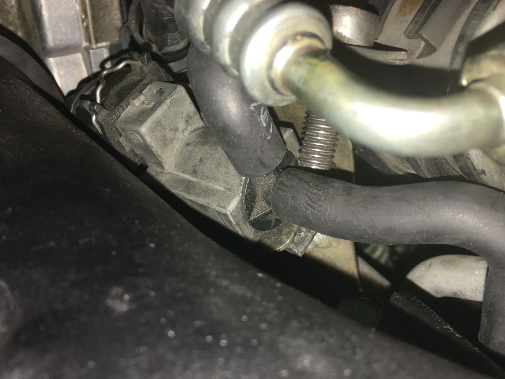

Am I crazy here or is my n75 installed upside down?
ID:	434766   Click image for larger version
Upside down, yes, but the hoses appear to be connected properly.
Why is it upside down ? Who did what to do that ?

So, the motor was out not too long ago to work on the variator oil rings. I have a good feeling they didn't plumb everything correctly going back in. May begin to regret this purchase.
I've got a Durametric on the way as well as markski's boost leak kit.
I went out and did some driving today, just wanted to get some more facts around what I see going on. Here is what i'm seeing. And i'm hoping it's something as simple as the N75 or the hoses going to it.
