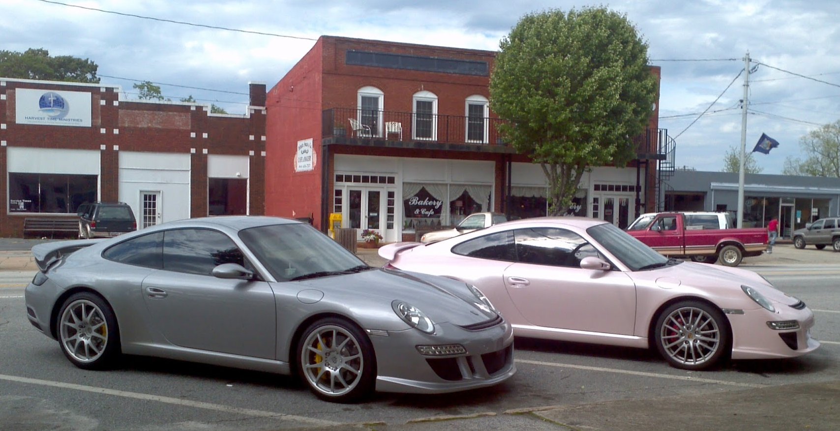

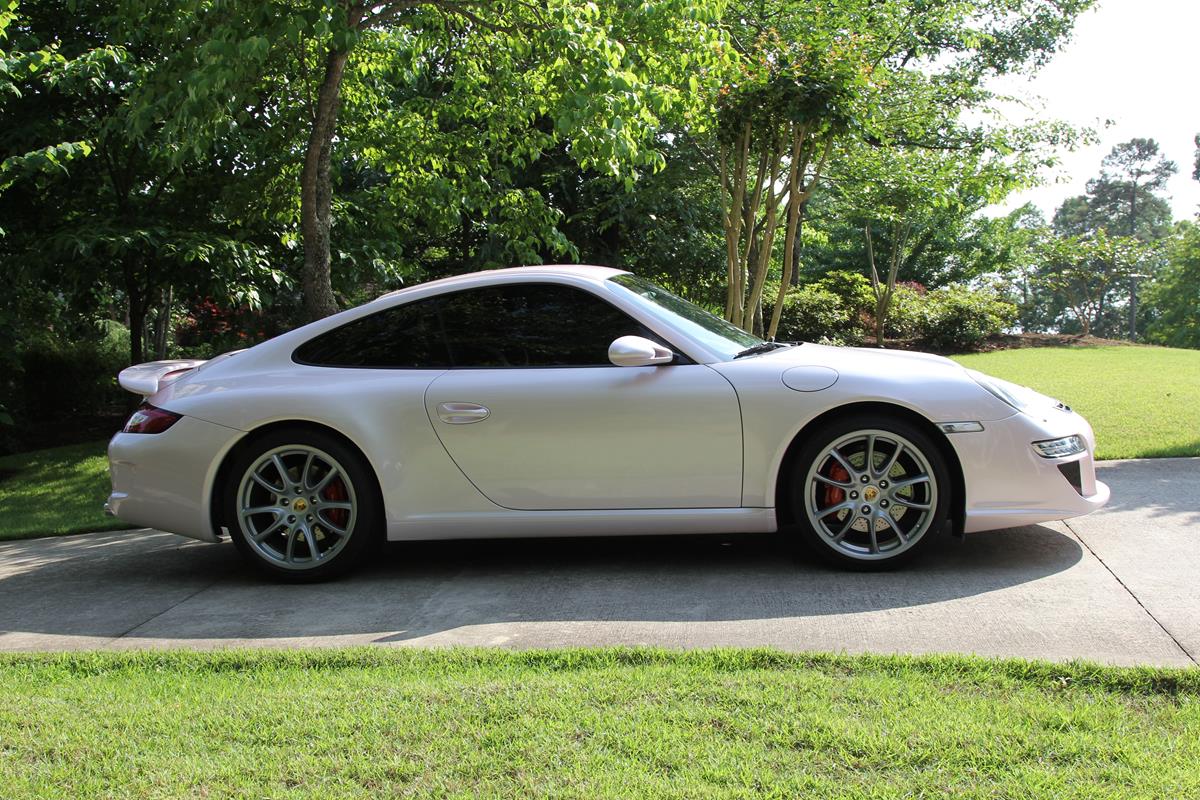

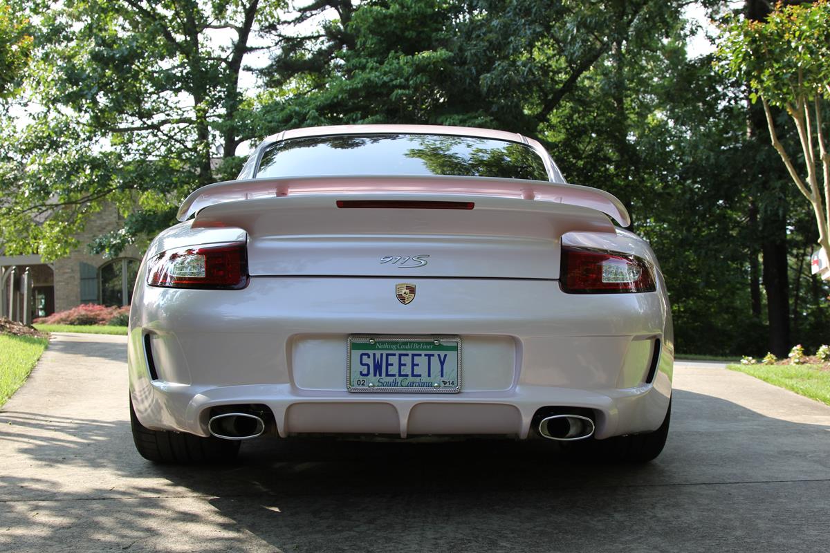

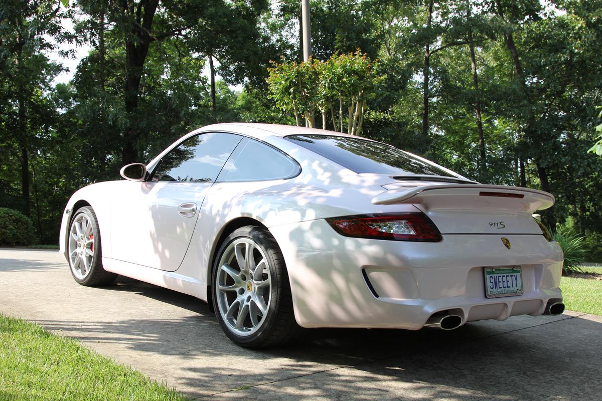

TT Decklid Mod
I did this mod on my wife's pink pearl C2S. Bought a new OEM fan for a TT decklid, used the EVOMS intake, and a new TT wiring harness, which plugged right into the engine bay connector. You'll want to have the special spanner wrench upper wing removal tool available cheap from ZDMAK to prevent scratching of the hydraulic pistons during installation (http://www.ebay.com/itm/Spoiler-Span...f5d204&vxp=mtr).
I first had a K&N intake, which actually fit, properly, but didn't like the plastic tubes in that, so I returned it and bought the EVOMS intake, which has metal tubes and is of much higher quality.
I have a Fabspeed CF intake on my RUF R-Kompressor car and took that off to test fit it onto my wife's to see if that was an option before buying either of the above. With the central placement of the Turbo fan on the decklid, there was contact with the Fabspeed intake pipe, which is what made me go in a different direction. It's possible that modifying the fan bracket could make that one work, but didn't see the need to do that with other choices on the market.
I liked the active aero on my wife's so much, that I actually fabricated a way to make the fixed RUF bi-plane spoiler wing on my car work the same way with 996 TT hydraulics (that was a much more involved project as the RUF Carbon Rear decklid does not have prefabbed mounting locations for the hydraulic pump).
Having done the TT decklid mod myself, let me know if I can answer any questions for you. Current price here is a steal on a complete TT decklid - the Porsche salvage yards (like LA Dismantler) want thousands for these things. Good luck.
