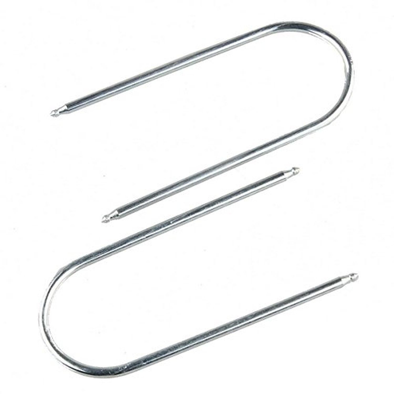

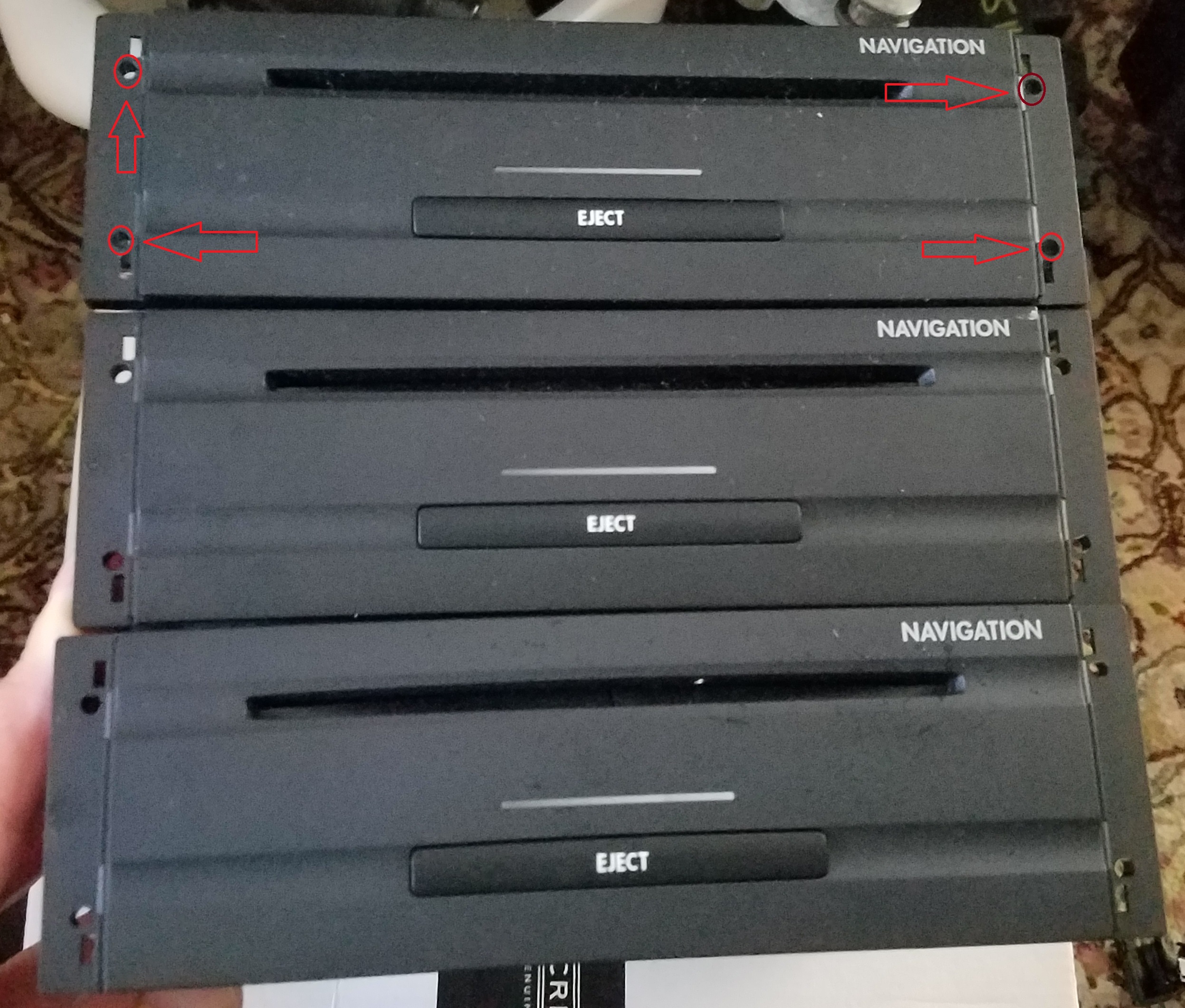

I may be confused at the moment, but I thought the removal tools were the U shaped ones, not the flat blade, I may be wrong....
Also, I do not remember pulling on the keys to remove the unit, it kind of pops out a little when keys are inserted.

Yes, the U key. Sorry, can't load his link. Thx Johnny for posting.

Hey everyone and sorry for the late reply. I finally got the tools to remove the CD changer unit and they aren't what I thought they were so no wonder I couldn't manage with the keys bought on Ebay. Ordered them from flyingspares for only a few bucks. Removed the unit in 3 seconds, the keys just click in and I was able to remove the unit very easily. Here is a picture of how the keys look like.
