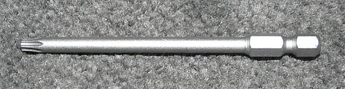

Tools Needed:
2.5 and 3 Allen
Torx 20 (normal bit Plus YOU MUST HAVE a 3.5-inch dedicated (see pic below)
Torx 25 (normal bit)
A body capable of being a contortionist. If you have back problems DO NOT try this at home!!!!
DICE unit is the I-VW-T/5V
Suggested clothes: Sweat pants and a t-shirt. NOTHING with rivits, NO buckles, etc and remove ALL jewelry. You will be sliding and moving on the leather and carpet in positions only a contorsionist would normally attempt.
THIS IS THE LONG WAY AROUND, see top of this post for a much faster, easier and less risky way of removing the CD changer.

There are three Torx 20 screws in the front and three in the rear. Trust me here, you need the 3.5-inch Torx 20 tool bit as photoed below or you may never get the rear 'hidden' screws out. The front is easy, i'd remove the right and left and loosen the front centre one. The rear ones are hidden so see my pic below. No way to really see these, so it is a 'blind feel' to remove the rear screws then remove the now loosened front centre one. The CD/NAV assemble will now be free to 'fall' down and work on.
