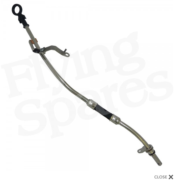

I suggest you have a look at the old and new part pictures or drawings and you will see that the end of the tube is CLOSED.

Please stop saying that the end of the broken dipstick falls in the engine.
No Bentley dealer in France has suggested an oil drain for a broken dipstick tip.... as it is not necessary
Uploaded with ImageShack.us
