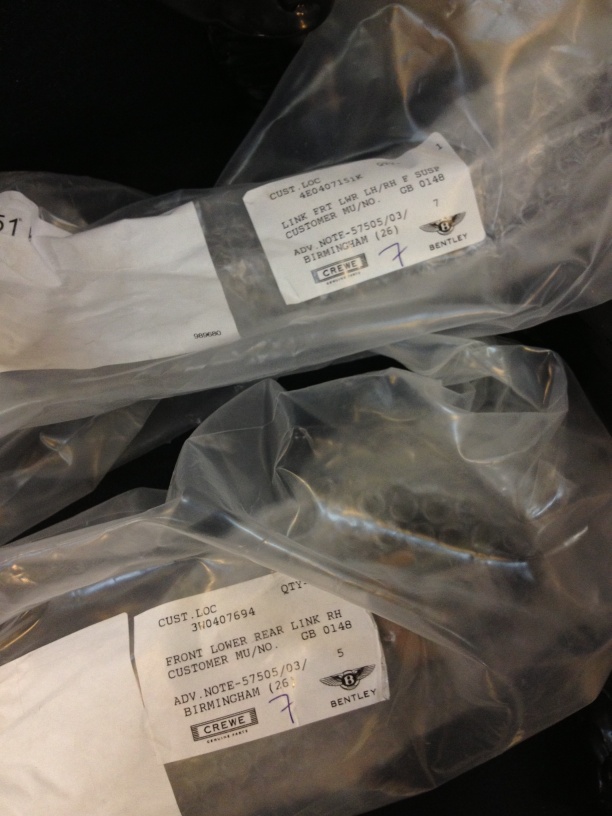

Finally found a garage that can service the GT and went for a wheel alignment. Told mech steering was slightly off to right and had vibrations. Mech checked car by slowly driving forward and braking whilst another mech observed wheel to notice a creep on the wheel. Car was jacked up and mech confirmed bushes on lower control arm were shot. Mech stuck a bar in the bushes and wiggled it to show how much play it had. I'm suprised the dealer didnt pick out this problem as when I asked before they said no need to replace. In my experience normally when upper arms are shot, lower aint too far behind for replacement.

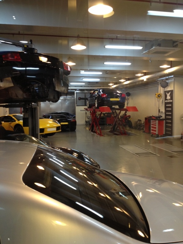

I wanted to try another garage and these guys had a collection of cars in their workshop, 5 Bentley, 5 Lambo of which one had engine out and a lonely Porker. Quoted USD2,500 for 4 control arms, labor, wheel alignment and ecu check vs dealer USD4,200. The size and weight the control arms are monstrous but I guess needed considering how much the GT weighs.

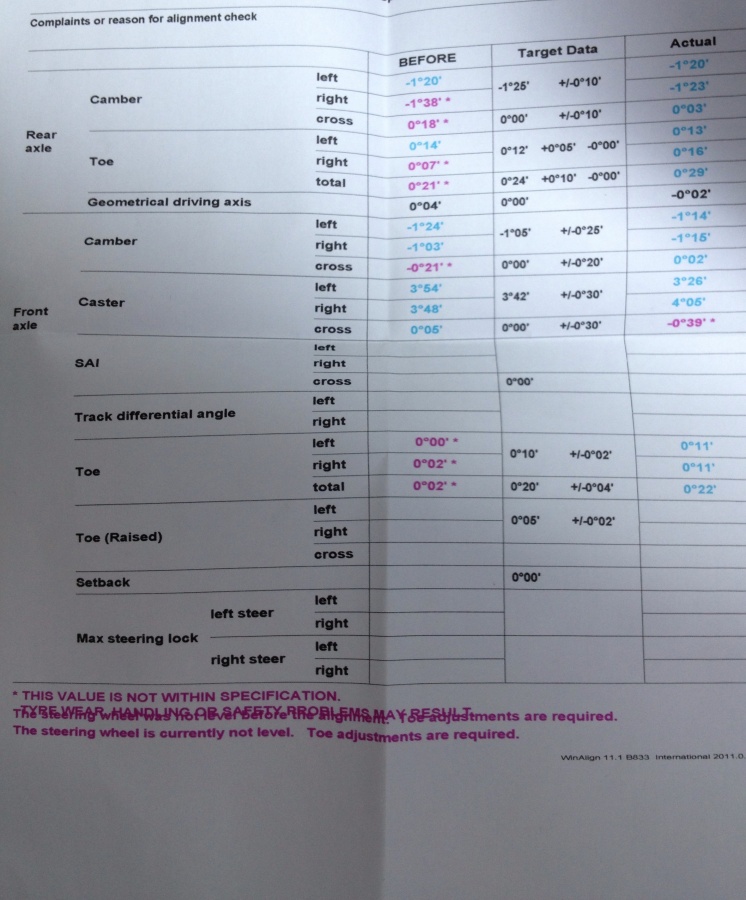

Thanks DJ for the pointers but the ball joints were a bit loose too, few cracks in bushes. I noticed the shop reused old bolts as arms dont include any other hardware. Any issues reusing old bolts as I don't think they are stretch type?
Dr, can has 72,000kms on the clock but I guess ageing comes into play as well. Steering is dead straight now and feels as good as new. Attached pic of alignment printout from their Hunter setup.

There shouldnt be any problem reusing your old bolts. Now your car is just as new! It's time to enjoy!

Thanks guys for reassurance. Talking to the mech he told me the subframe was dropped slightly in order to remove arms, not a simply bolt in/out job.
Looking at the alignment printout how comes the front right caster at 4.05" is still within range (blue) when it should be 3.42 -/+0.30? Left is ok at 3.26".
I know front caster cross is slightly off by 0.09".
