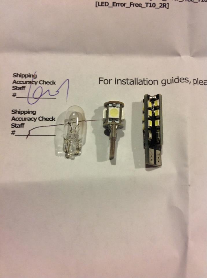

I bought two bulbs and wanted to use slightly longer one and luckily it fit easily. The white color was really nice and was pretty close to color of headlights and slightly brighter than stock bulb. I took pictures of driver side with stock bulb and passenger side new LED bulb.
Stock bulb and two bulbs purchased, longer fit easily so went with that one

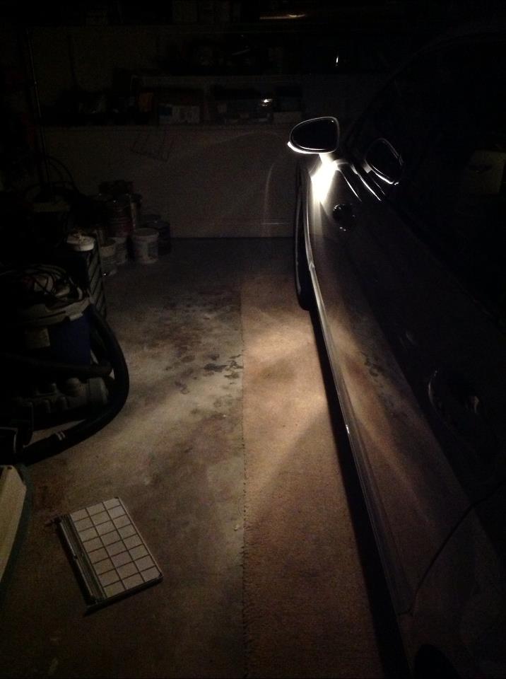

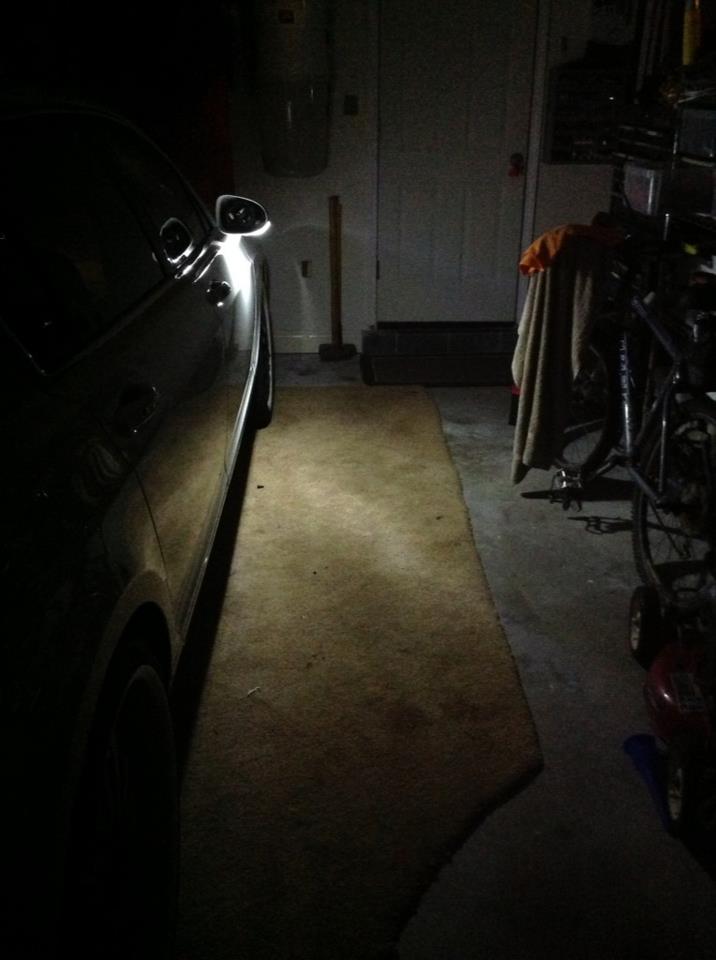

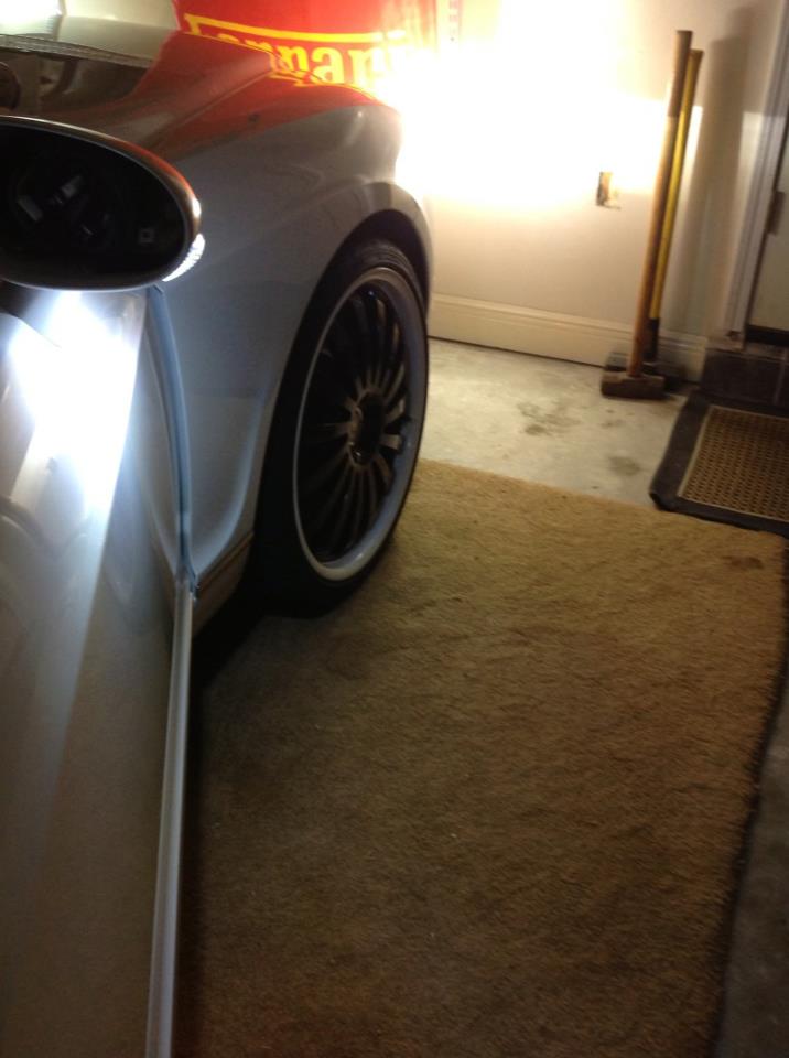

New LED bulb, nice white color and slightly brighter
Another view, LED is close to headlight although I used iPad for pic and headlight has ore orange look to it in pic.
For comparison, here is pic of stock bulb
