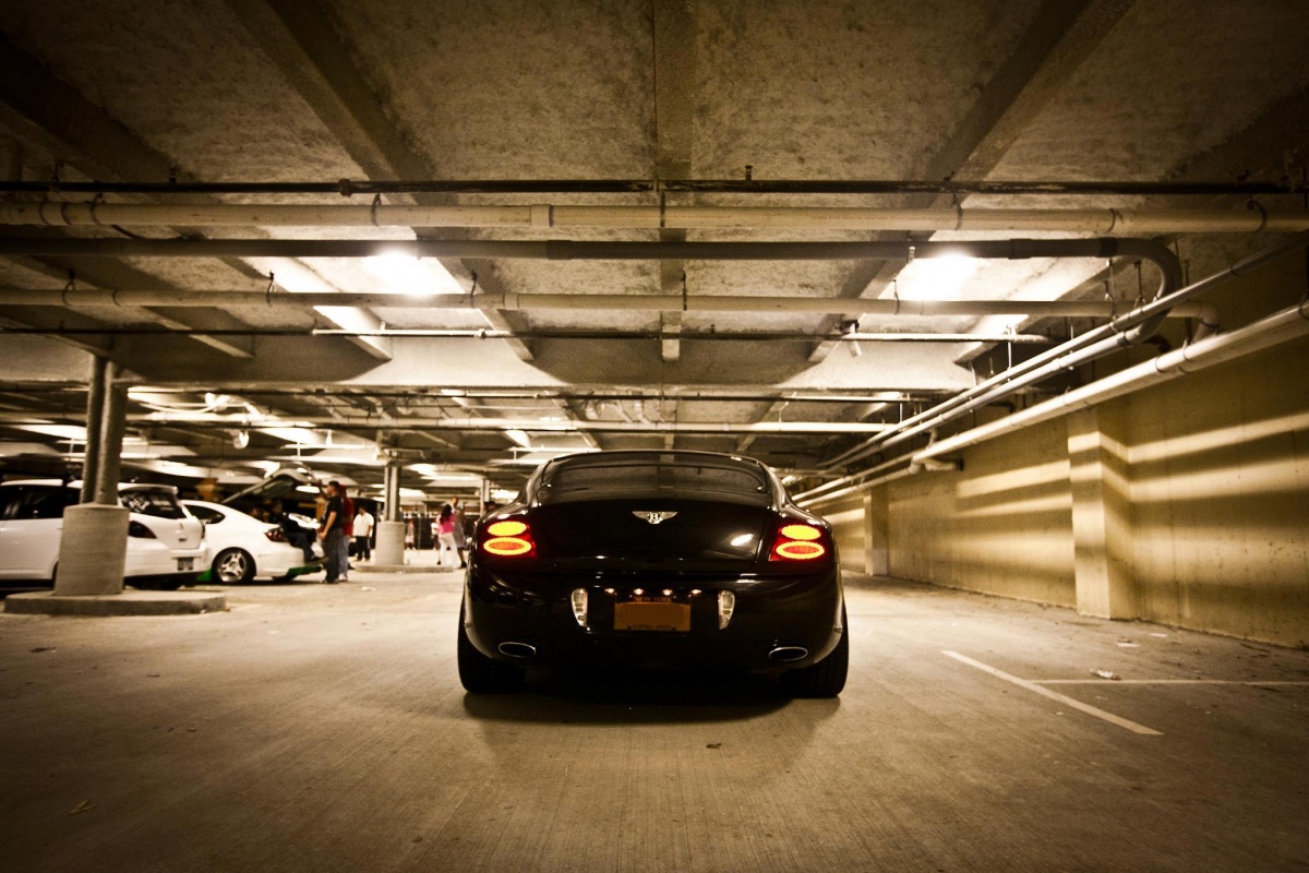

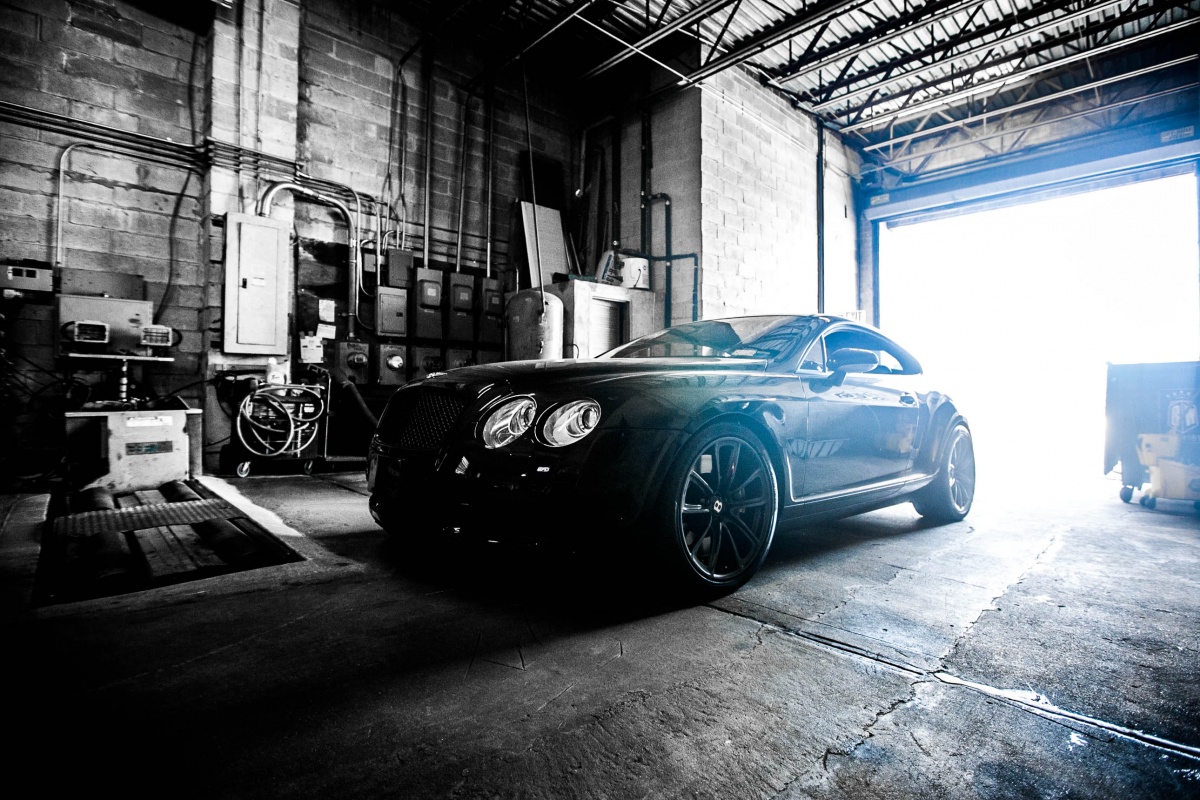

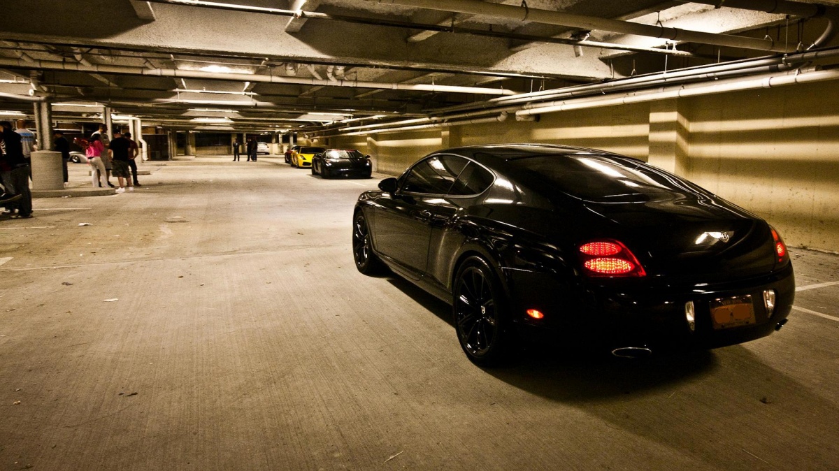

well, I dont have any problem with ss wheels, rear wheels have different offset so it rubs the rear liner little when there is a hard dip (rarely happens), but mine is lowered.

Seems they do fit then. Looks great. How did you come accross these wheels, were they already on or did you just take a chance?

I just took the chance and luckily Direct Performance Wheels had the take offs in stock so just bought them about a year ago.
seems like they have one more set available with cheaper price now.
