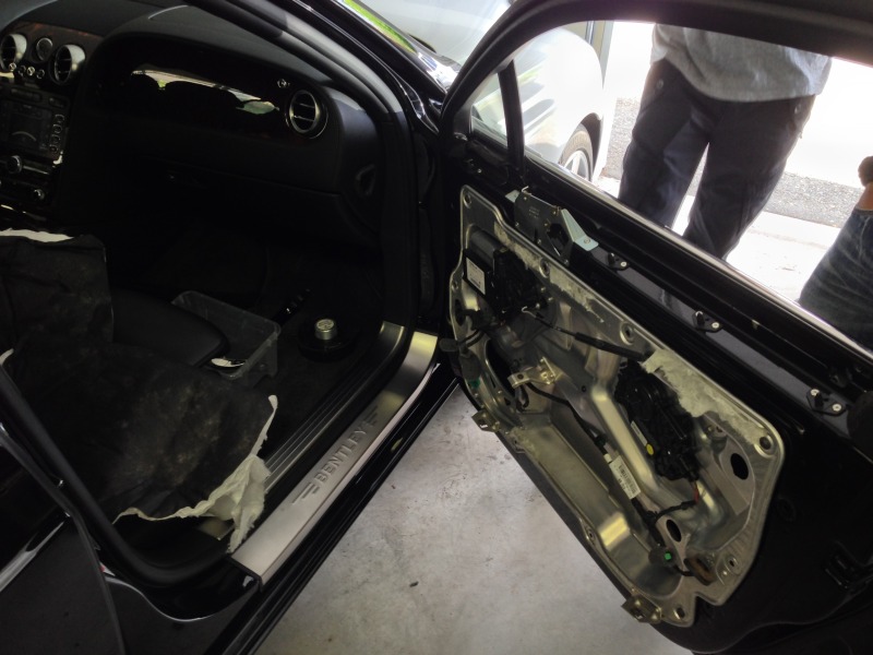

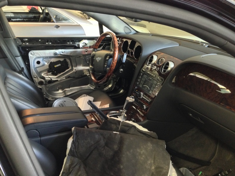

I'm taking off the mirror to install a sideview camera. I'm stuck at the last step of removing the actual mirror.
I've basically dismantled the entire door to try to get to the mirror. This car is very difficult to work with. No wonder the maintenance cost is so high...
The most frustrating thing about this car is different sort of harness connectors. It is almost like a puzzle that you have to solve to try to unhook one.
If I had known the difficulty of running a wire from the mirror, I'd opted for a simple front and back camera. I'm to far into the process now to back out...

I finally got my mirror off. The glass doesn't have to be completely removed. I just need to partially remove the front quarter glass.
The most frustrating part is to remove the two electrical plugs near the door lock. You can't see it so you have to use your finger to feel where the lock tab is and use a screw driver to pick it open.
Working on this car raises my frustration level to max because there are so many things should be simple to do but are made difficult due to poor and overly complex design decision.
