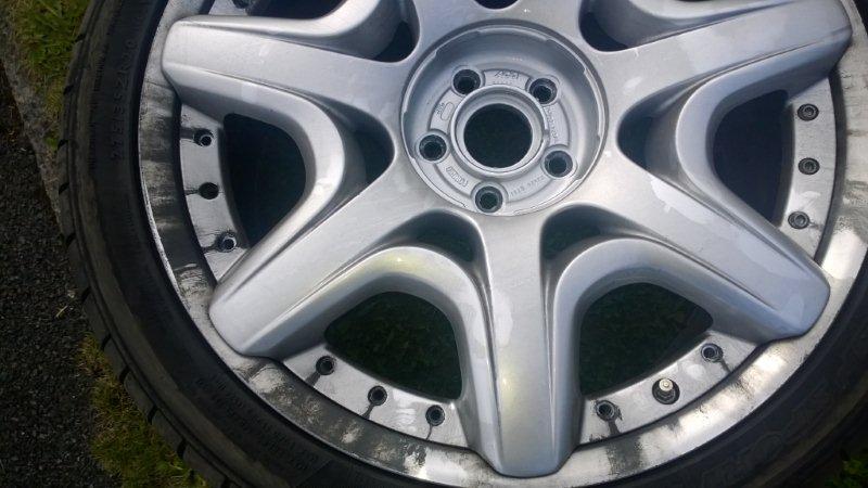

Think i found the problem, still quite shaken up so if some of this is mispelt or doesnt make sense please take that into account.
The wheel has shed about half of the bolts and has come apart, tyre just blew out on me causing swerve through the traffic lights to a stop. The rim centre is loose inside the outer ring, see the pic below.
My family were with me and i just drove home at motorway speeds.
The car was purchased 2 weeks ago, what should I do?

oh those rims are not meant to be taken apart,i would contact dealer who sold it,if you are not happy with there comeback to you contact VOSA and trading standards,before any car is sold it should undertake a safety check and include wheels and tyres in that check,i would ask for the safety check report and go from there.

Is there a way I can tell if they have been refurbed recently? They are very clean for their age and ofcourse the bolts coming out suggest they have been but some way if telling would be useful?

if you can see any witness marks on them from the tool used,check each bolt carefully,thats about all i can suggest.

As Bentleytech suggest check bolts for any signs and if I have a paint gauge you could check thickness to see if they have been sprayed. Of coz u need to compare with another GT wheel but just a suggestion.
Hope it all works out but someone needs to be held responsible.
