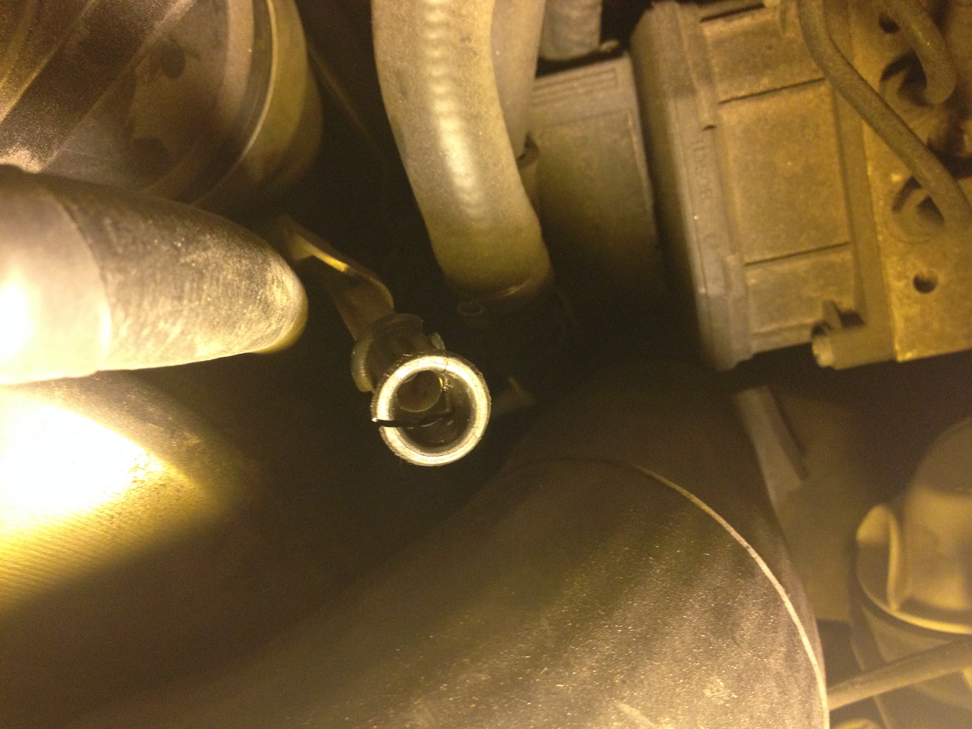

To my surprise, when I checked the oil dip stick, the part where it sits when its completely in is cracked. I'll post a pic on my next post.

Is that easy to change ? Is that the cause maybe ? I was also a bit low on the oil level so I topped it up.

the dipstick is very easy to change and if you already have a newer one fitted you can switch the top and that will reseal and should improve idle.

So I get a new dip stick at the dealer and it comes with the part I have that's cracked ?

yes the dipstick comes complete,and if you carefully remove the top sleeve you can transfer it to your damaged one,i would recommend removing the cracked one first to see how it comes off and to see if you feel comfortable doing it,if not you will need to replace the whole assembly which is a bit more difficult.

Yeah took my heat gun and warmed it up a little bit and it came right off. Kinda pissed that I'll have to buy the whole thing just to replace that part...
