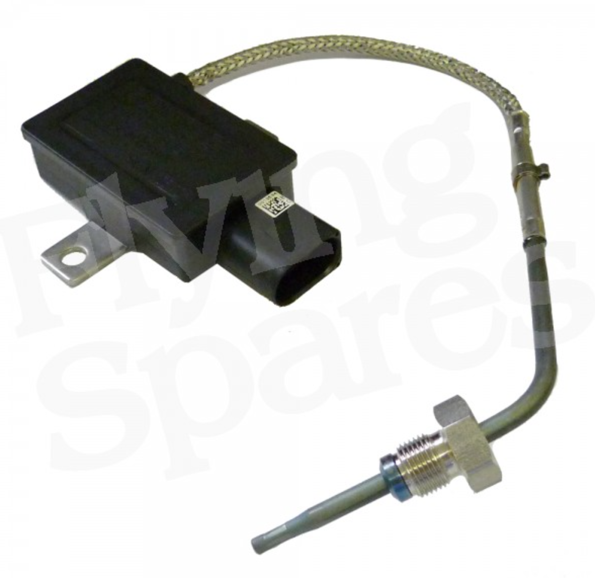

I think your description are for lambda sensors but I could be wrong, uploaded photo of concerned part.
I am not familiar with EGT sensor which has a small circuit board as the fault code I received was "G235 circuit malfunction". Indeed quite a sub-standard part from the dealer but being nearly two years ago and I doubt they will warranty any claim so installing another at independent workshop.

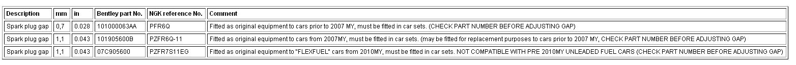

Whilst at workshop also getting coolant and brake fluid replaced but holding back on spark plugs. I found out all pre MY07 cars used NGK PFR6Q (0.8mm gap) and after were NGK PZFR6Q-11 (1.1mm gap). Has anyone switched to the 1.1mm or other plugs and notice any difference as the larger gap produces a larger spark to maximise burn efficiency.

The part I replaced was the exhaust gas temperature sensor (3W0971963E) (bank 2). I believe you replaced the sensor on bank one (1J0973703). These sensors measure temperature (unlike the O2 sensors) which measure the O2 delta ahead and behind the pre-cat. Unlike the error code I got which pointed to the sensor itself, your code points to the circuit board that reads/interprets the sensor. In the end, we both had to replace the assembly but perhaps for different reasons.
re: plugs. I have included the chart showing the factory recommended settings for gap. (for your application 0.7 gap). For your possible interest, I changed the ignition coils at the same time I changed the plugs (45K miles) with original PFR6Q. I Didn't feel much if any difference and fuel economy was the same.

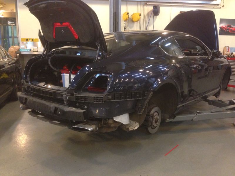

Car still at workshop so had intermittent faulty rear parking sensor replaced.
