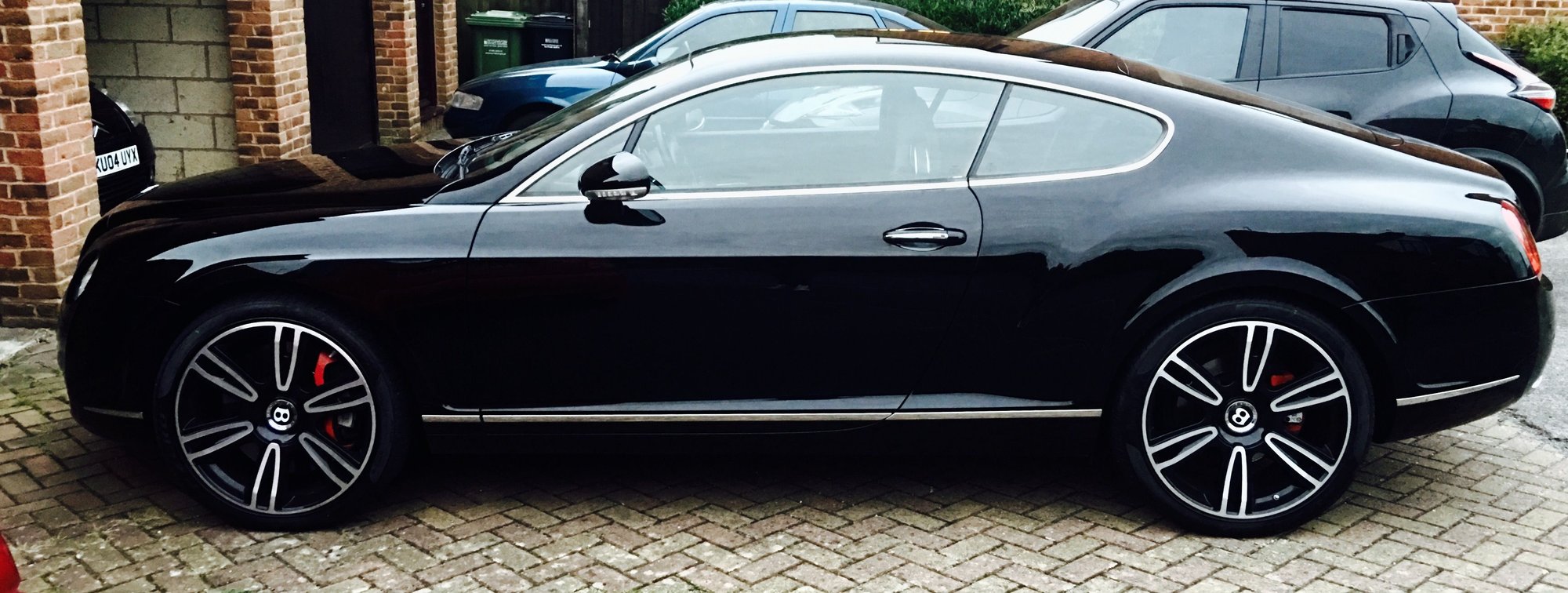

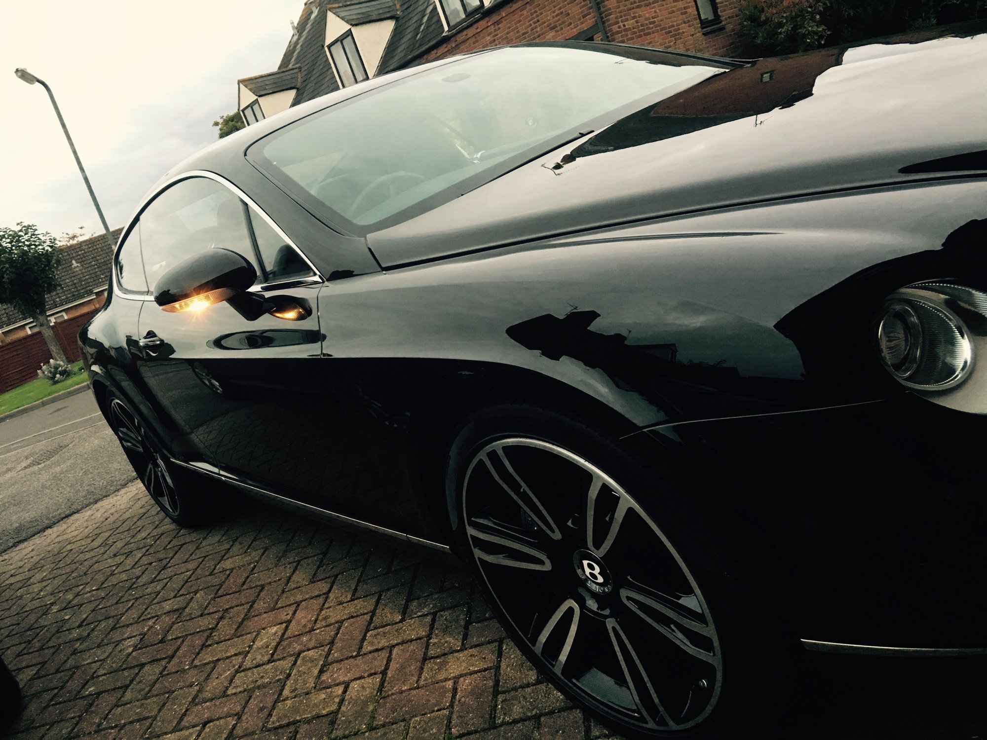

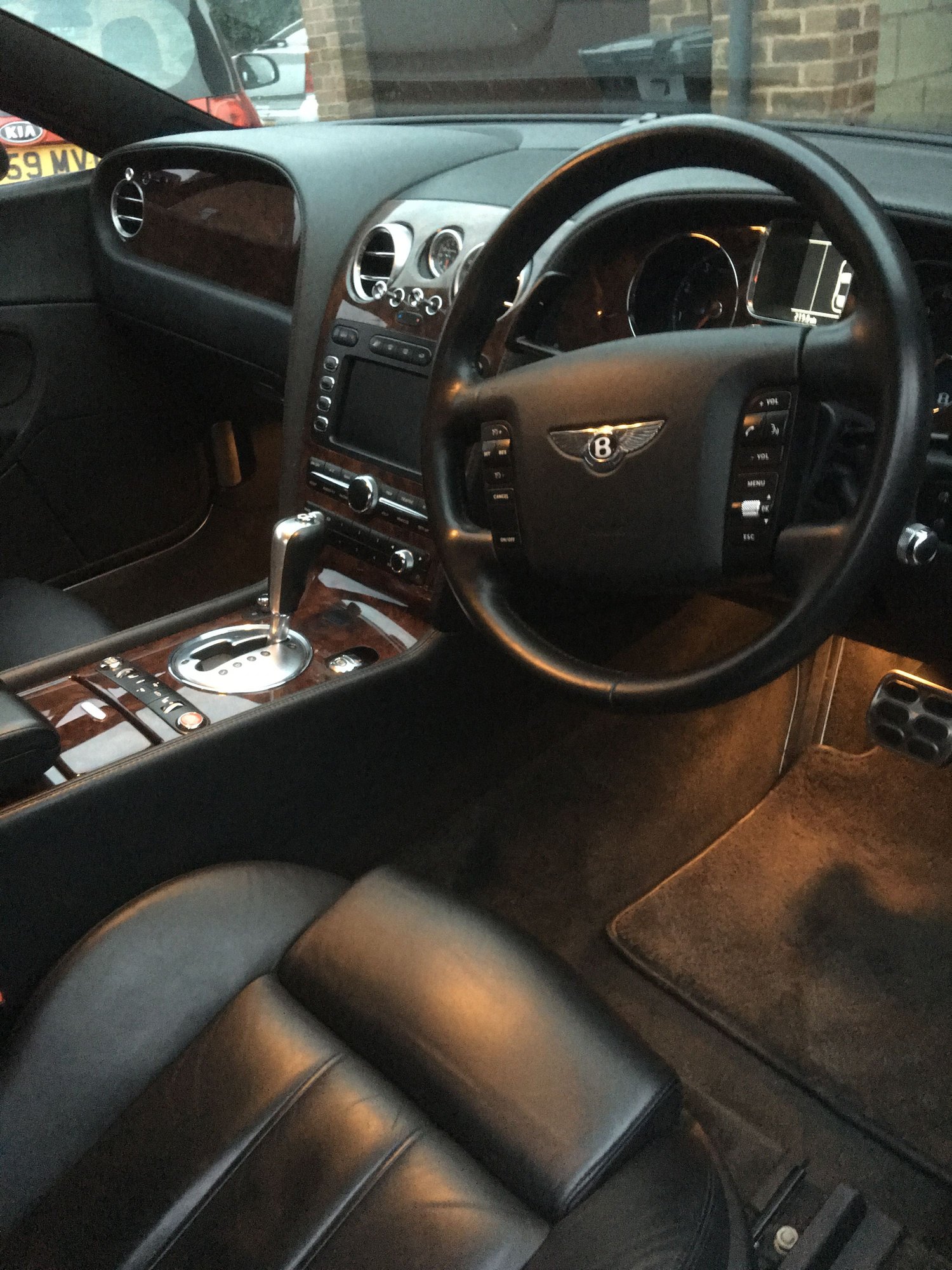

Hi Mike thanks for the reply, that clears the boot lid question up thanks.
Added some images :-)
