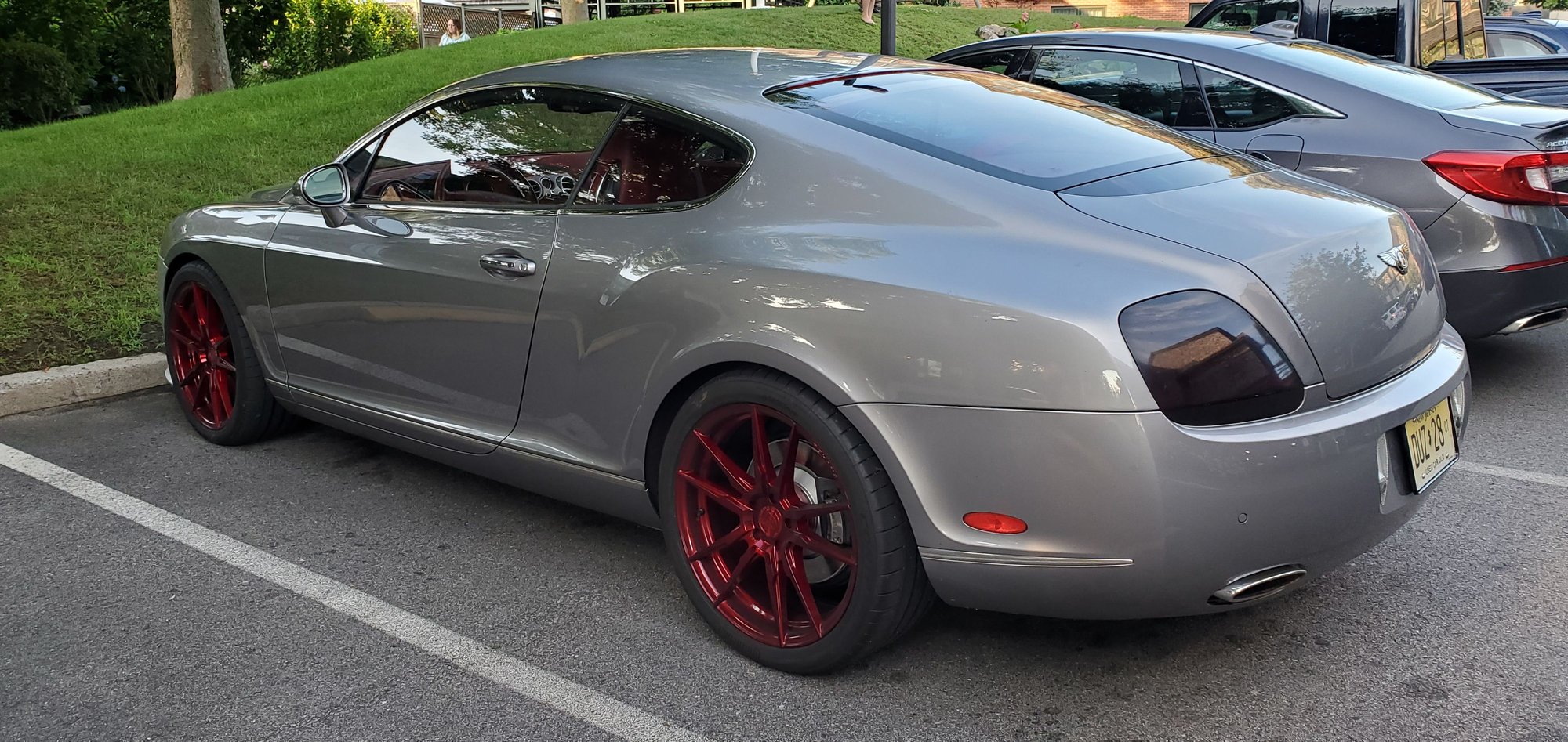

Old Aug 10, 2021 | 02:10 PM
  #272
Johnny Hotspur GT's Avatar
Administrator
Joined: Jul 2014
Posts: 3,946
From: Montgomery NJ
Rep Power: 1002
Johnny Hotspur GT Is a GOD !Johnny Hotspur GT Is a GOD !Johnny Hotspur GT Is a GOD !Johnny Hotspur GT Is a GOD !Johnny Hotspur GT Is a GOD !Johnny Hotspur GT Is a GOD !Johnny Hotspur GT Is a GOD !Johnny Hotspur GT Is a GOD !Johnny Hotspur GT Is a GOD !Johnny Hotspur GT Is a GOD !Johnny Hotspur GT Is a GOD !

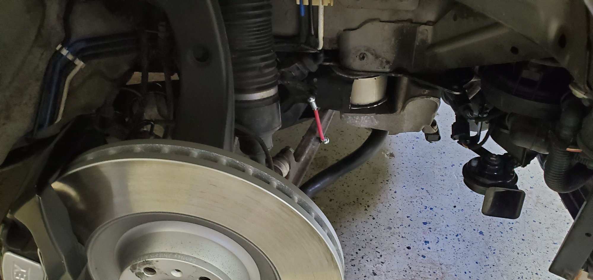

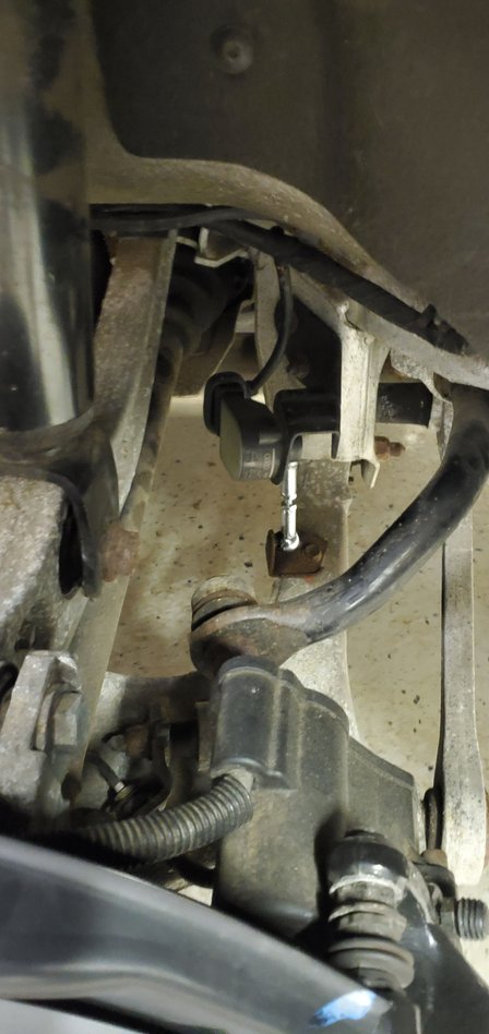

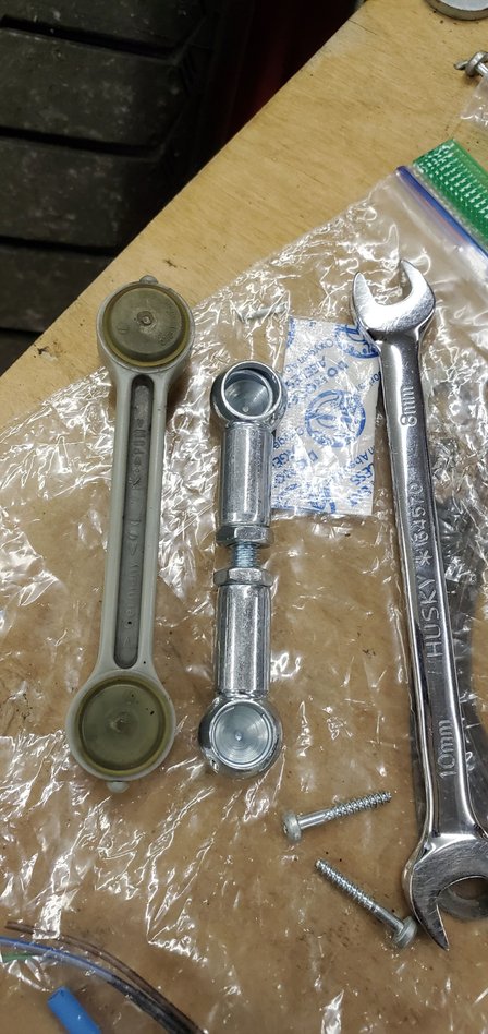

Originally Posted by sam08861
Looking good! Like the color combo of the paint/wheels/interior and the aftermarket bumper looks great, really updates the car and definitely unique.
I see you added lowering links. Did these a few weeks ago and installed the rear ones with the 'elbow' pointing in the wrong direction and had a very highly jacked up rear end for a few confusing minutes and the upper height limits of the airbags being reached, per the nav screen. At least it made it easy to get under there and correct my mistake.
​​​Hi @sam08861 ,
Thank you again for your comments !
One question though, as I am confused by your stating that the rear links had elbows, only my fronts have any bends, whereas my rears are just straight.
Johnny
Old Aug 10, 2021 | 02:22 PM
  #273
sam08861's Avatar
5 Year Member
Joined: Jun 2017
Posts: 526
From: nj
Rep Power: 41
sam08861 has much to be proud ofsam08861 has much to be proud ofsam08861 has much to be proud ofsam08861 has much to be proud ofsam08861 has much to be proud ofsam08861 has much to be proud ofsam08861 has much to be proud ofsam08861 has much to be proud ofsam08861 has much to be proud of
My lowering links for the rear are straight too. (look to be the same as yours, from the red covering material)
The mistake I made was that the plastic lever, that's under tension where the top ball socket of the lowering link attaches to was rotated along it's range of motion, so that the 'knee' where the two join was pointed in the wrong direction.
Ie. the two 'levers' of the arm and the lowering link meet at an angle, and since the car never gets high enough that the angle is straightened out, the 2 arms cannot 'pivot' to the other direction and one end needed to be removed, the lever rotated so the 'knee' is at the opposite side, and reattached so that the correct positions are reported to the control module.
As such, since it was rotated an extra 90? degrees or so towards indicating a lower position, the position sensor thought the car was too low and kept trying to raise the car beyond the limit, in oder to get the plastic arm to the position where it would indicate raised to the right level, based on the lever position.
Hope that makes sense, a bit hard to describe without drawings, but in short, the link was attached like < instead of >, for example, with the point of the less/greater than sign being the junction of the top of the lowering link and the end of the plastic lever with the ball (male end) connection that rotates and reports position.

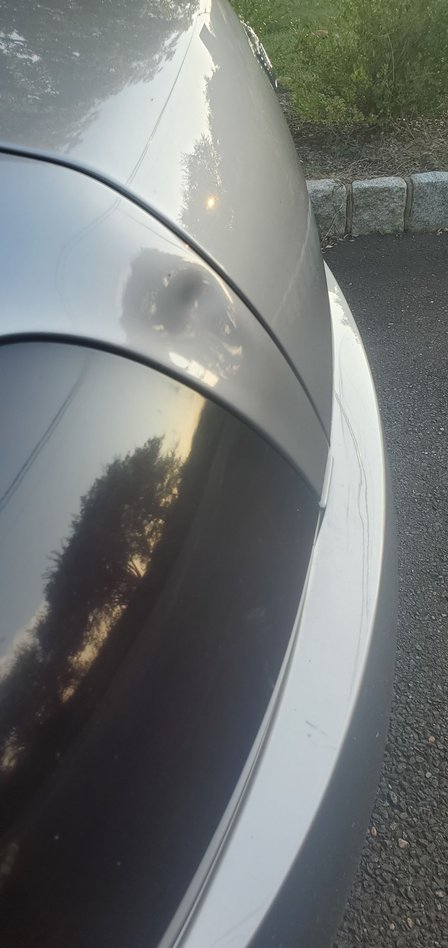

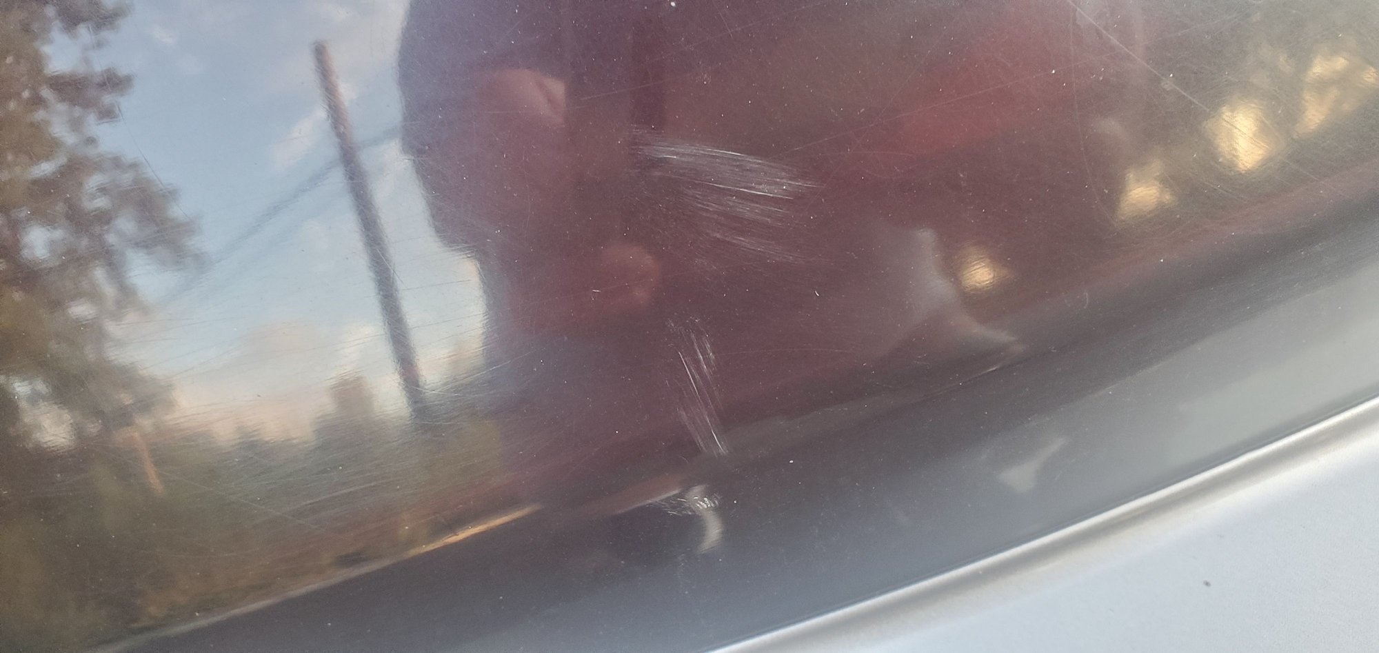

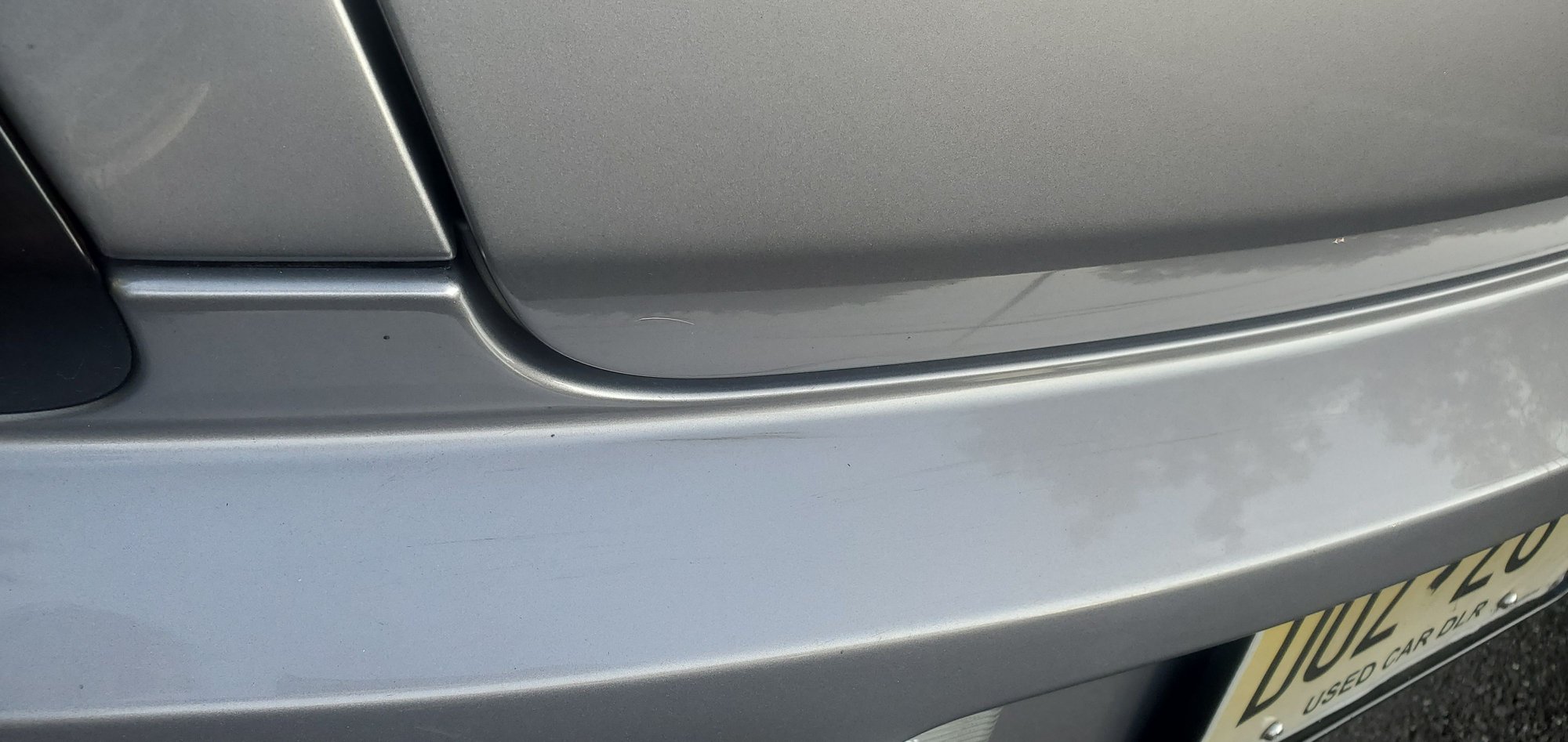

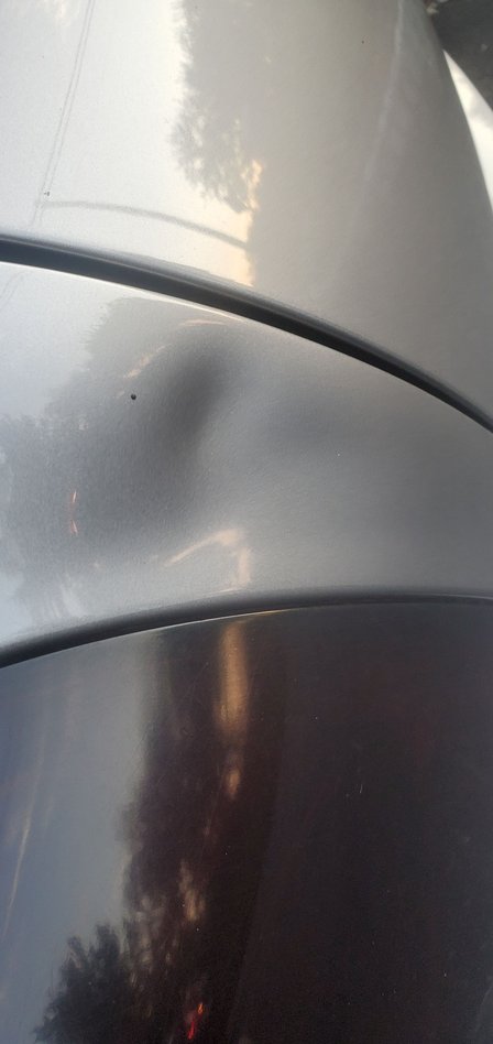

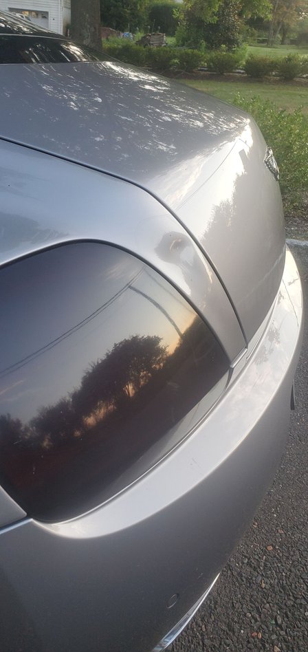

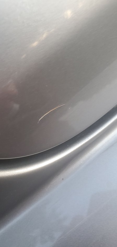

Then this happened...
Not happy 😕
Parked in my driveway, dumb 🦌 deer !
I was walking to my vehicle to look at her backside like I always do, and it was a blankety blank moment, I look around like what the fudge and there are 5 of his/her friends standing at the side of my house, I guess he or she misjudged the jump over the boxwoods and landed on the Bentley...
I am going to bring it to Caruso's Automotive (Tommy) in Plainfield NJ.
I will also have Tommy do the front bumper, rear Supersports spoiler, Supersports hood vents, and cut, weld end caps on, and polish the front bumper lower stainless trim pieces, as the stock trim pieces from the stock bumper are to long for the aftermarket bumper.
Johnny
Before.
After 🦌.
Hoof scratches...

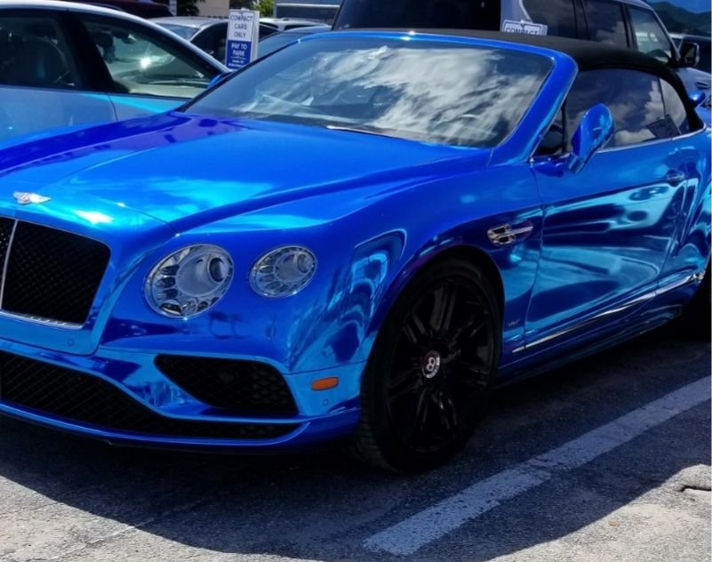

And this is why pictures are so important.
What bugs me is that this 10,000 mileage vehicle is all original paint, with the exception of the front bumper, now it will need blending into the roof and other areas...
Maybe I should just wrap it after body work, 🤔 .
Blue chrome, or Bentley Kingfisher Blue !

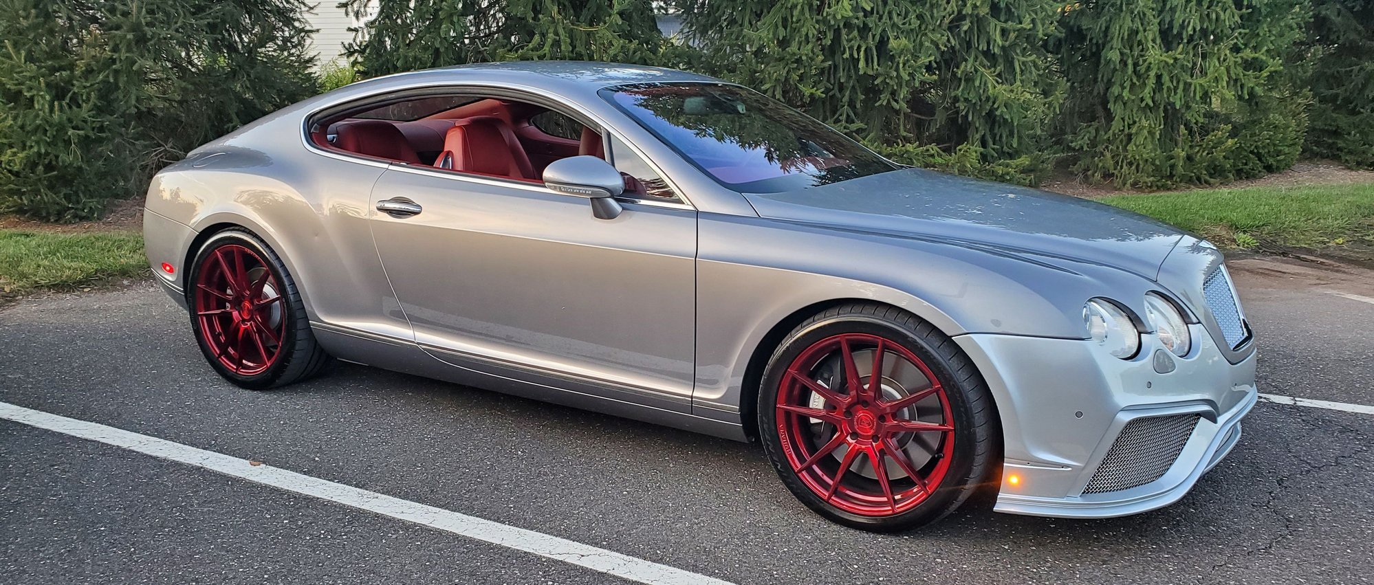

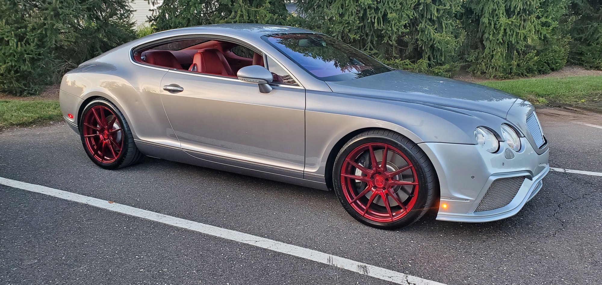

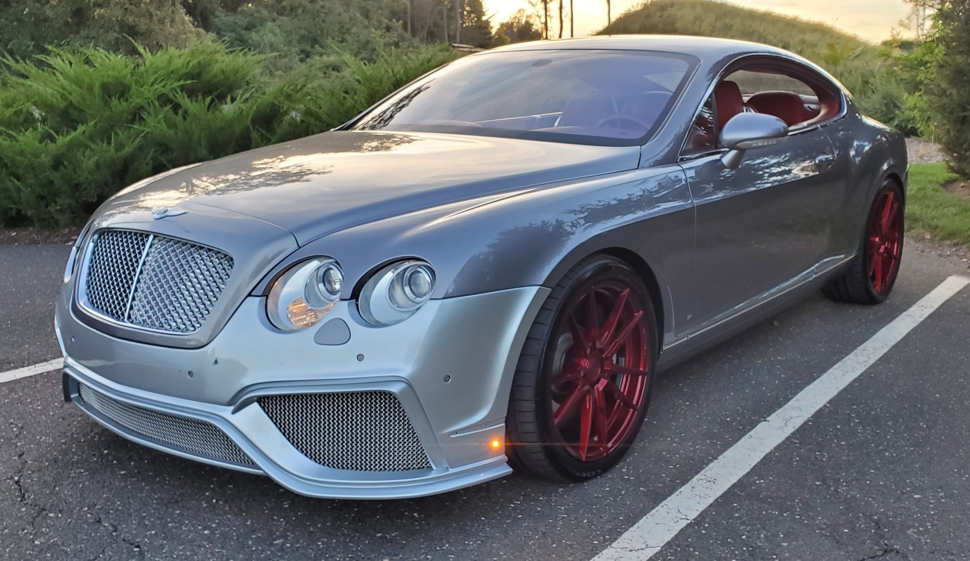

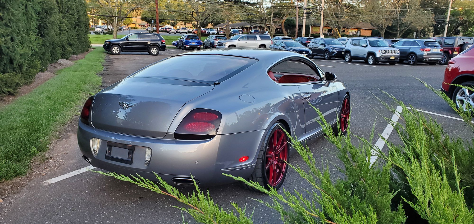

Hello All,
Well, because of all the flooding, I haven't had the Bambi dent fixed, as the repair man has his own flooding problems at home and work, so of course I understood his really not giving a crap about my B, I truly do, and am hesitant to call, gonna give him so time.
So here are some beauty shots, she's a hottie !
I added tiny amber LED's to the front bumper to remain legal.... 🤣
Next I need to shorten the lower stainless steel trim to fit the bottom of the front bumper.

Bravo! Beautiful! What's that little black box at the right lower corner of the rear window?
Old Sep 20, 2021 | 06:55 PM
  #282
Administrator
Joined: Jul 2014
Posts: 3,946
From: Montgomery NJ
Rep Power: 1002
Originally Posted by BWings
That is a dropdead beauty Johnny!
Thank you "B" !!
And thank you for helping on the Bentley forum again, you have been missed !
Johnny
Thank you Bruce !
The little black box is my temporary Sirius satellite radio antenna.
