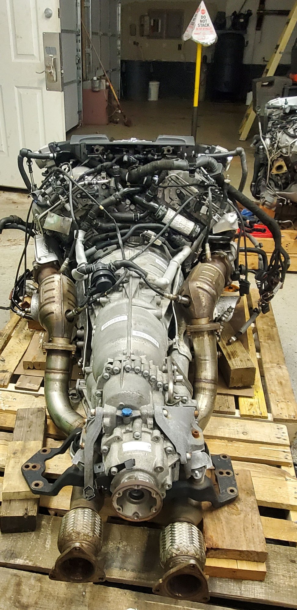

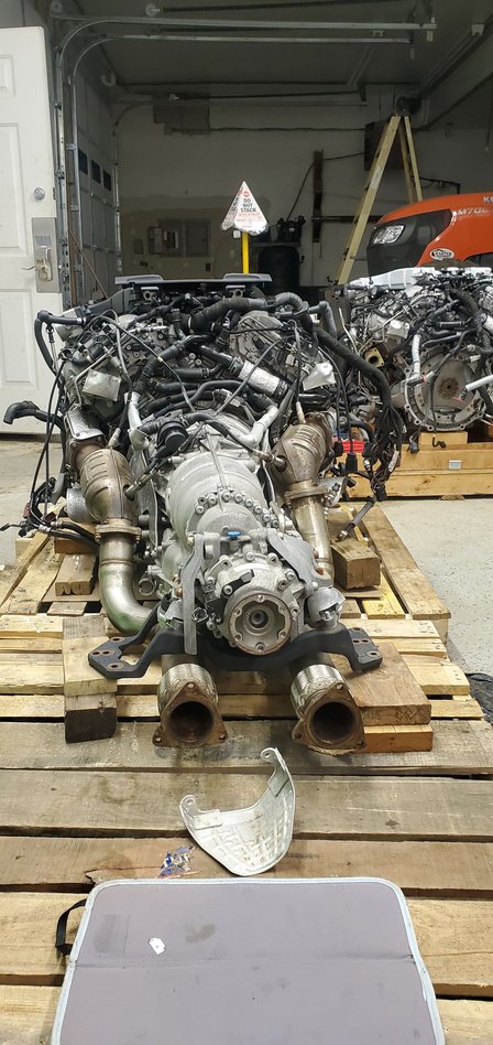

And then this happened....
Really, damn.
So now waiting on some parts,
Anyway, this is what happened next, I will fix as all parts arrive..
Johnny

As far as the exhaust 🤪, that is wide open no pipes at all from the down pipes back as shown in the picture below, I will be installing the full AWE custom made Supersports exhaust system as shown back in post # 116.
If anyone listens to the video on their home theater system, it is loud !
