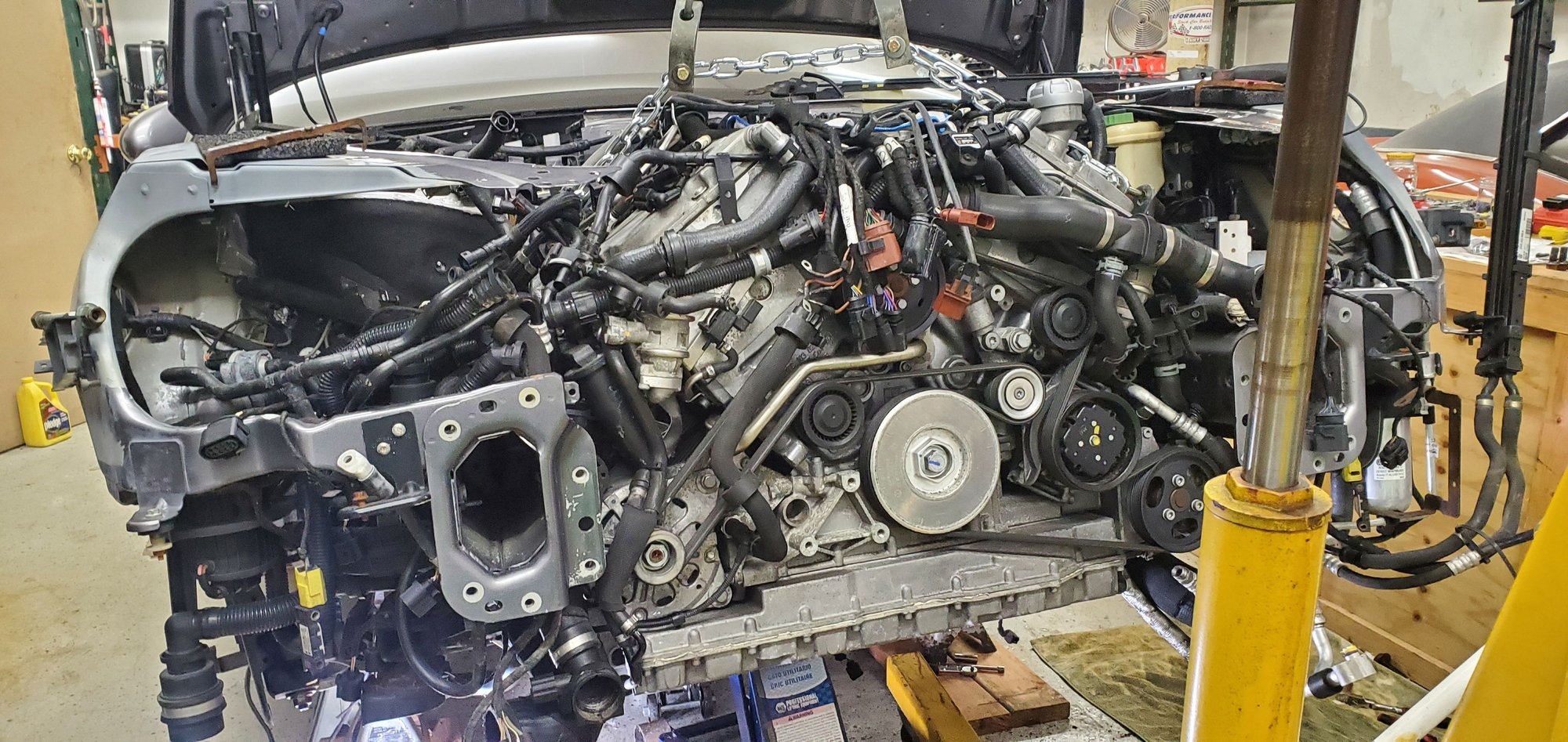

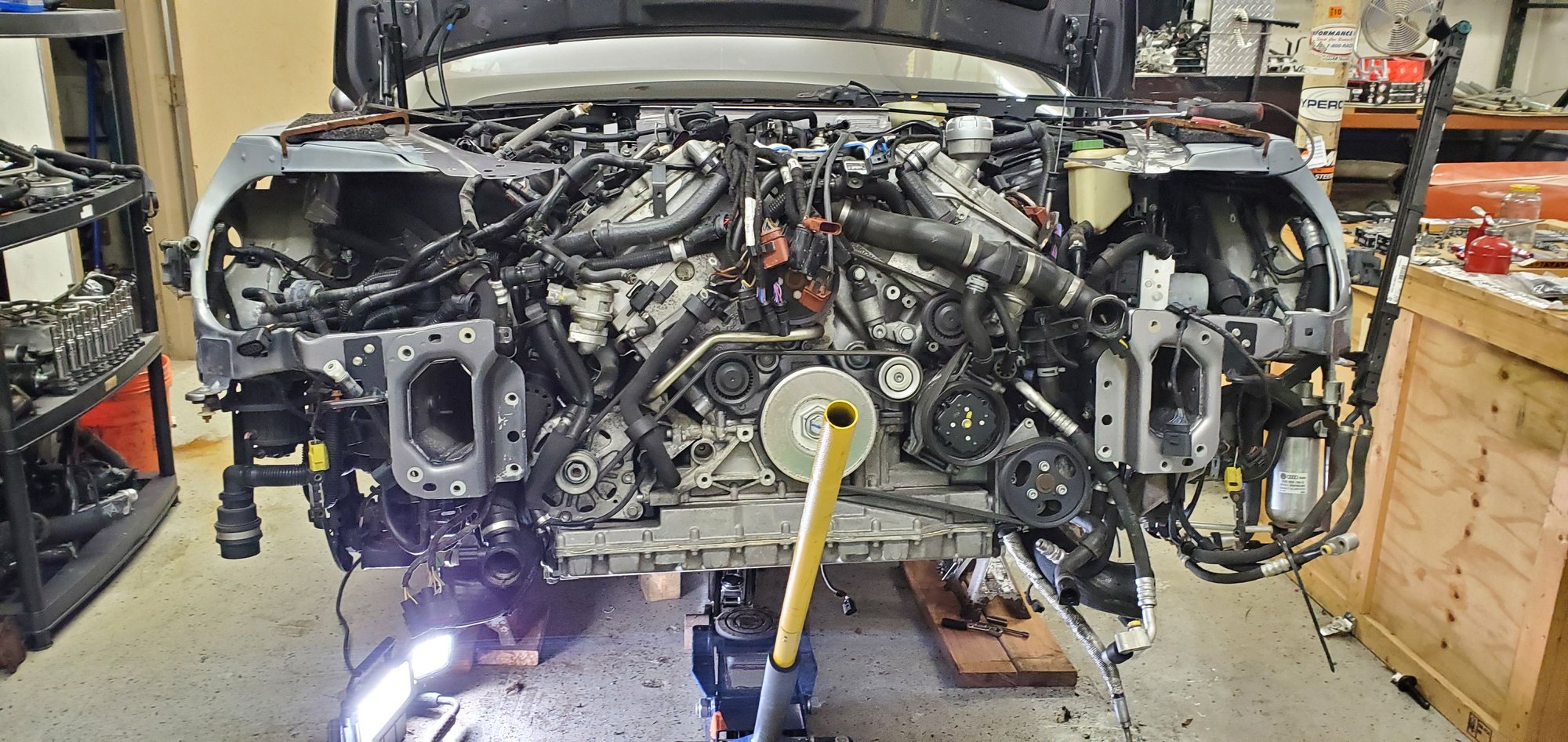

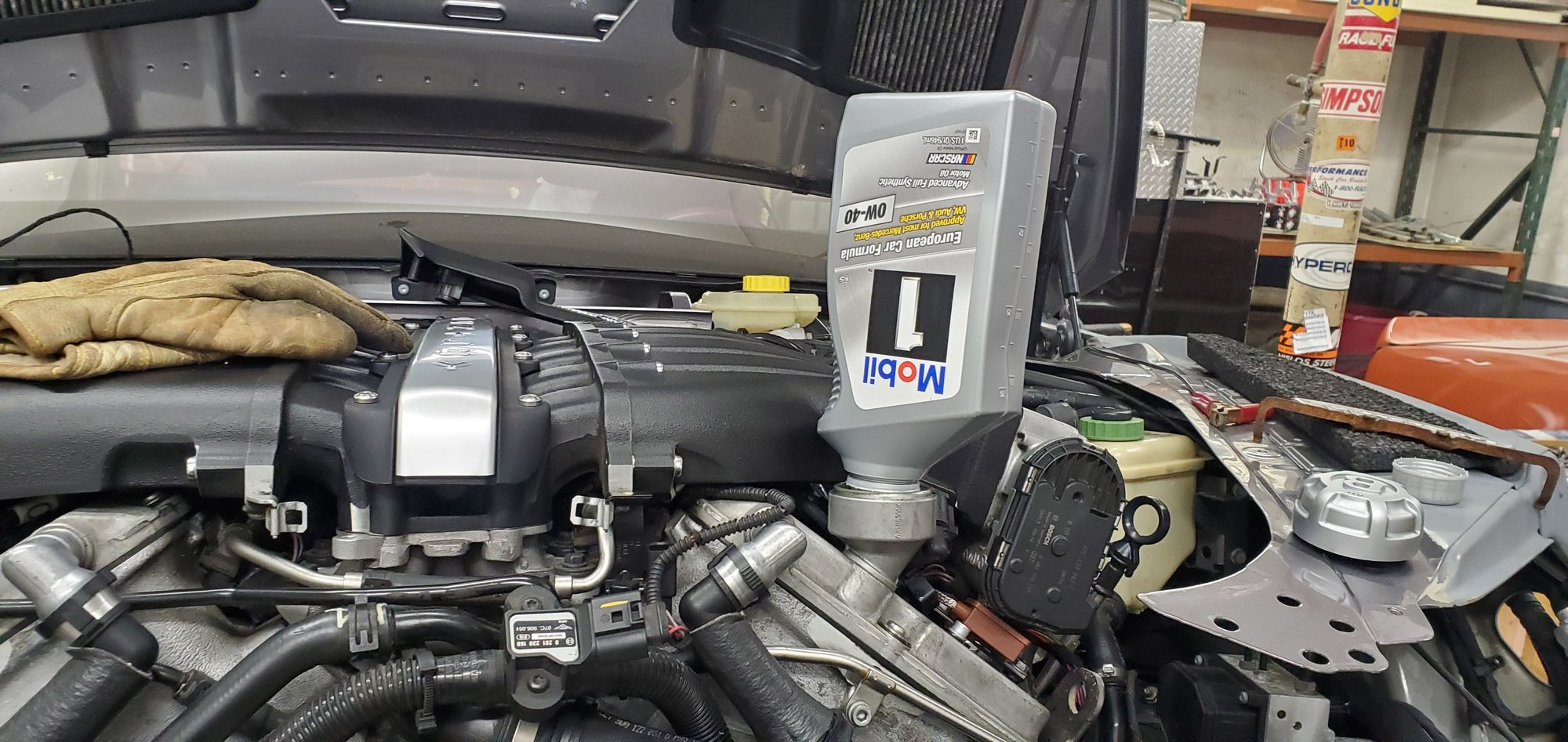

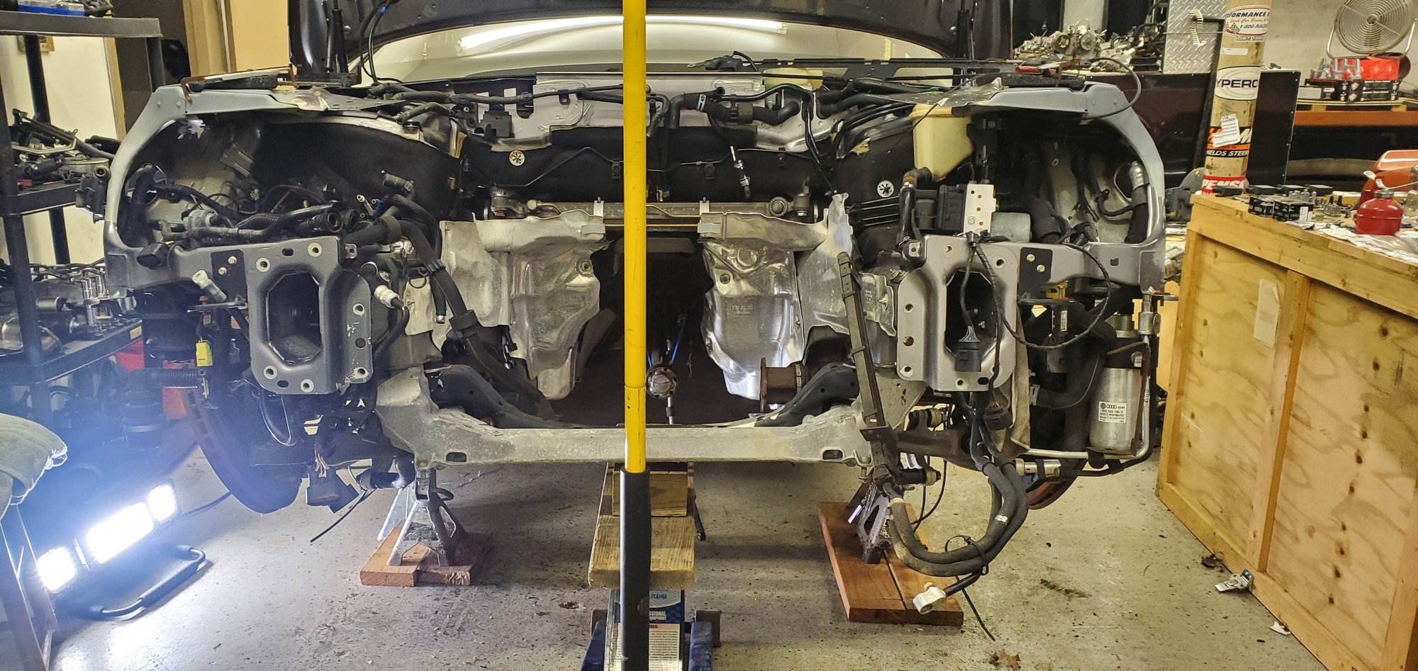

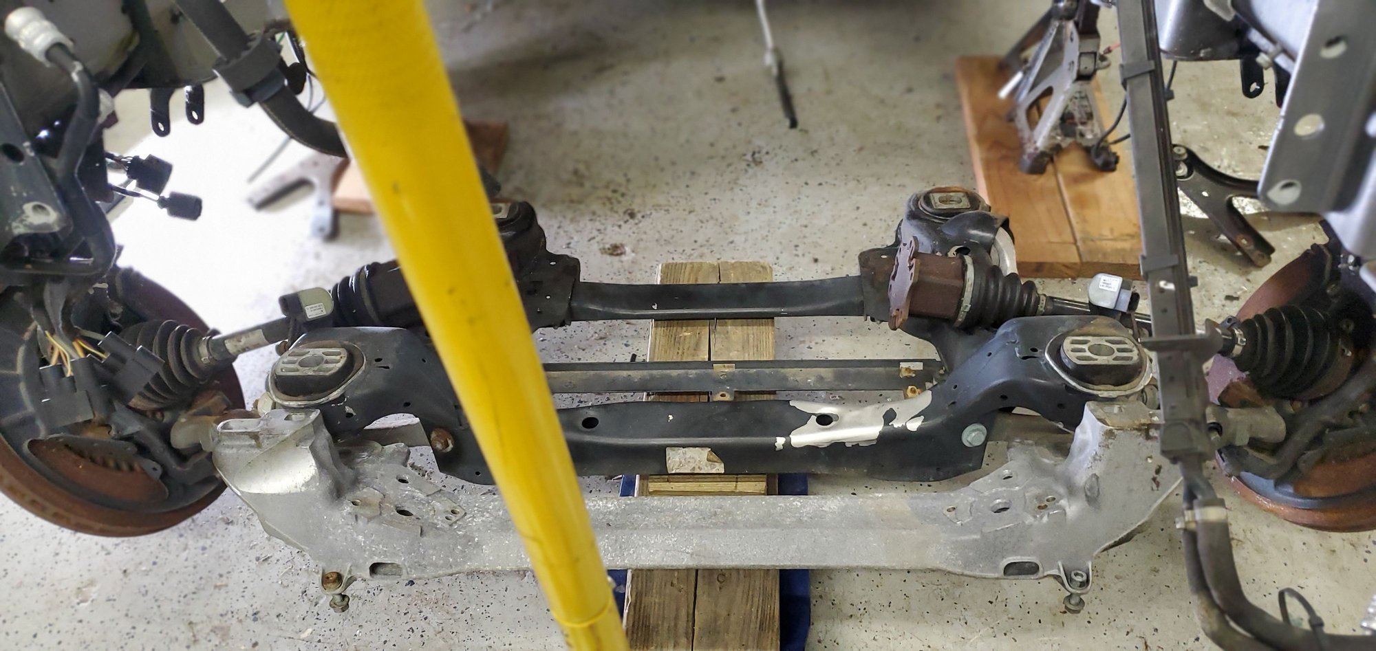

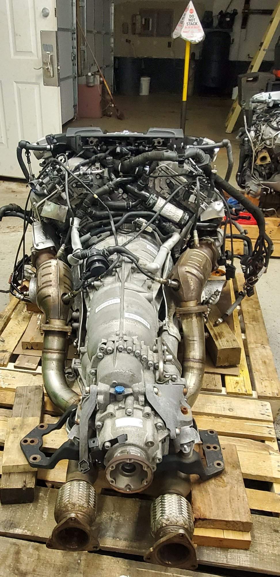

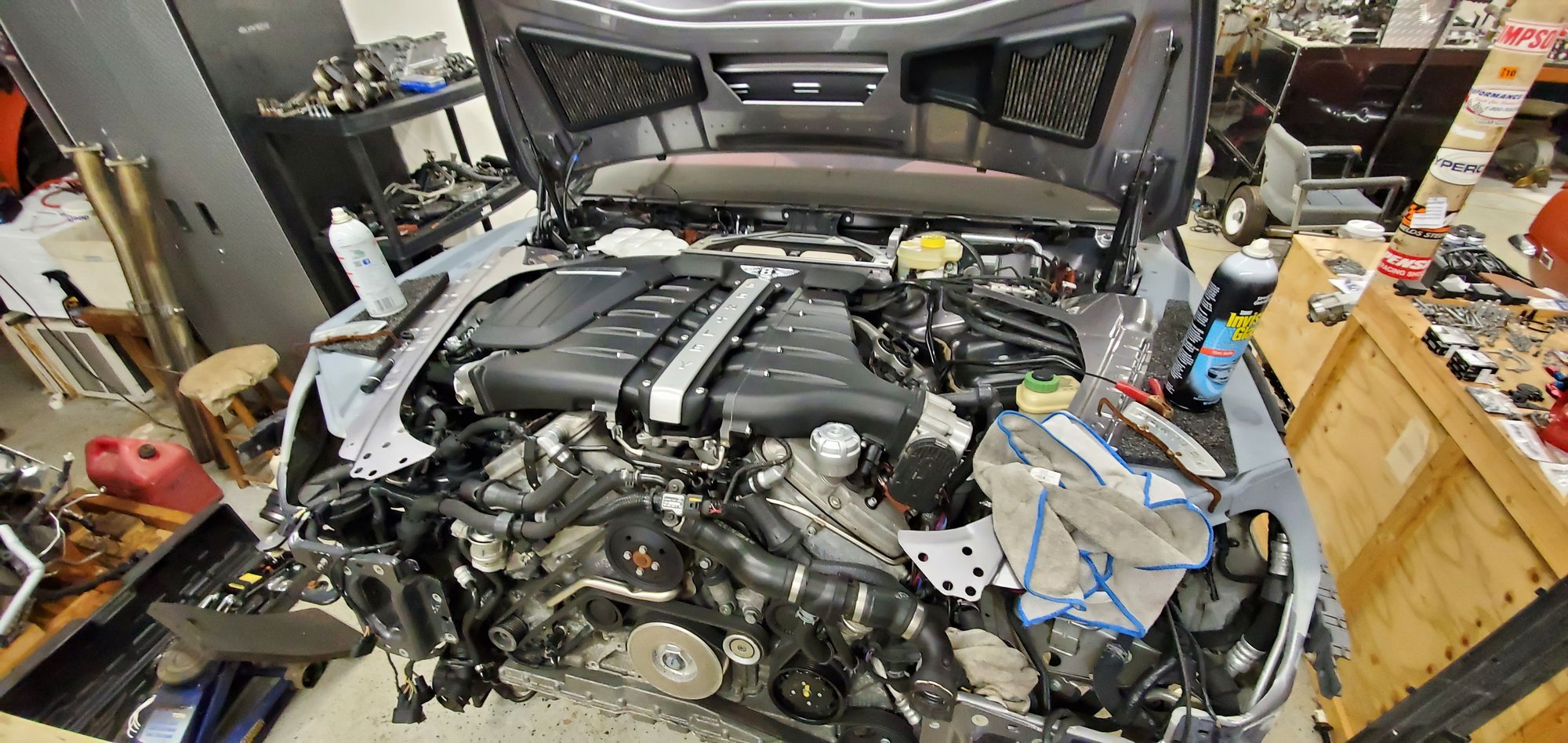

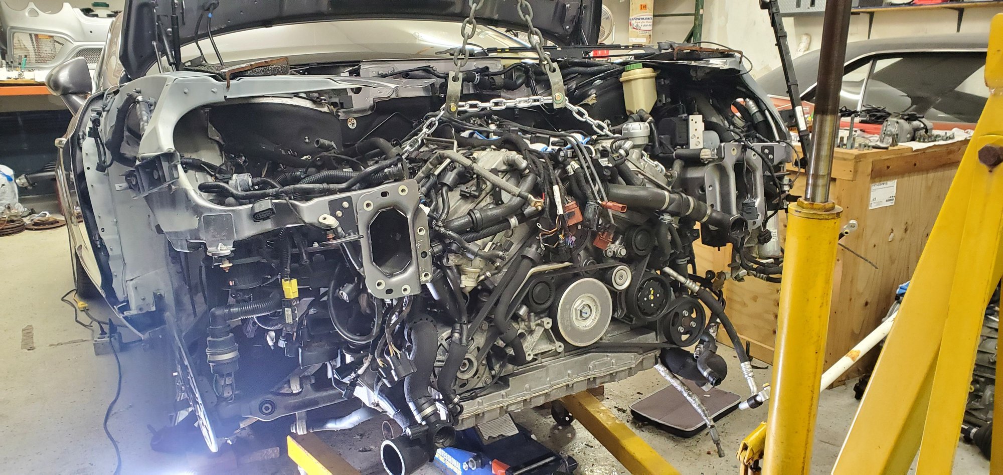

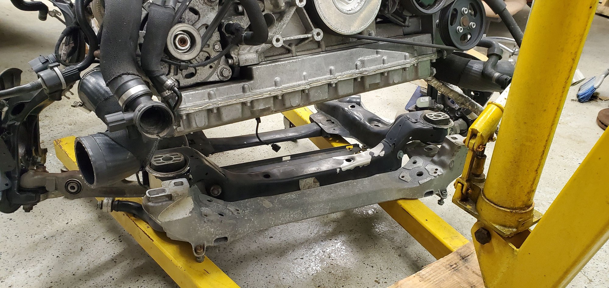

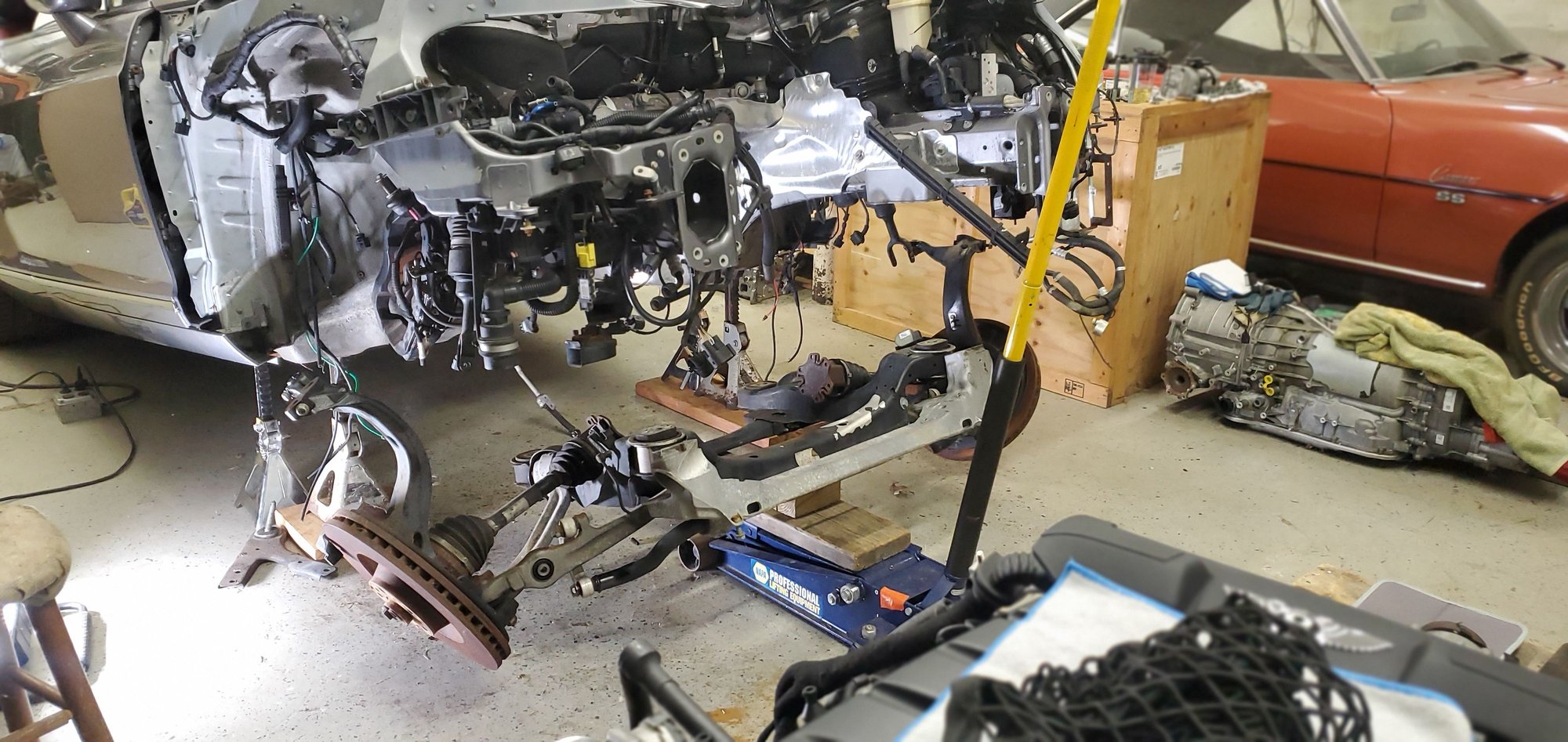

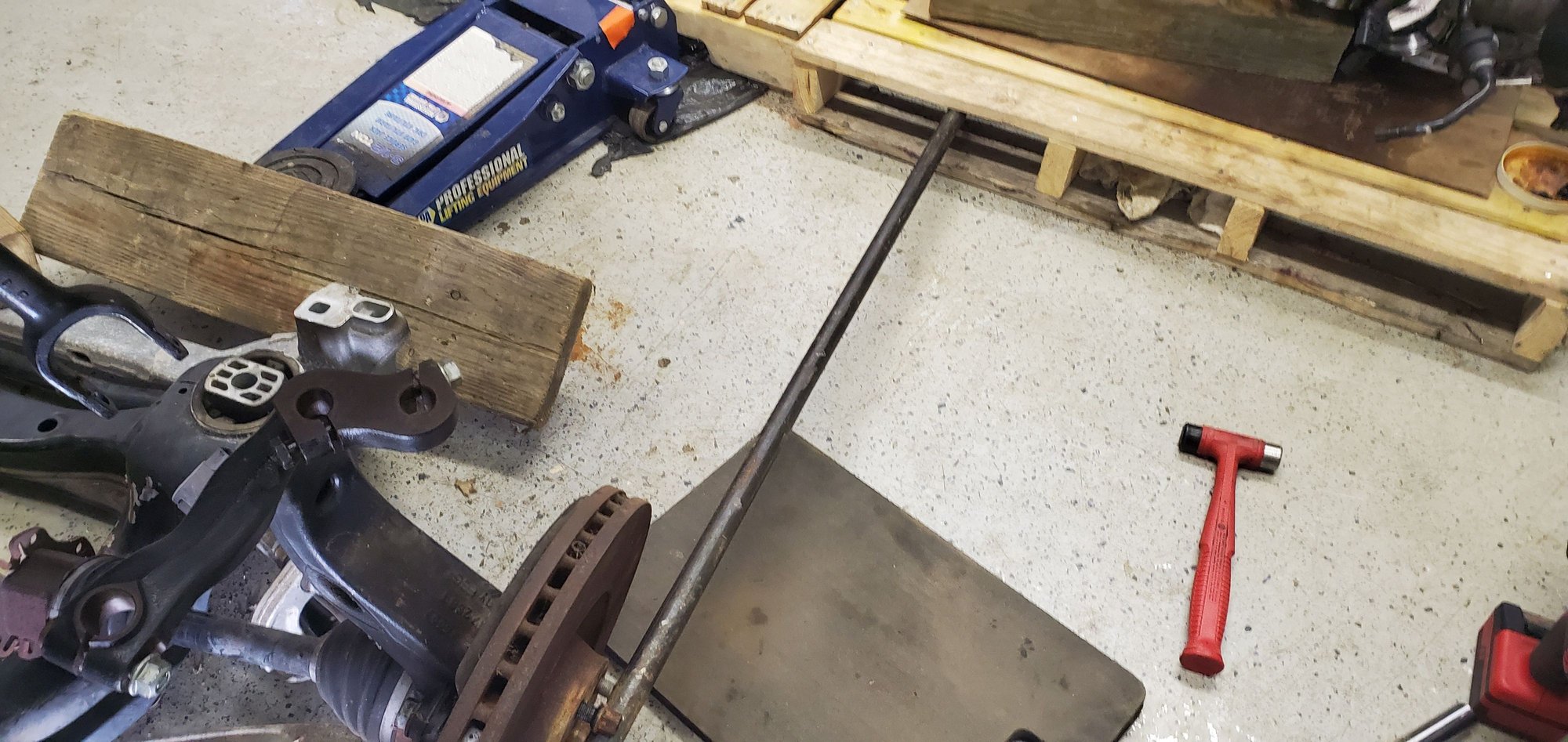

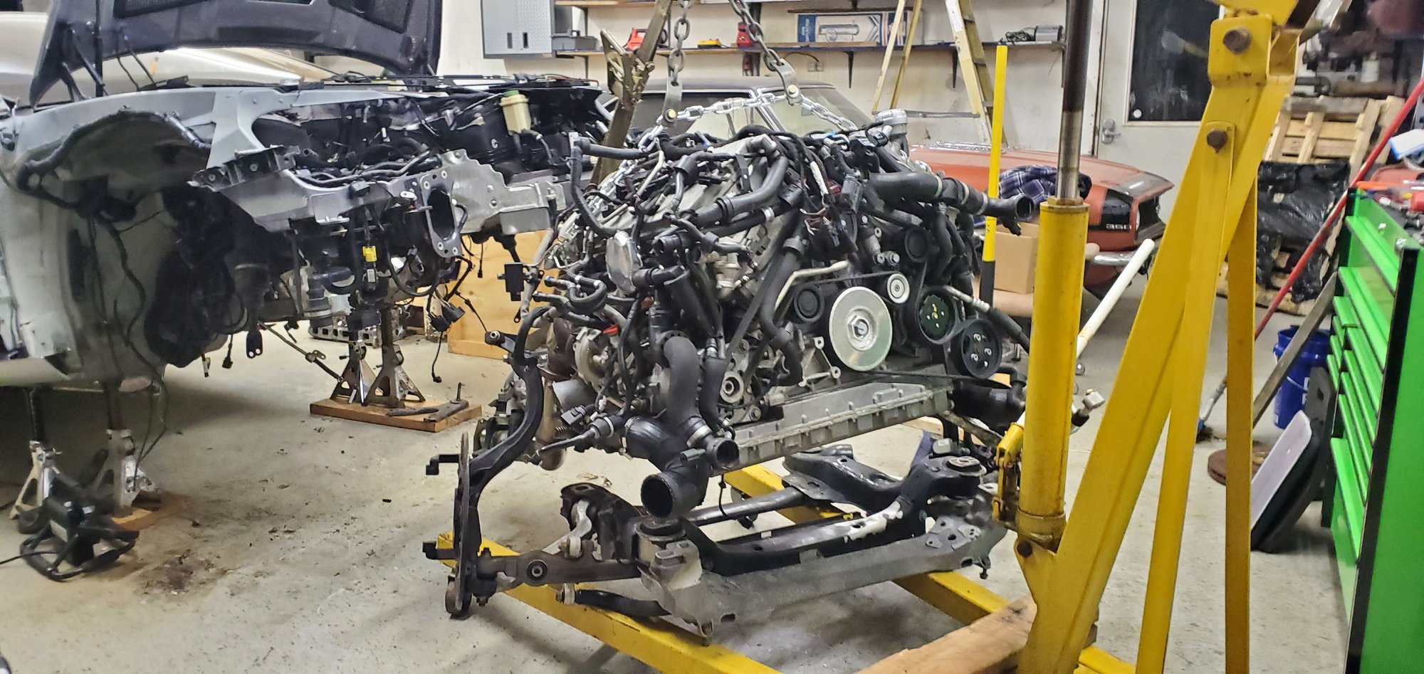

Hello All,
I put some time in this week, I finished assembling the engine trans package, then I dropped the suspension, subframe, and engine cradle, also while I am at it I am changing out both front hub/bearing units eventhough the vehicle only has 10,380 miles on it, the driver side front became loose from the flood I assume and then sitting for 7 years, so I am doing both, why not, also new brake rotors all around.
Tonight I went up at 7PM and started on getting the suspension and cradle mounted to the engine, then inserting the package up into the car, my plan was to have the hub assemblies and all 4 brake rotors with me to install before putting the subframe back into the vehicle, but the seller fouled up and the delivery that was to be here Thursday, Friday the latest, is now not showing up until December 10th....
So, I said screw it and just kept at it, I really wanted to be able to roll her outside and fire it up tomorrow or Sunday, maybe I will just start it in the garage with the windows and doors open to p#*s off the people upstairs 🙃
So after 5 hours and 45 minutes the Supersports engine and transmission is in the vehicle, drive shaft, trans mount, engine mounts, subframe bolts, engine cradle bolts, rear subframe braces, etc. are all in place and tight, what a job, cherry picker, 2 floor jacks, lots of jack stands, and plenty of wood, oh, and a few curse words along the way 😀.
At 12:30AM I dropped a wrench, it was loud, and I heard the lady upstairs, so I thought it was best to call it a night.
Back at it tomorrow, well, today.
Enjoy the pictures.
Johnny

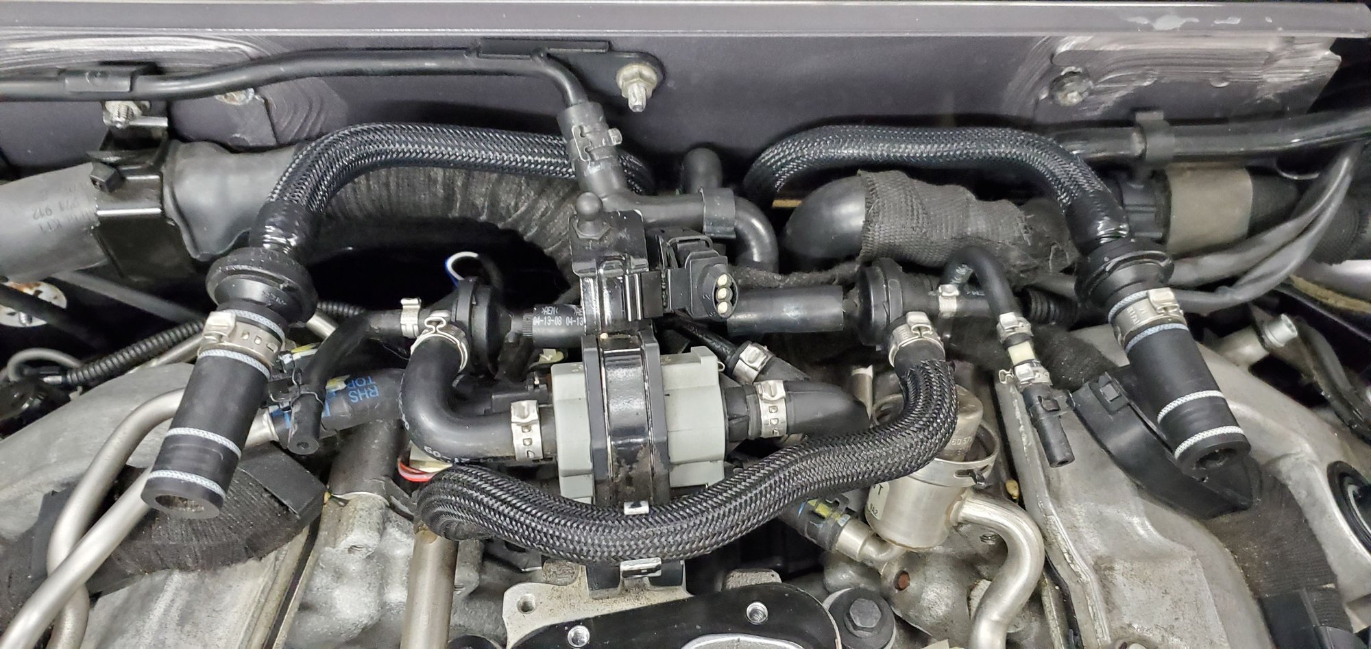

Hello All,
Happy Holidays !
Here are some pictures of my progression, besides the power steering line and the shifter cable as described in my previous post, I had another issue which then lead to another issue...
So, I will fill you all in on that in the next few post with pictures in order.

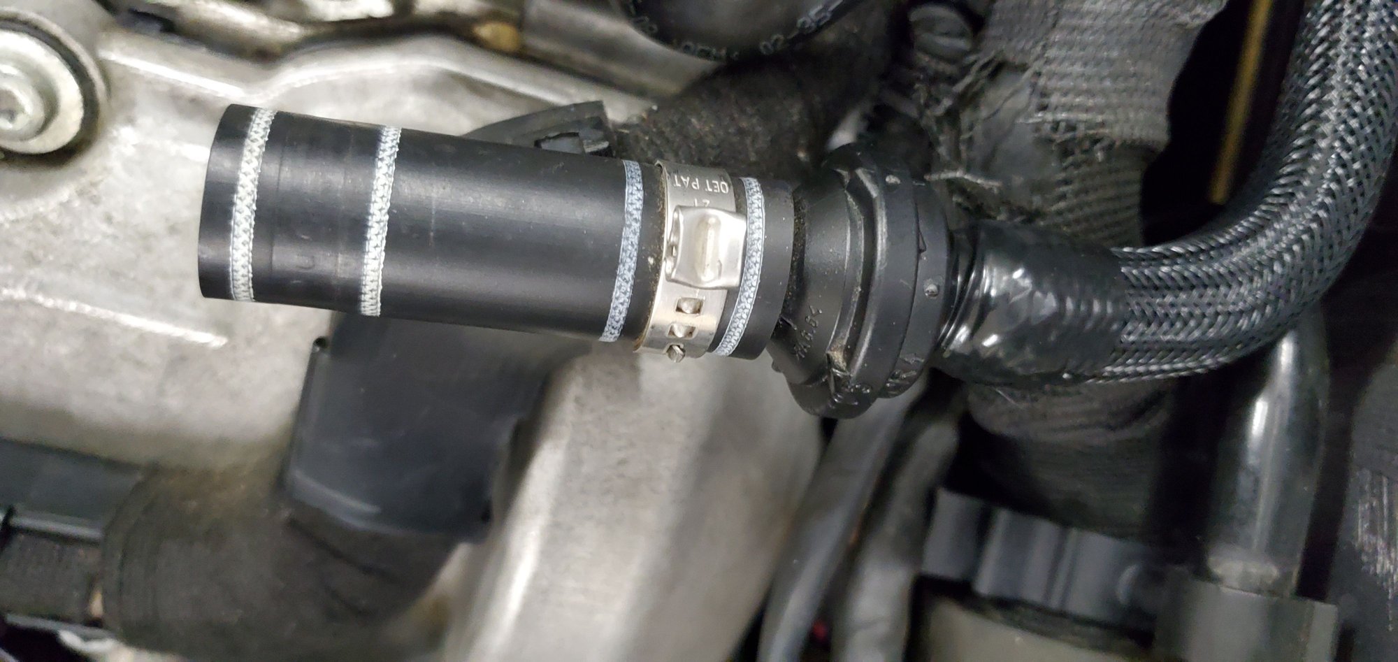

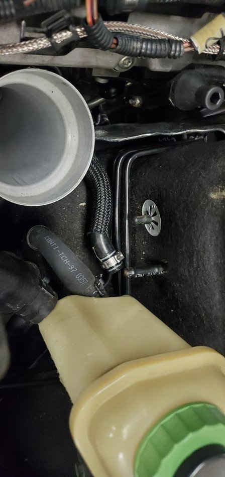

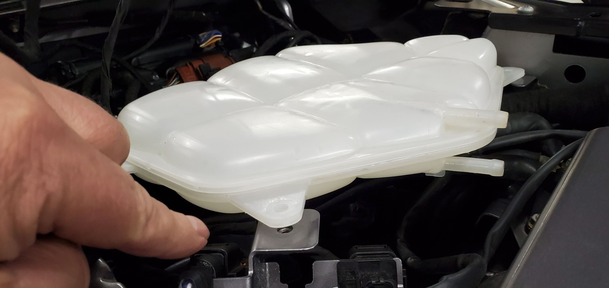

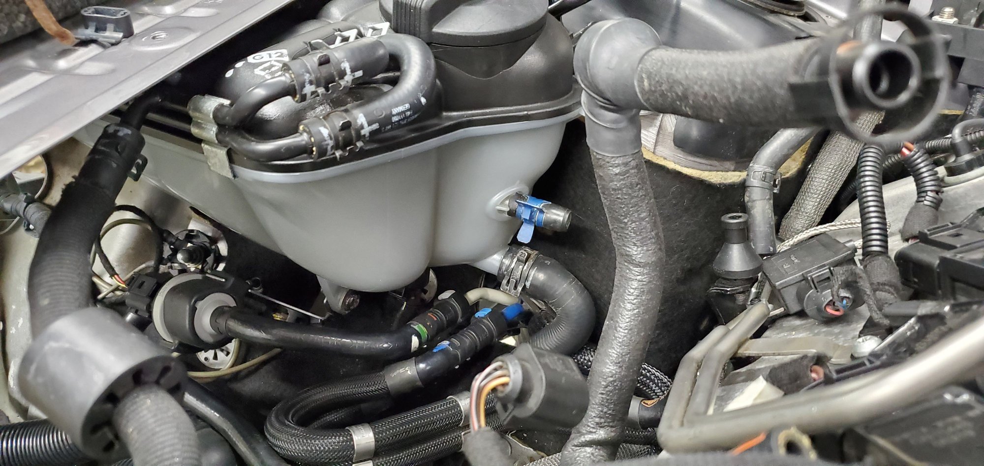

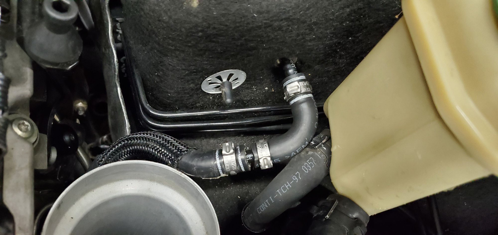

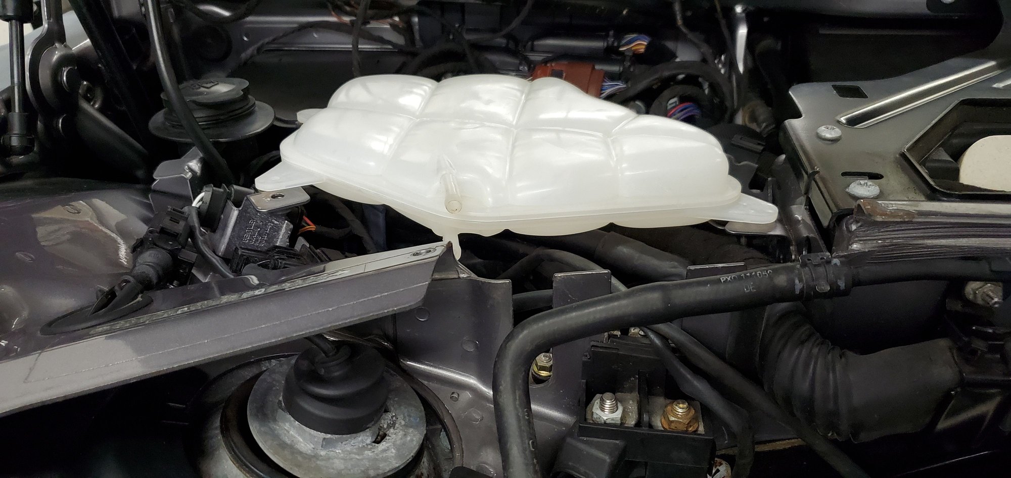

I also had some friendly mud wasps make a home in the coolant lines that go to and from the coolant reservoir and the coolant expansion tank, soaked them for two days to loosen up and push out.

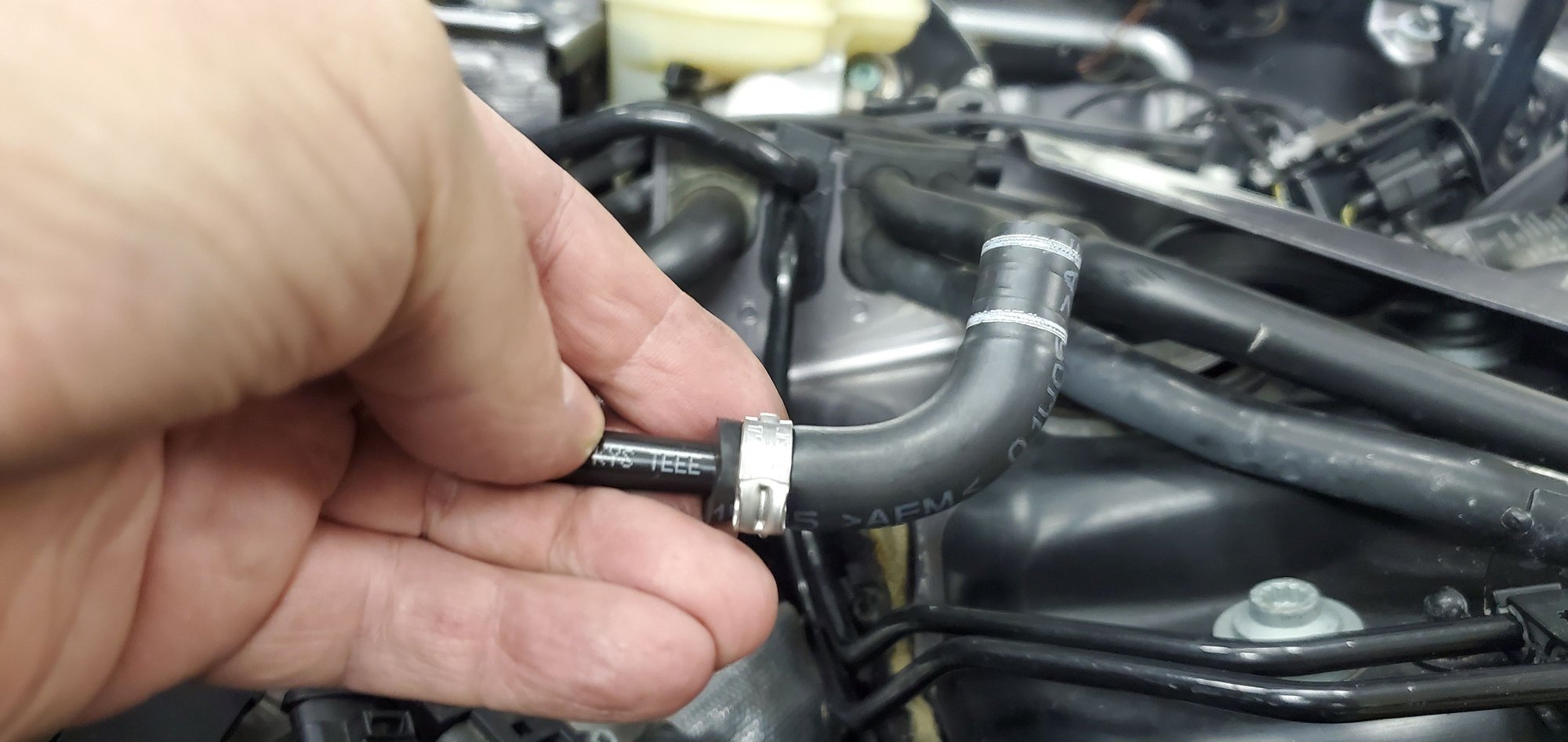

Also had a vacuum line from the DS turbo that was just a bit short, but as the engine was already in place, I added the 90° molded line to fit, pictured below, came out nicely.
Johnny

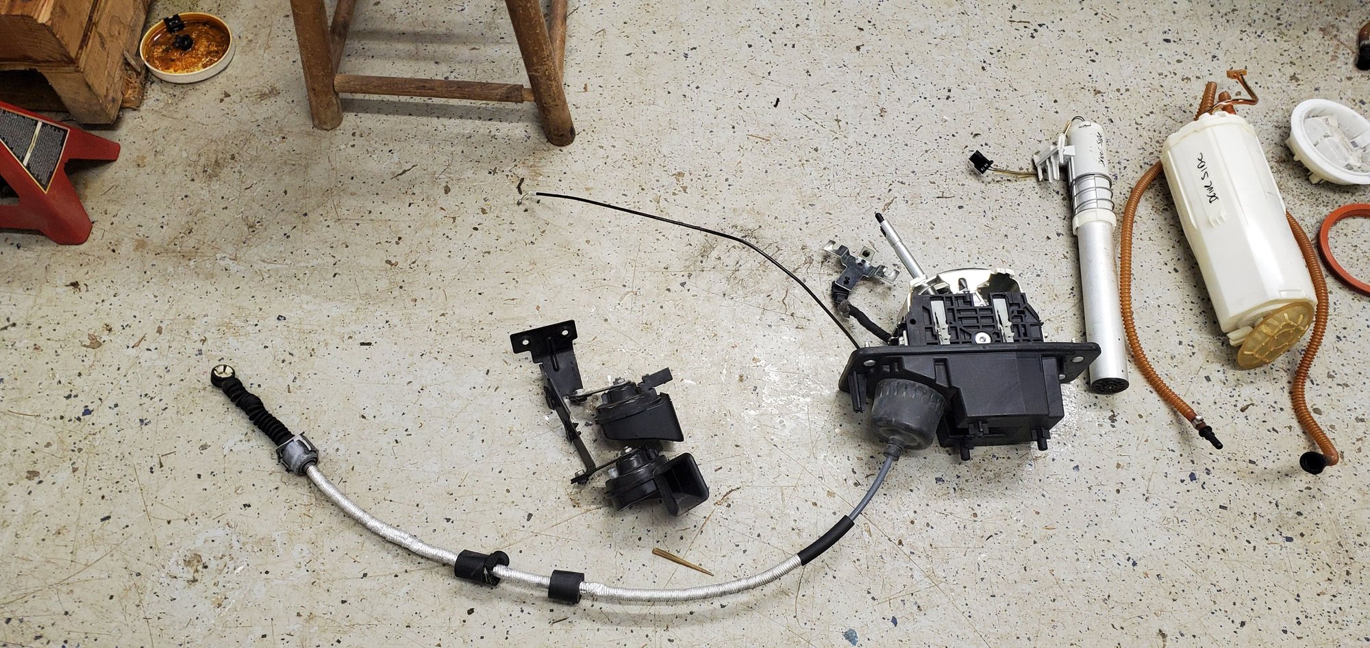

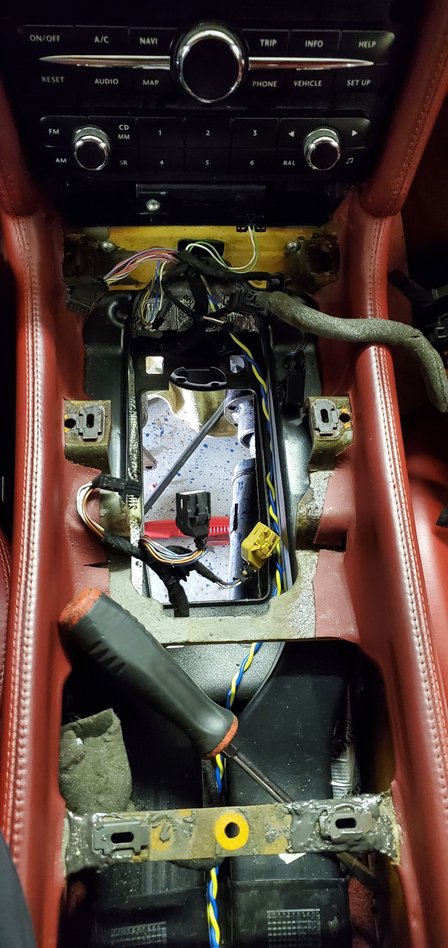

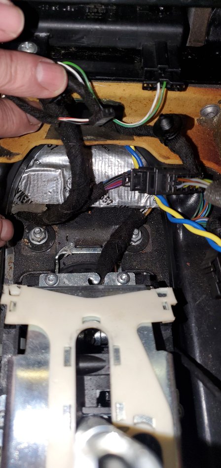

Some pictures of the shifter unit and cable.
Johnny

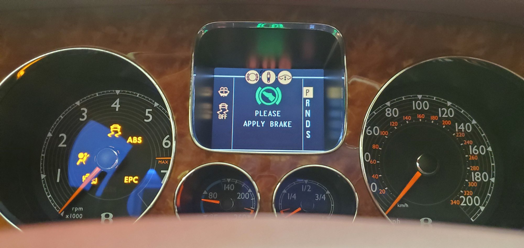

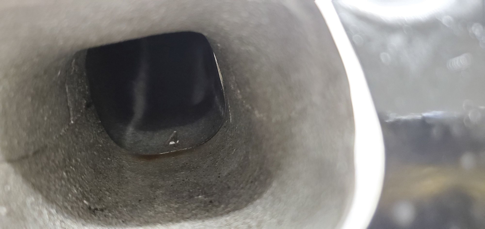

So, if you caught the fuel pumps in the last picture, that leads to the next issue, I had added all the oil and wanted to fire her over just to check things before going further into the completion, and I noticed that after I reinstalled the fuel pump relays that I had no fuel, as in no priming of the fuel system when unlocking and opening the drivers door, I spent hours checking fuses, relays, wiring harness, etc. and I am very very cautious when it comes to fuel and electric together, I finally pulled two pieces of trunk carpet out to access the fuel pumps and their connections on top, I had power right to the pumps connector sockets, so I laid the two 2006 fuel pumps in the trunk and plugged them in, and they ran as they should, so I pulled both locking rings off to access the pumps, but more to look inside to see if any water ever made it into the tank, the tank was clean as a whistle, and for 8 year old fuel, it smelled great, so that lead me back to the connections at the white plastic pieces that hold the connections for pump power and the floats for fuel gauge, and being that the fuel gauge showed below empty, and the floats moved freely in the tank, something was wrong at the connection point, on both sides no less, so I unplugged the white disc from both sides and bench tested each for power flow, the power did not make it from any of the pins to the other side, so I swapped both out and reassembled the top of the tank, grabbed the driver side door handle and the fuel system primed.
But it ain't over...
Johnny
