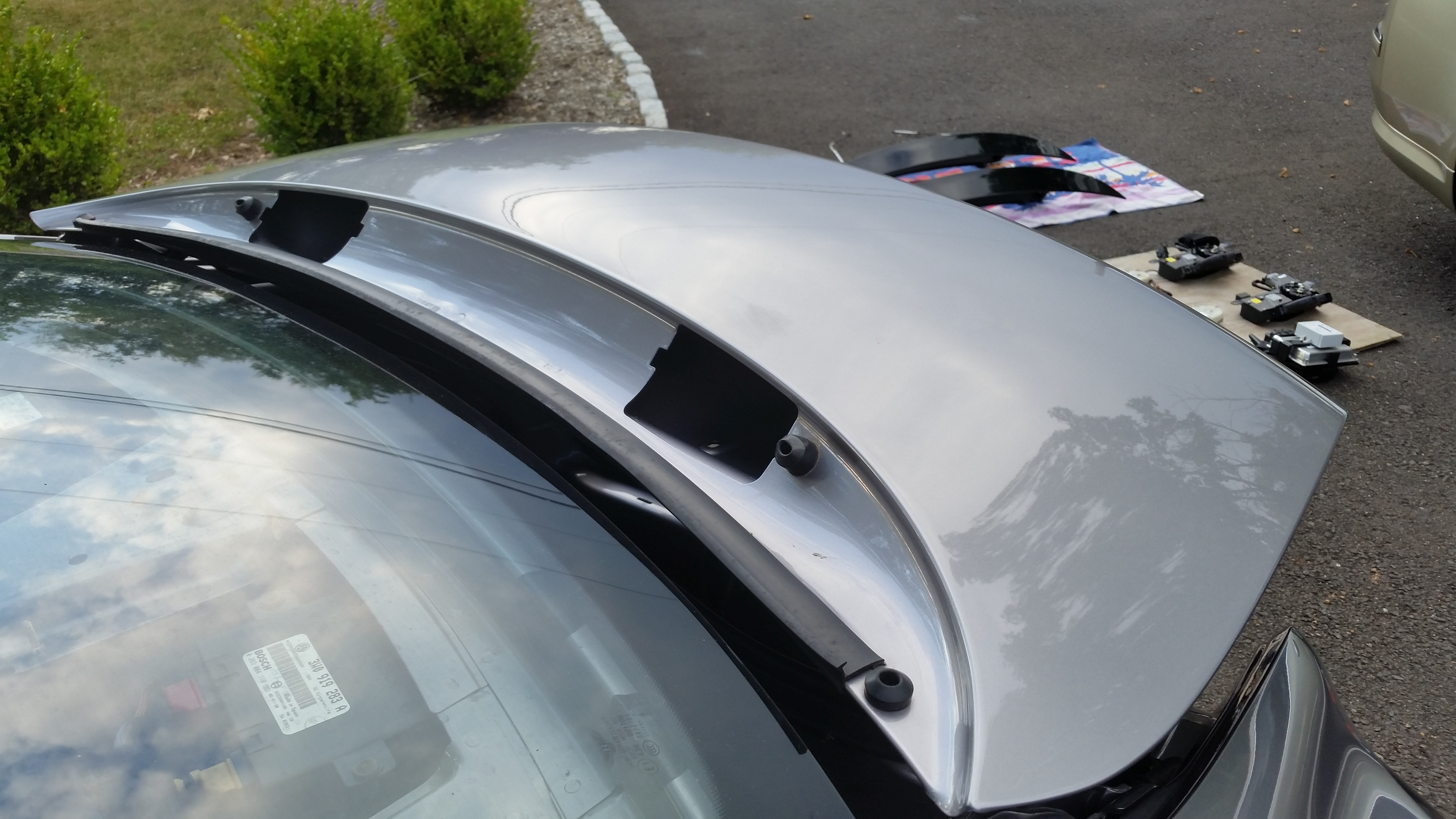

It could well be the drains below the aerofoil that are blocked, or, the boot lid drains.
If you are taking it to Ivor I'm sure he will sort it for you.
These cars do seem to also drop some water into the boot when they are opened after rain.

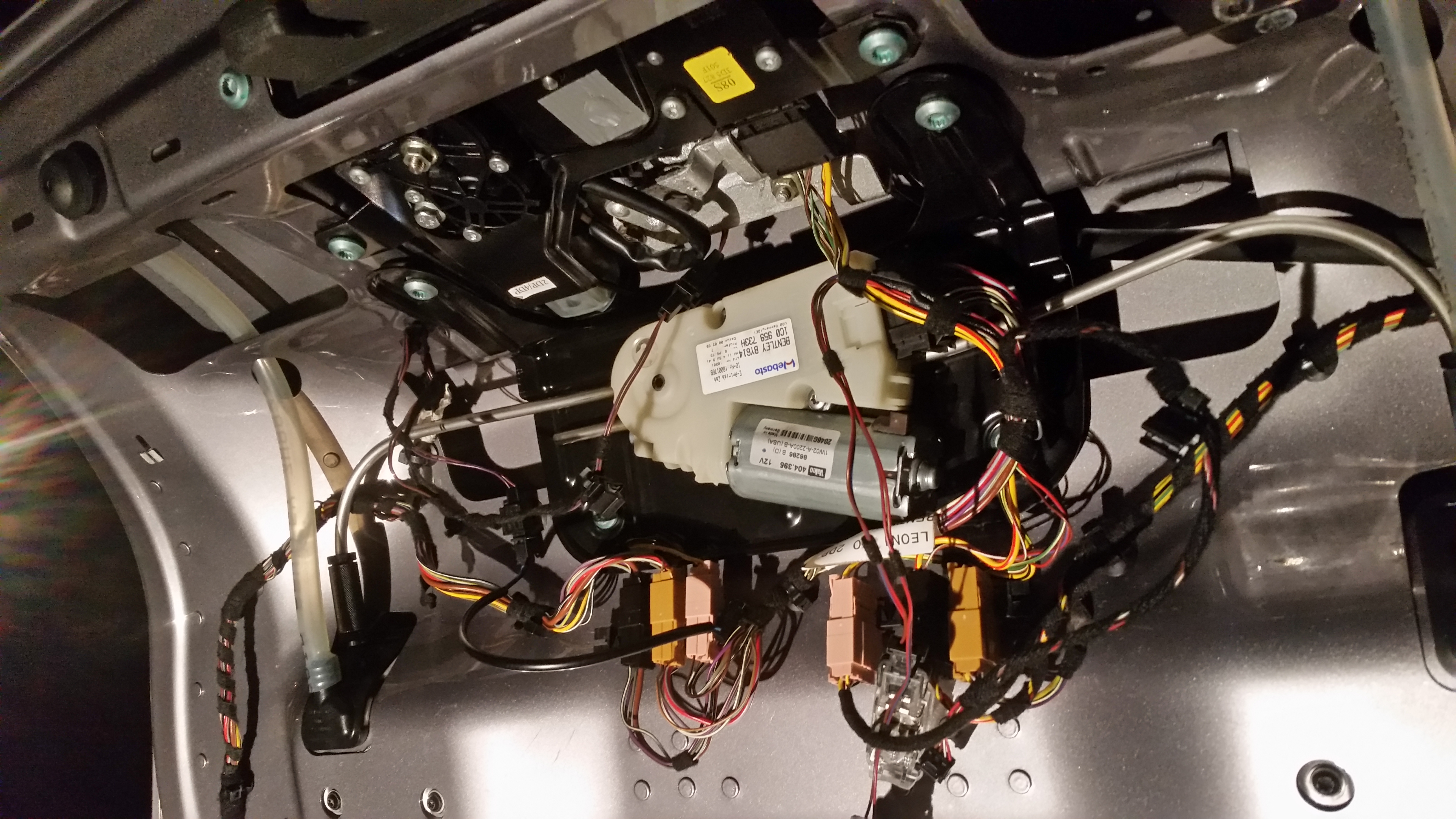

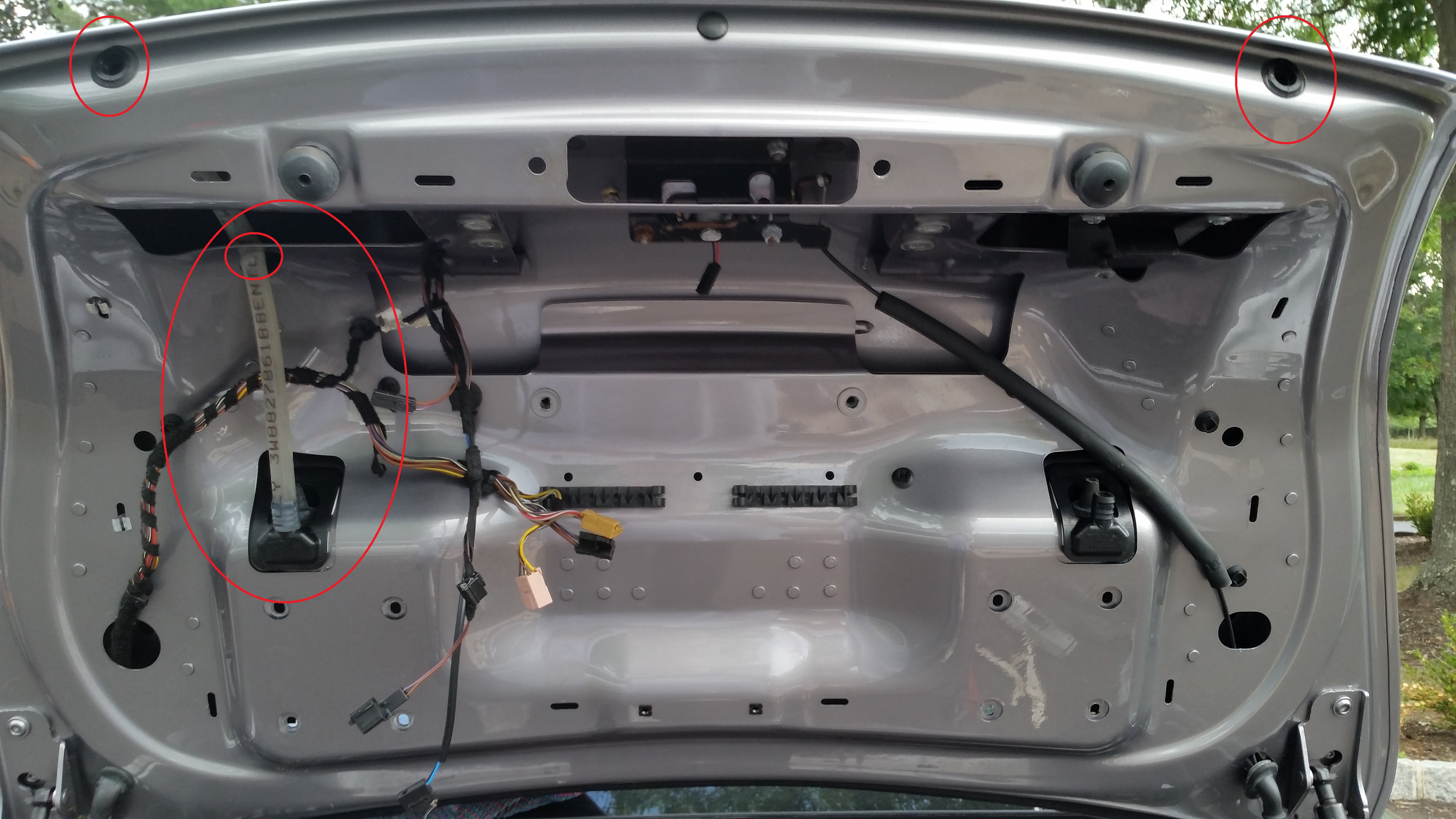

Aerofoil Drains
Hello Mike,

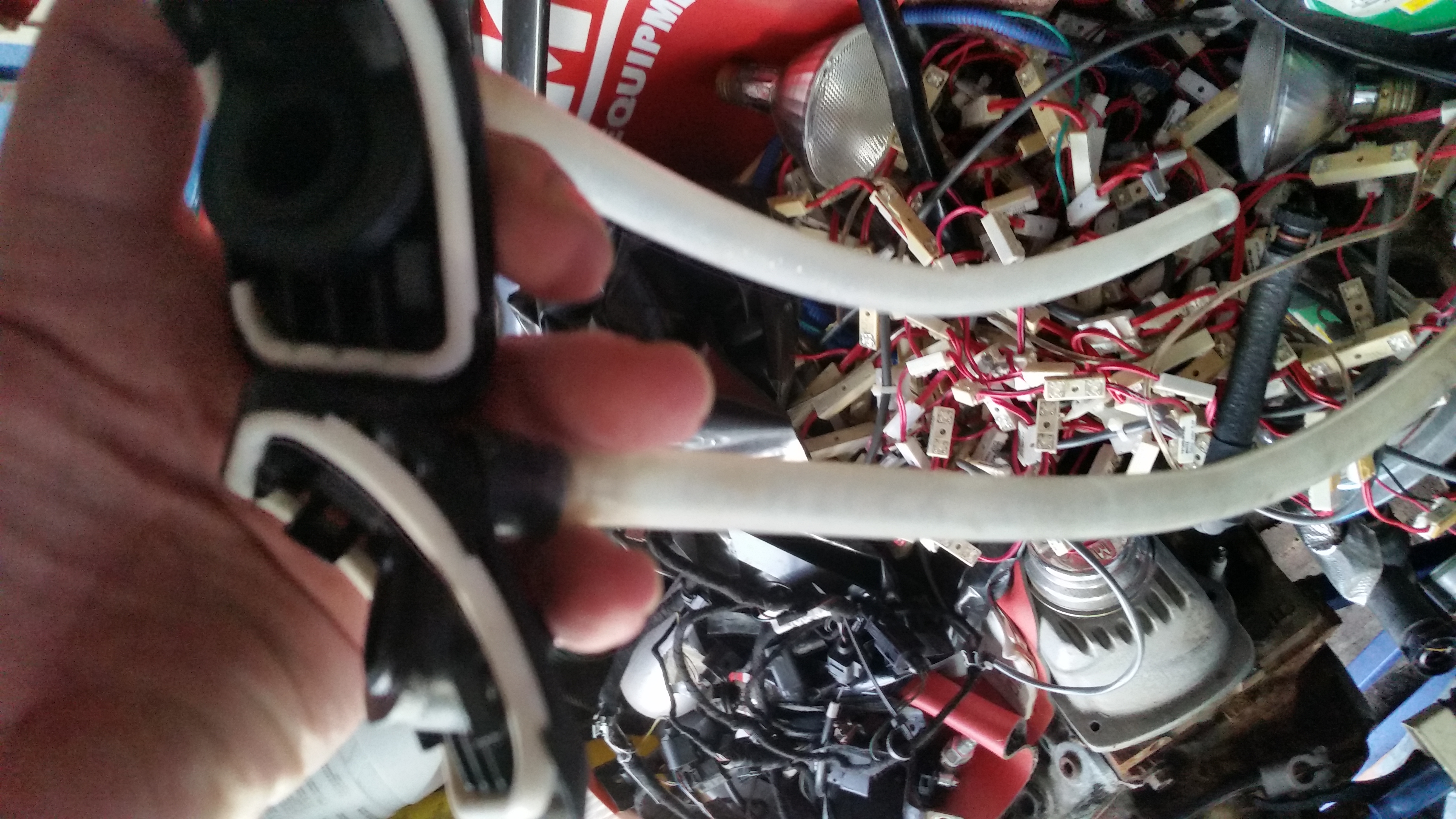

As previously stated, check the aerofoil drains at the base of the boot lid shown in small red circles, BUT also check the drain lines themselves, as can be seen in one of my pictures the line is kinked, the lines in the 05 were flimsy, were as the 07 were more ridged.
Johnny J J
Johnny J J

thanks for the photos johnny it looked so easy so I decided to take a look. pulled out the plastic and the carpet panels. check both pipes, and one of them happened to be disconnected on 1 end, it was quite easy to get in there so iv reattached it by myself which will hopefully fix the leak.
Putting the carpet panel back on was another job. some of the plugs seemed to have already been broken by previous owners. the 2 front main ones was full of glue and have just broken straight back off again so will need re-gluing. of the remaining plugs only 3 was left and after several attempts i just couldnt get it back on so decided to leave it for my indy.
this left the 2 lights floating around the back so I decided to tape them up to the back of the boot lid. as soon as metal touched metal it sparked and now the lights are out too. wooops. my indy is going to have a right laugh when I take it down to him.
all in all its some new glue on the brackets and probably a new fuse which is cheaper than a boot/aerofoil motor or air suspension pump that could have gone wrong whilst being water logged.
