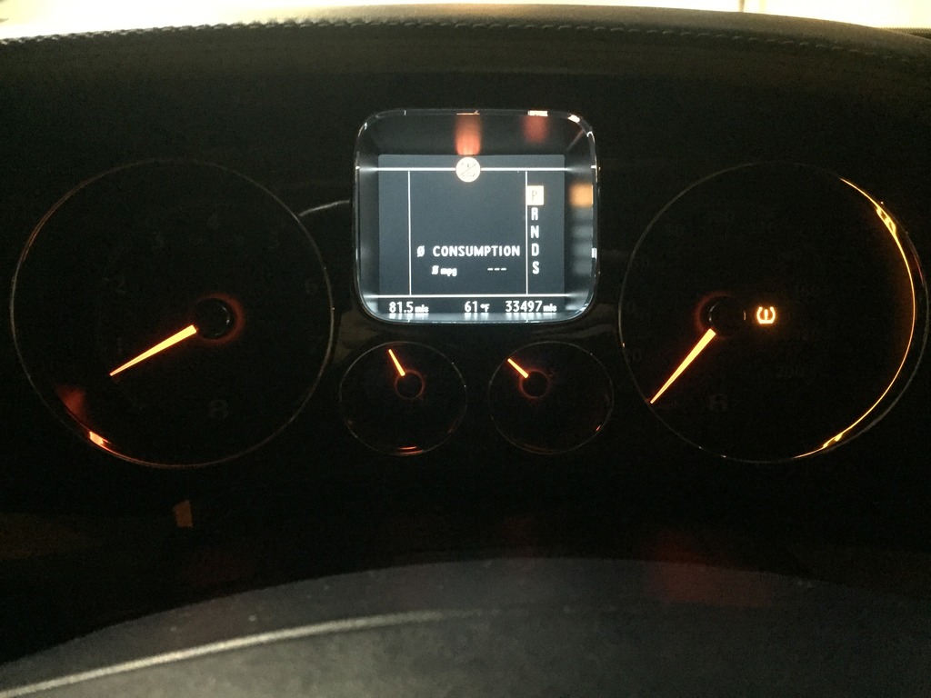

i have an 06 continental GT and my speedometer lights went out? the needles light up at night but the clusters back lights dont (temp, gas, speed, RPM). i have to estimate my speed when im driving at night sine no number show up. the display screen works fine. has this happened to anyone on here before? i check the fuses and they all seem fine. im thinking it might be a bulb that went out in the cluster?? if so it seems like its going to be a pain to fix?
any useful feedback is greatly appreciated
thanks, Alex

Old Jan 12, 2016 | 07:11 AM
Hawk375's Avatar
Joined: Jul 2009
Posts: 40
From: Tampa, Florida
Hawk375 is a name known to allHawk375 is a name known to allHawk375 is a name known to allHawk375 is a name known to allHawk375 is a name known to allHawk375 is a name known to all
Seems to be a pretty common failure with the instrument cluster, there's a number of places that provide repair service for the cluster itself. You could also have it replaced, but it'll have to be re-coded to the car.

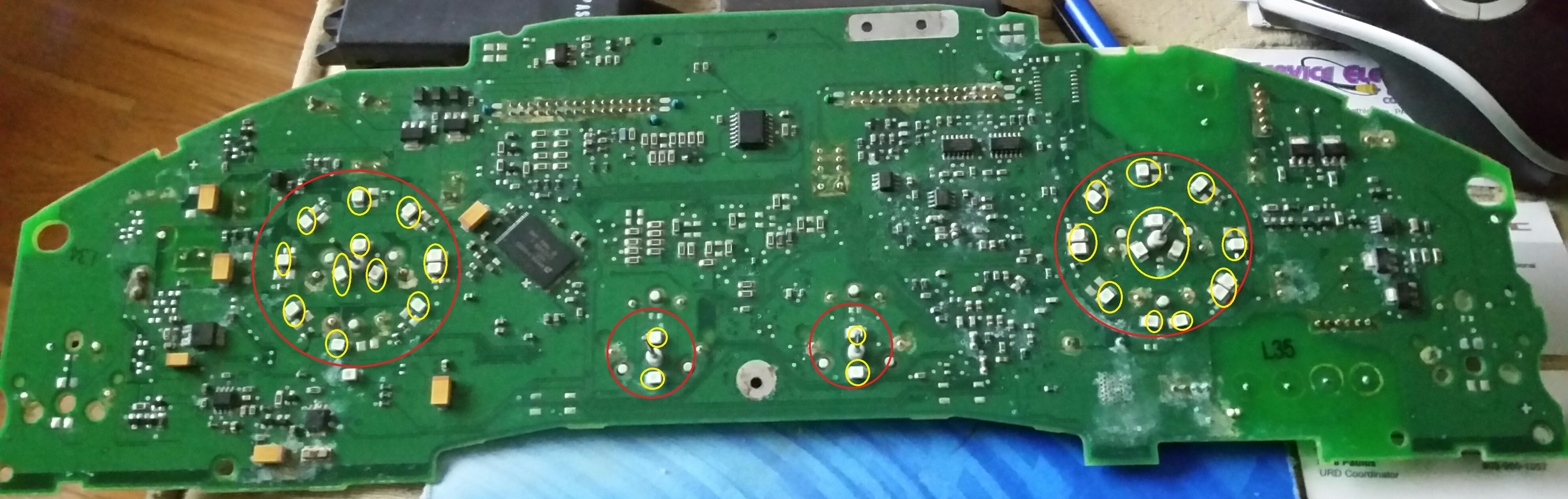

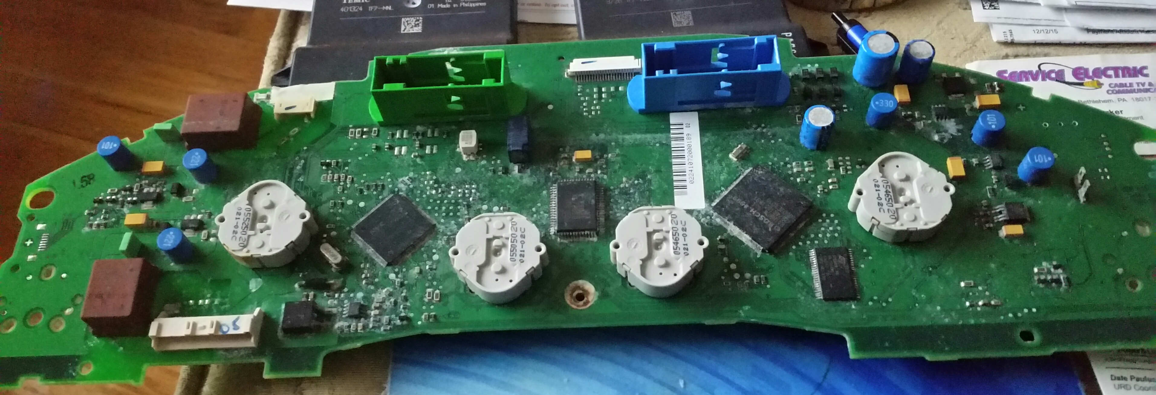

Originally Posted by Paizatron
Ok I'm going to give it a try. Hopefully it's the backlight. Thanks for help bro
Guys,
There is no backlight or bulbs, they are individual LED chips, see attached picture, I doubt that all chips burnt out at once, so double check all fuses for dash, the DIS works because it is a screen like a TV, you could pull the cluster to check to connection of the blue and green plugs, I doubt that is the problem, but worth a try.
Also note that the LED chips that light your Tach, Speedo, Temp, and Fuel needles all work, so it is just the gauge circuit that is not functioning.
See attached fuse info.
Johnny J J
