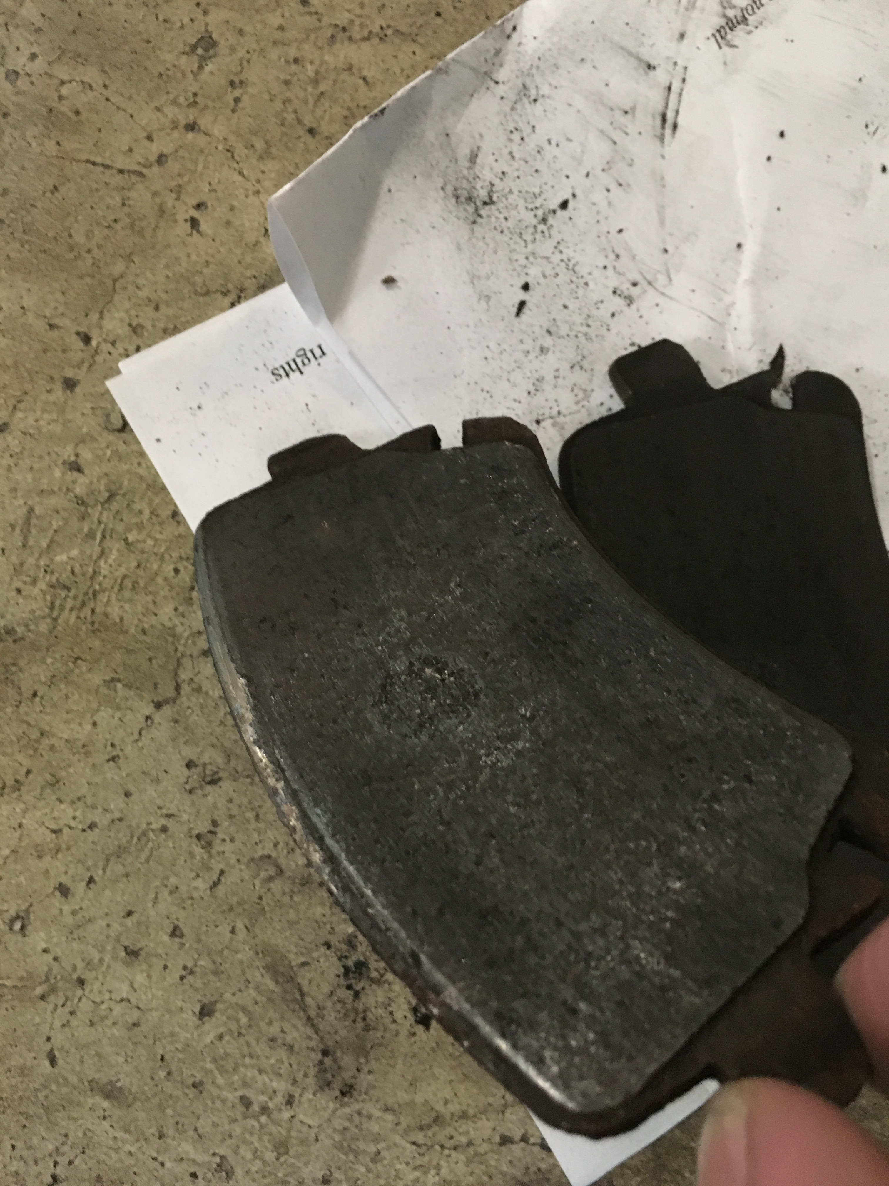

Finally had time to work on car and used Bentley pads as had conflicting data on pad shape so didnt bother trying others.
The Bentley pads (Ferodo FER 139-60) came with two brake were sensors but my rear pads didnt have any?
Photos show the inner pads which was making metal to metal contact.
J
