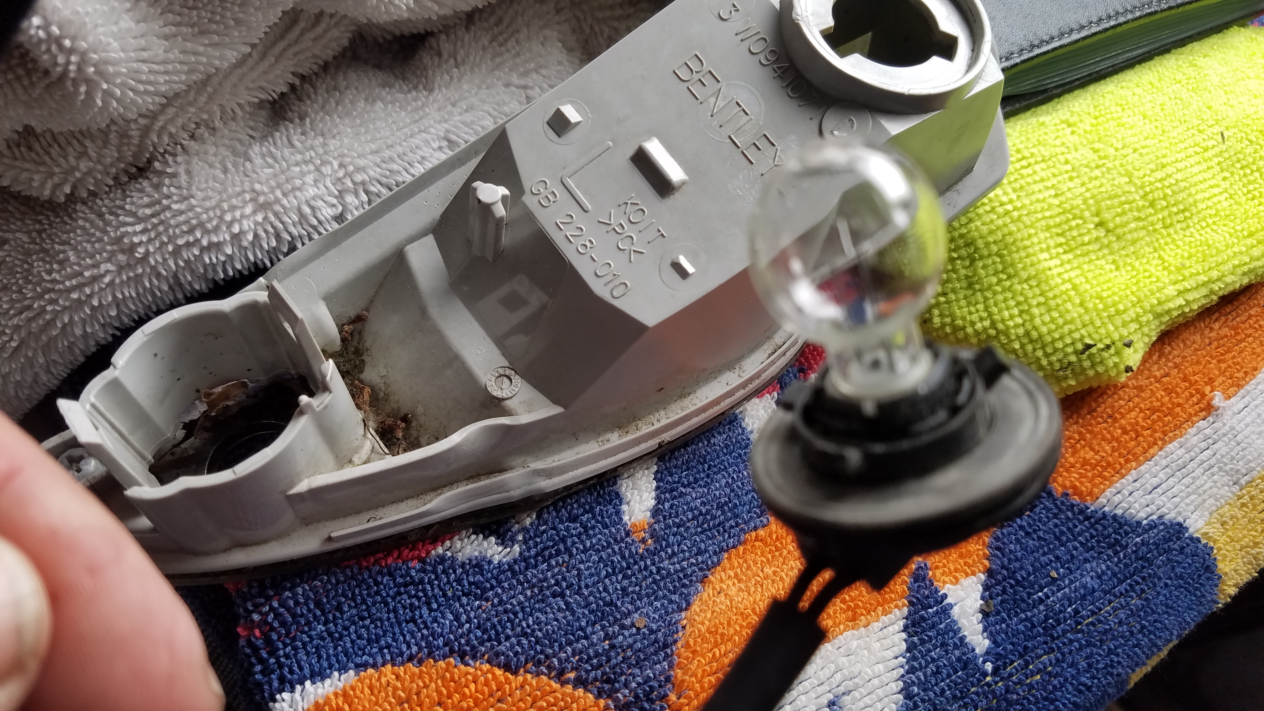

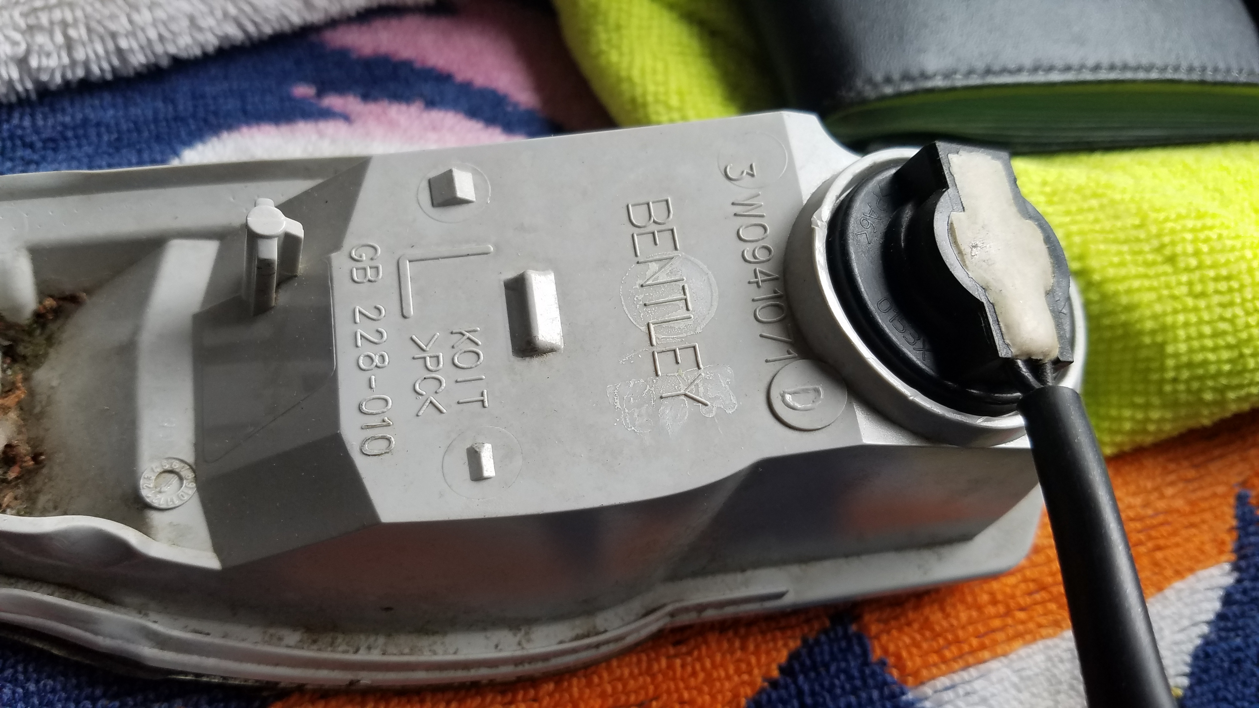

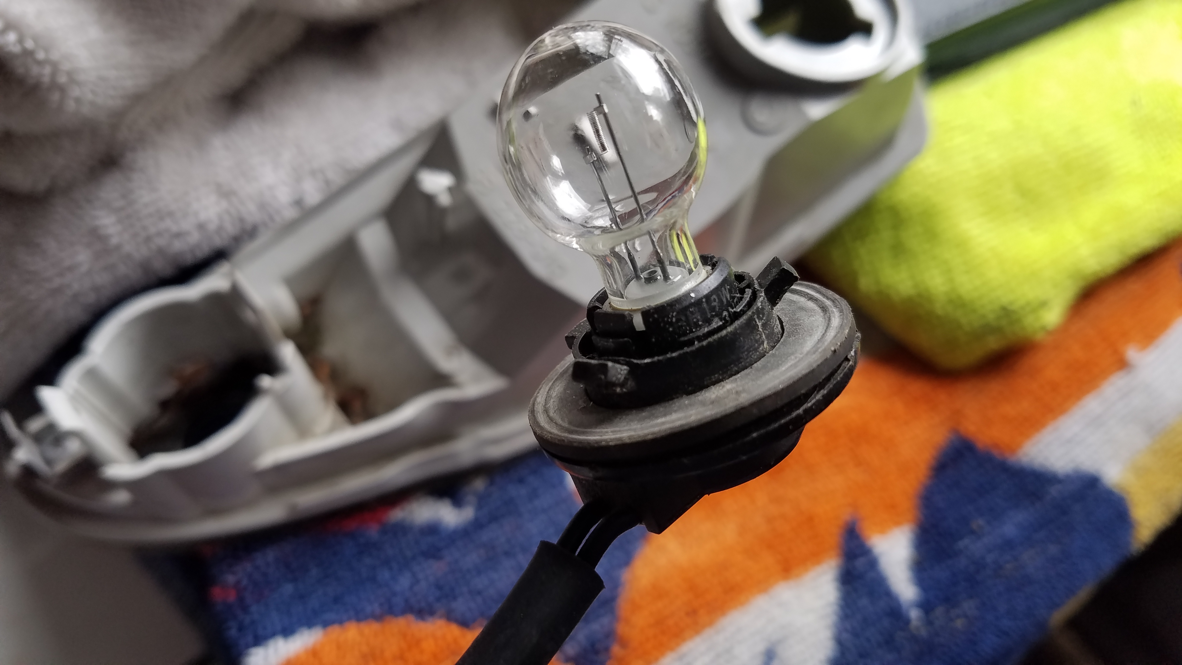

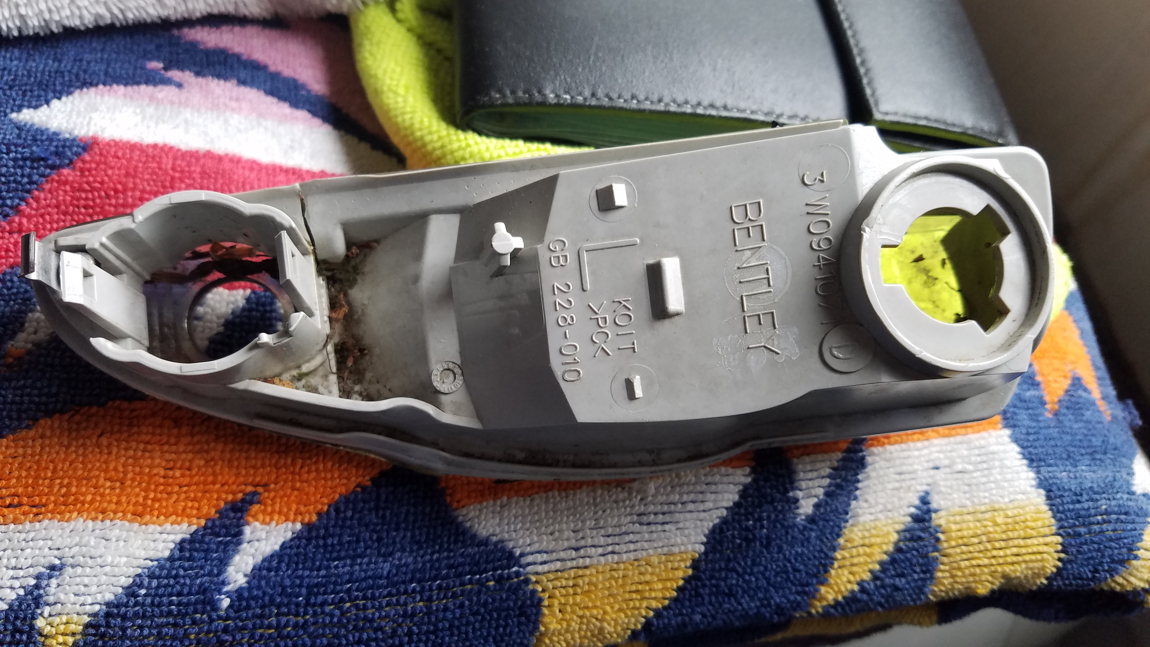

The bulb socket does twist out, just use some pliers, gently...
ID:	448824   Click image for larger version
ID:	448825   Click image for larger version
ID:	448826   Click image for larger version

this is a PH19W - appears to be a fixed bulb, no?
