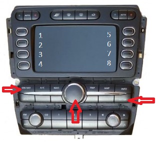

Here is what I found, use at your own risk.
http://diag-auto.biz/eshop/en/docume...at-screen.html
Inorder to change language on a Bentley Continental GT,
you will have to:
-change text language on the Dashboard / instrument pack (this can be done with a dealer level diagnostic tool like Autologic),.
-get a CD/DVD to exchange text and voice in the infotainement system (radio screen / sat.. nav / Tel, TV,...)
There are several existing CDs/DVDs to change language. The CD to use depends on the version of the sat nav level software ECU. The procedure to identify the correct CD to use is the following:
Insert a valid key,
Switch ignition ON,
If the infotainment screen does not turn on, press the power button / stop (ON / OFF),
Press the Set Up button of the infotainment screen,
Press the 4 button,
Press the 5 button,
Simultaneously press buttons 5 and 8 for 10 seconds,
The display will show the version of the software. Press the Rotary button 5 times,
The display will show the version of the navigation control module.
Take note of the different information or a photo and we contact to identify what CD/DVD you must use.
