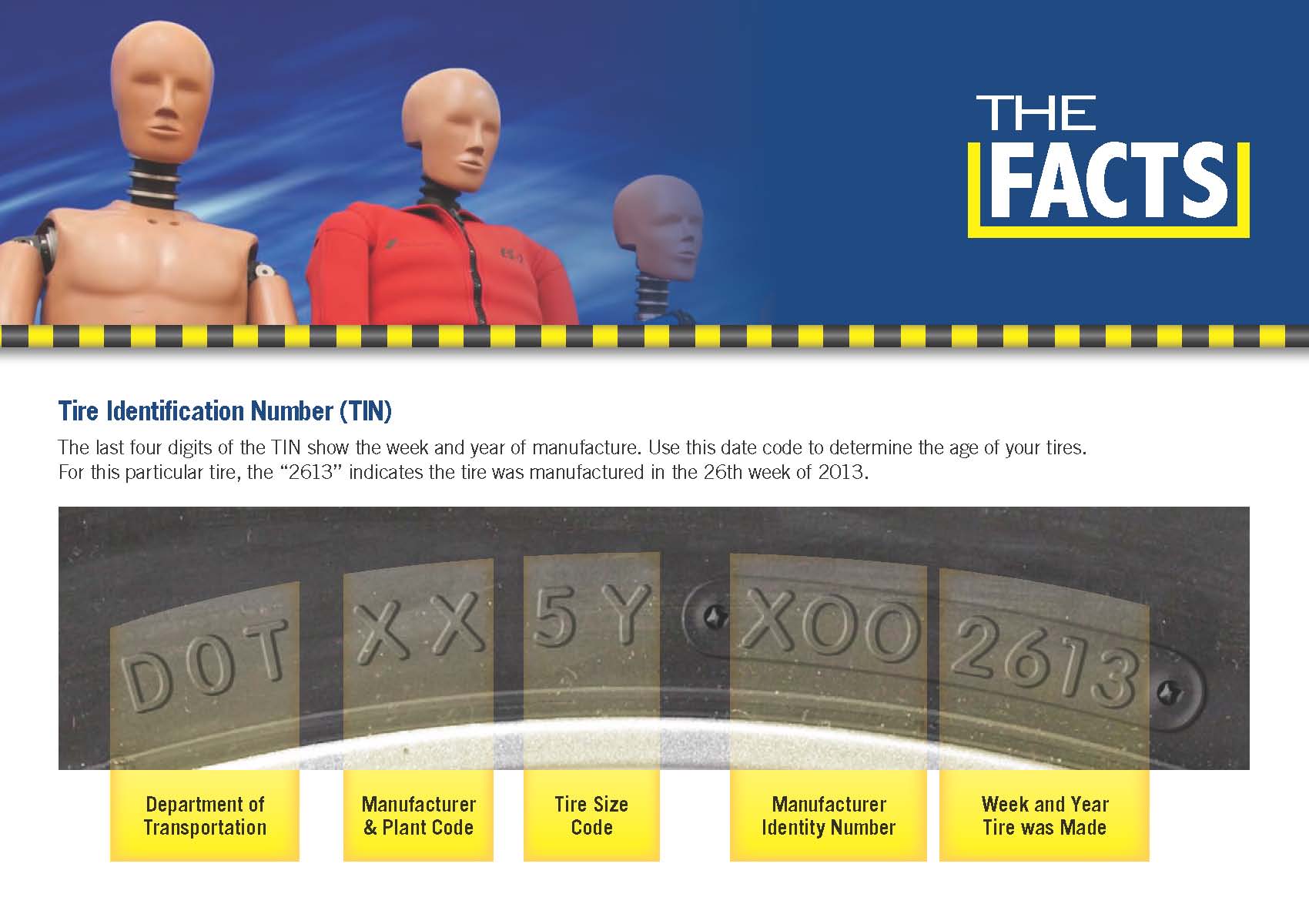

How to tell the age of your tires...
Name:	NHTSATireReportJune2013 r 3c.jpg
