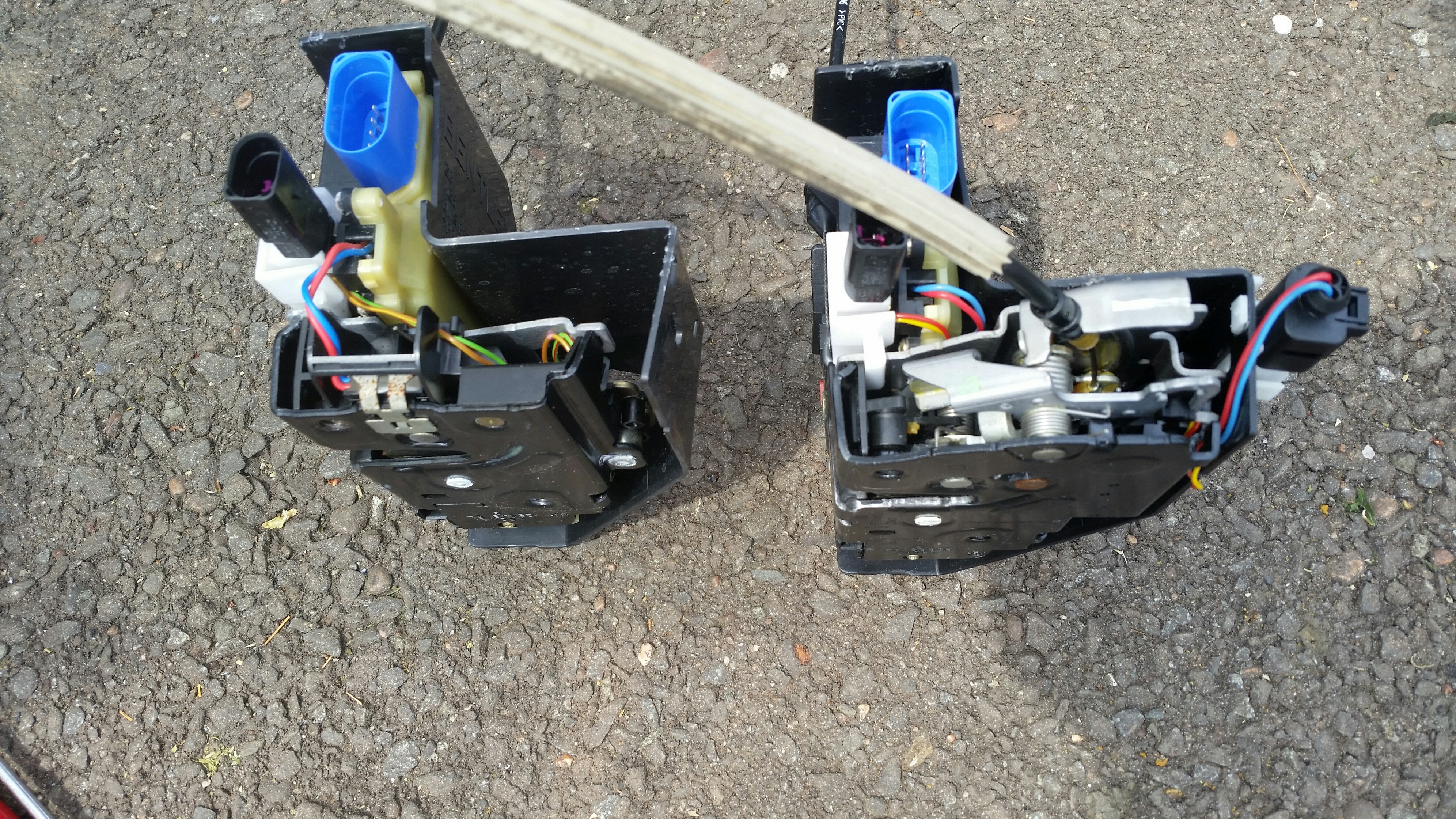

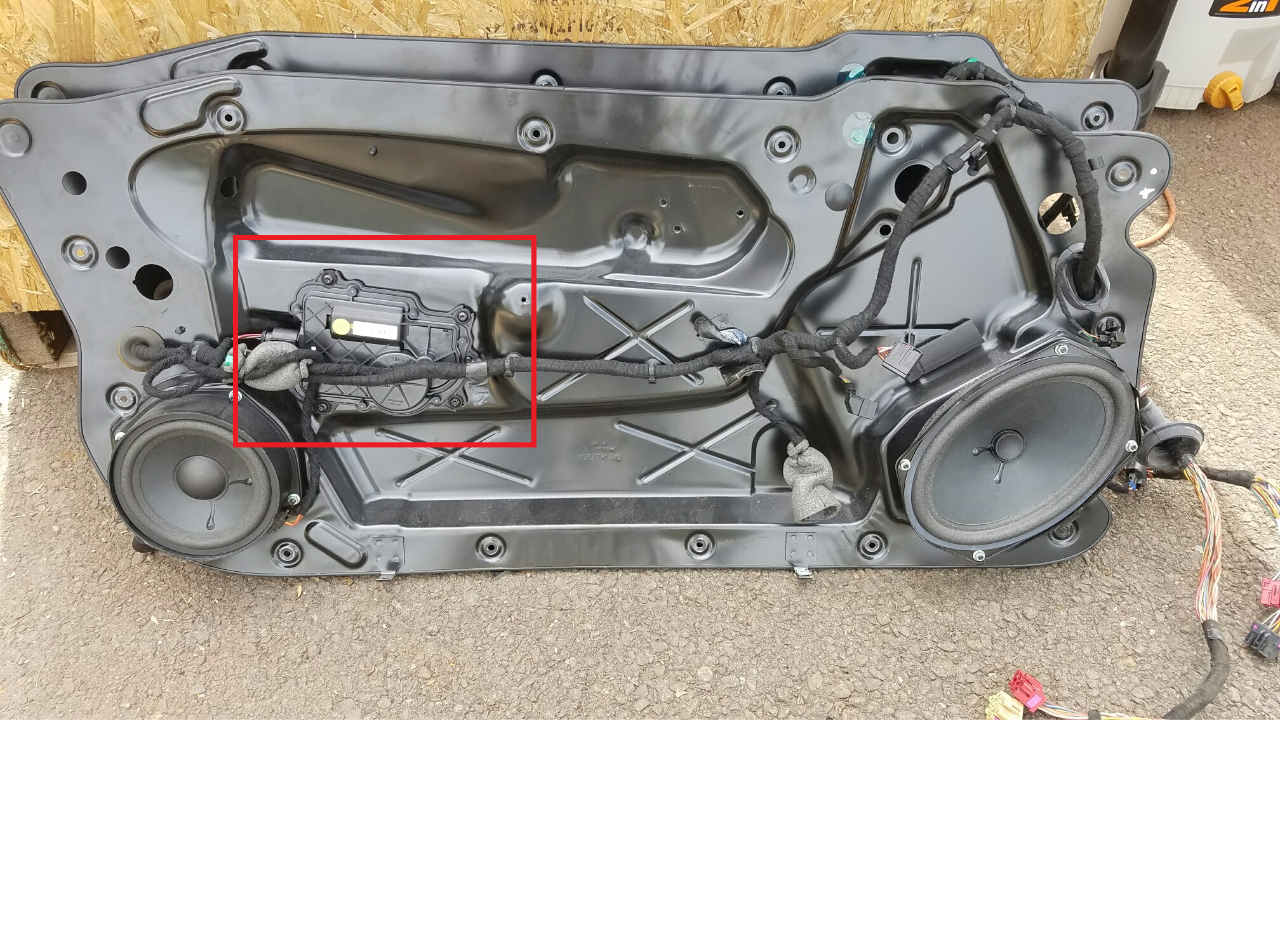

It is the soft close option, it gets used every time you shut the door, this way you are not slamming it, it is not vacuum at all, it is an electric motor, cable system, and soft close latch, here are some pictures from my build where I added soft close to my vehicle.

I am thinking it is your drivers door, as you stated the passenger closes properly, I will check for the part #'s, but first you need to know what part you need, if the cable snapped you must buy the complete latch as cable is not available separately, or if it is the motor, but I doubt that, next would be to check the micro switch on the door latch and repair it, as again not available separately.
Also if you close the door slowly just one click, can you her the soft close motor running ?
Here is a link to the same kind of soft close latch on a A8L showing what fails are for as micro switches.
http://www.audiworld.com/forums/a8-s...aired-2811599/
