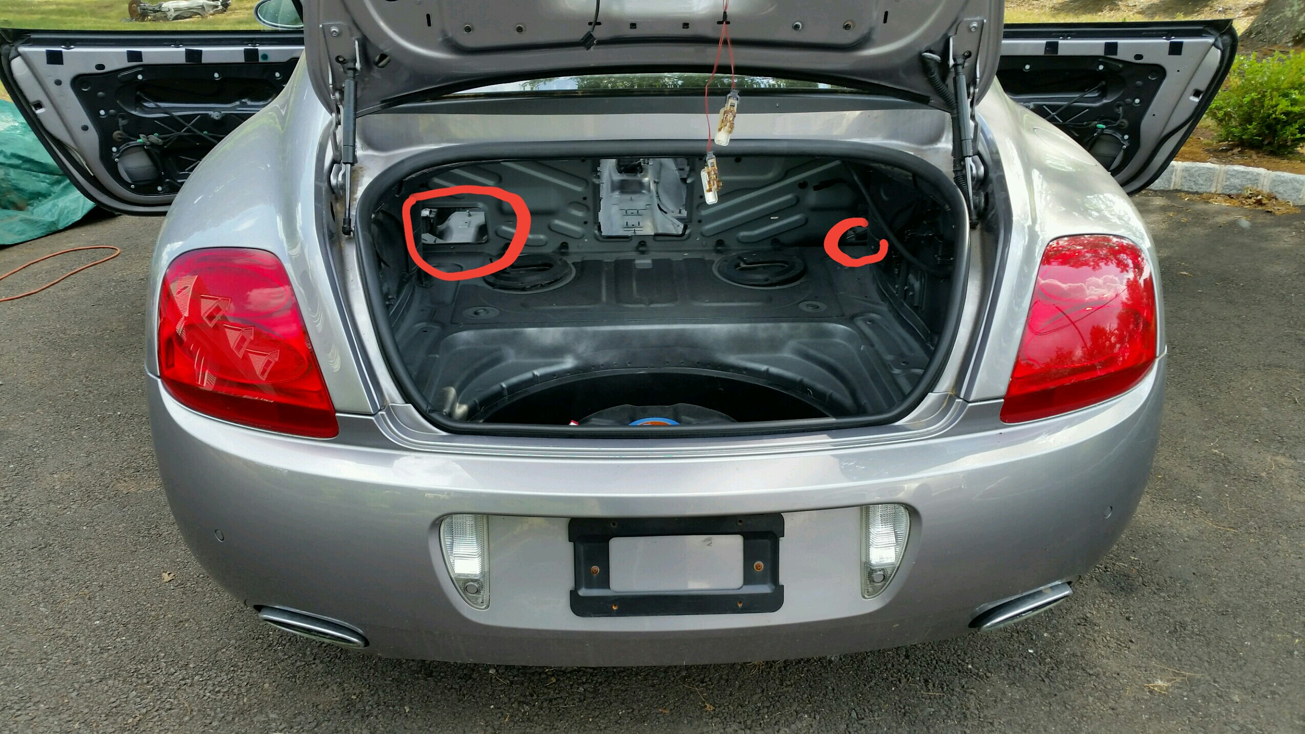

Hello Lilo,
Here are the two access areas to the trunk, facing the vehicle from the rear, the righthand smaller opening has the battery cables, the much larger opening on the left has the body wiring harness and no battery cables.

Originally Posted by Johnny Hotspur GT
Hello Lilo,
Thanks Johnny. I got the right rear seat and both front and rear console veneer removed and can see the large hole going to the trunk. Thanks again for the help!
