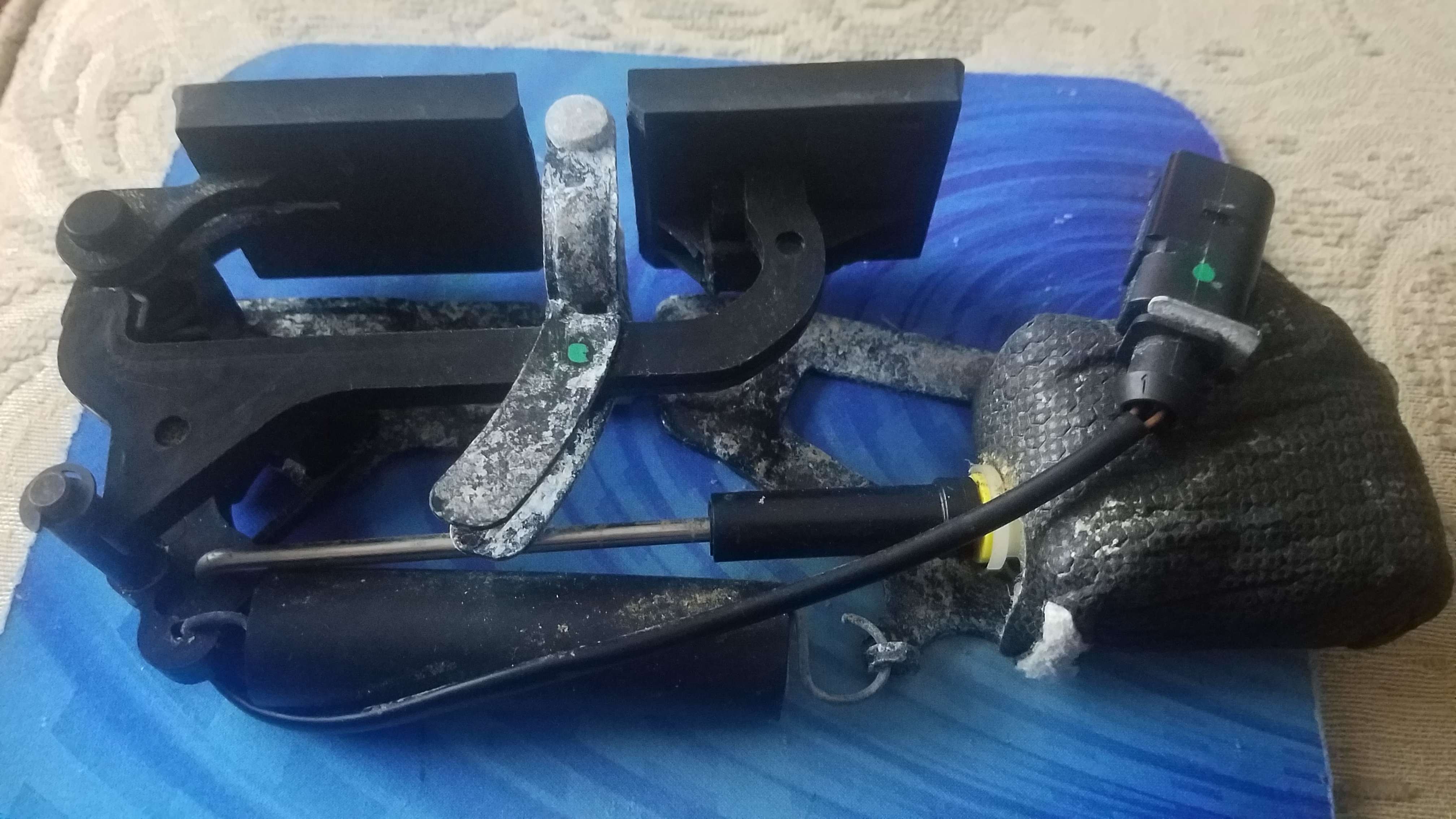

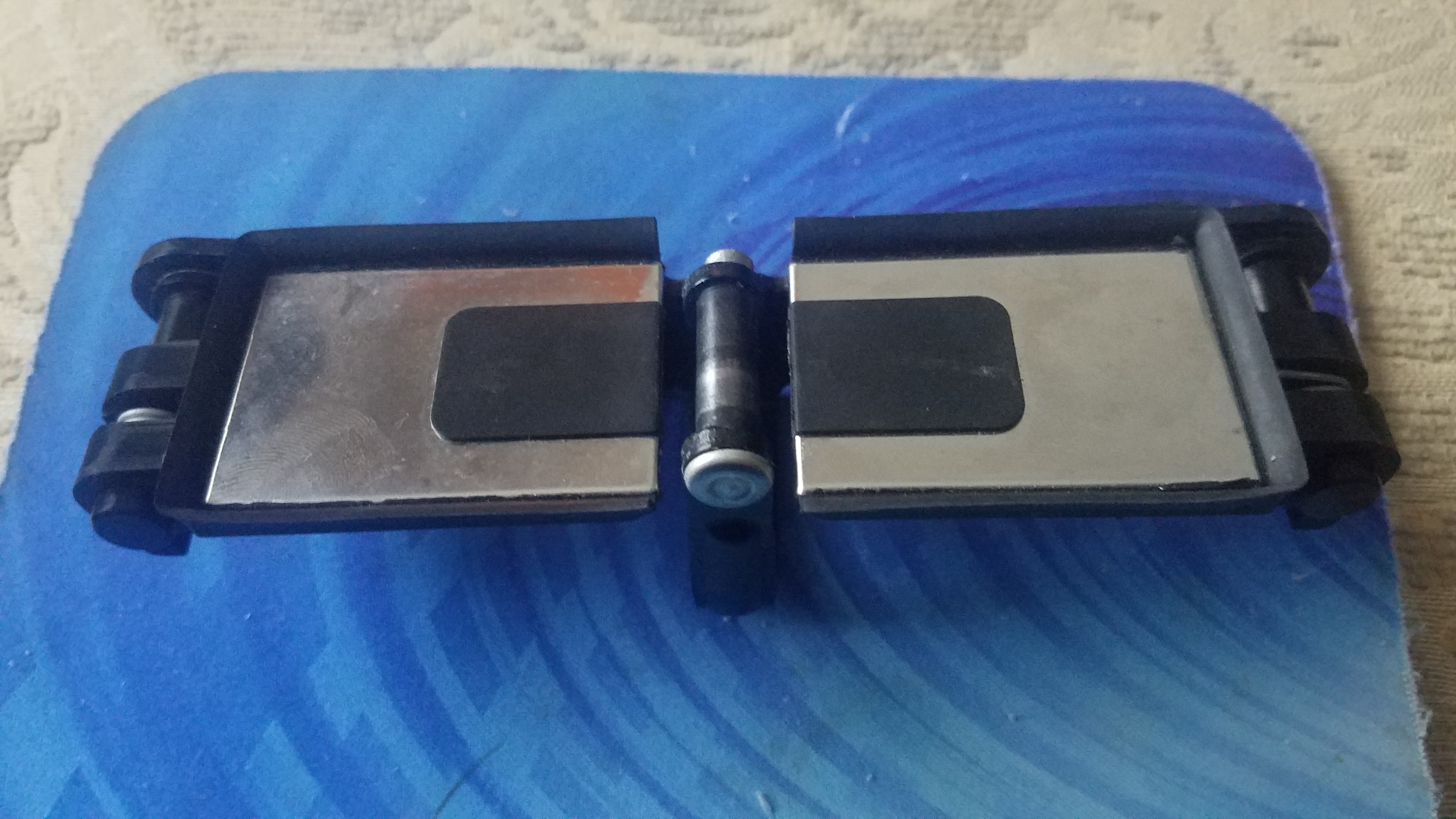

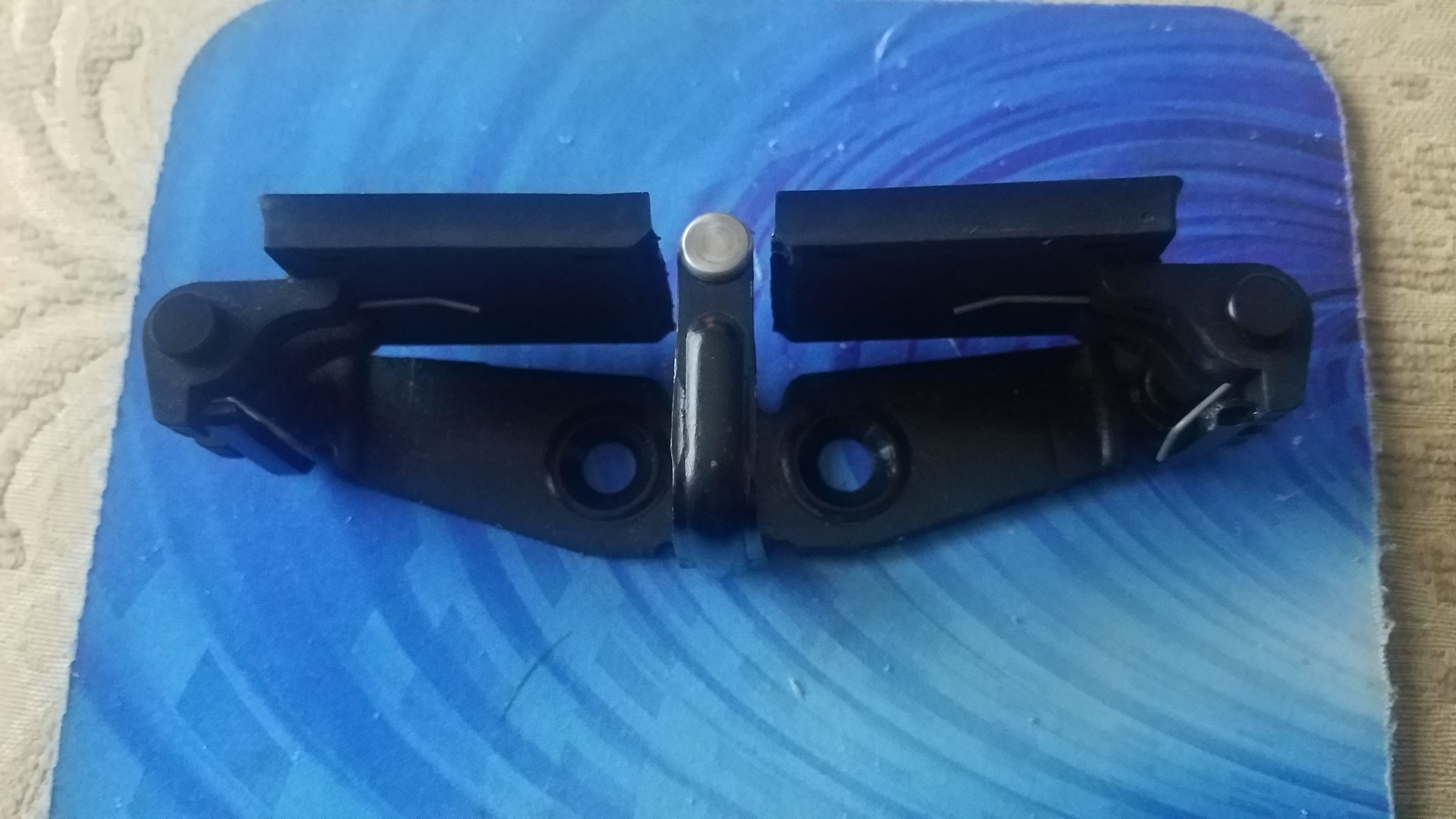

Hello All,
As to not confuse each other, as some of you here in the USA are stating "Left Passenger Rear Seat", YES the seat is to your left when you are in the rear facing the rear of the vehicle, BUT it is still the passenger right side seat, and YES as Tarnow1942 stated, I had to do the same on both the 05 and 06 GT's, as there is to much slack in the cable routing itself, and I mean I had to pull hard on the 06, hard enough that the little z connection piece on the end broke off and I punched myself in the mouth, felt like I knocked my teeth out, BUT the trunk was open now......
Just another piece of info I came to realize while doing my GT re-build, the 05 GT has power pull-down locking of the trunk latch (SOFT-LATCH), but no power lift and lower of the lid, whereas the 06 GT has the power open and close (lift and lower) but no separate soft latch as the 05, in the pictures you can see the 05 with the soft latch motor, and the 06 without.

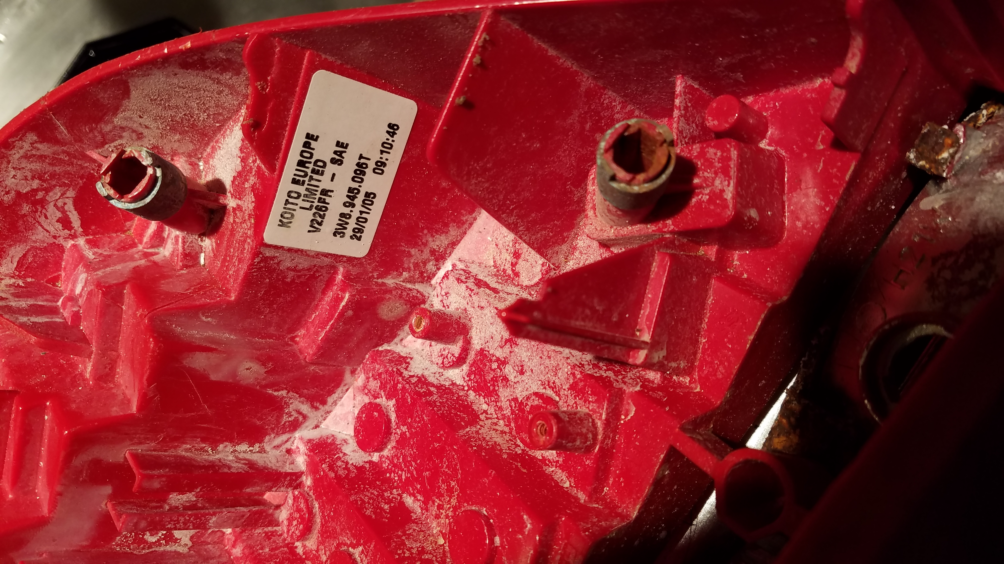

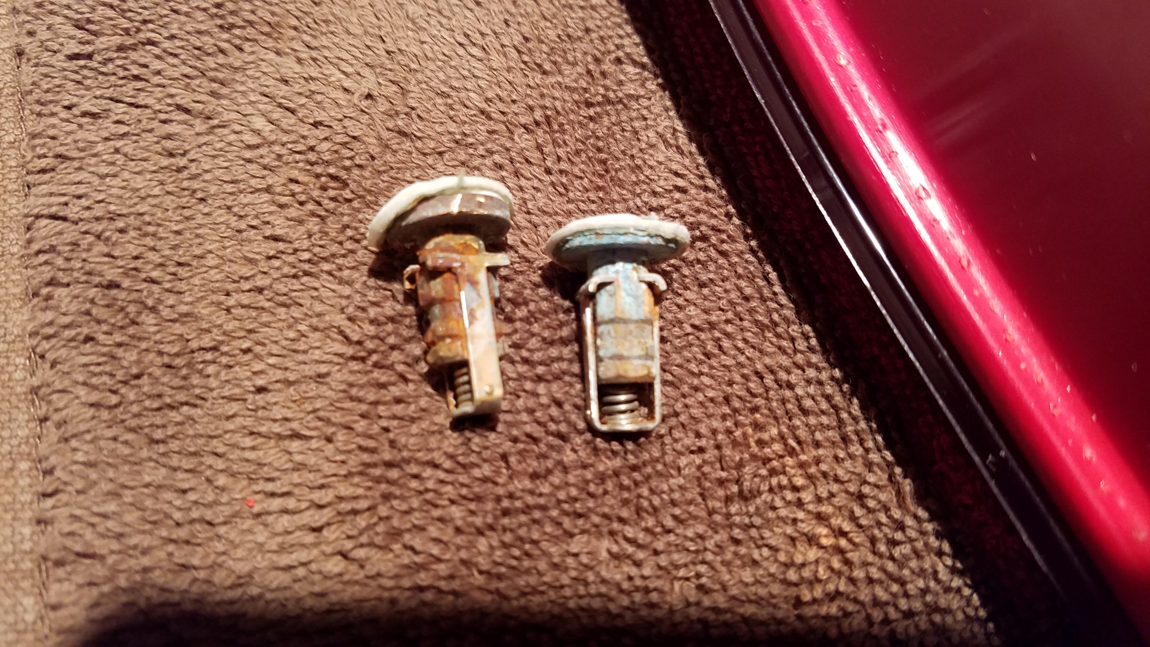

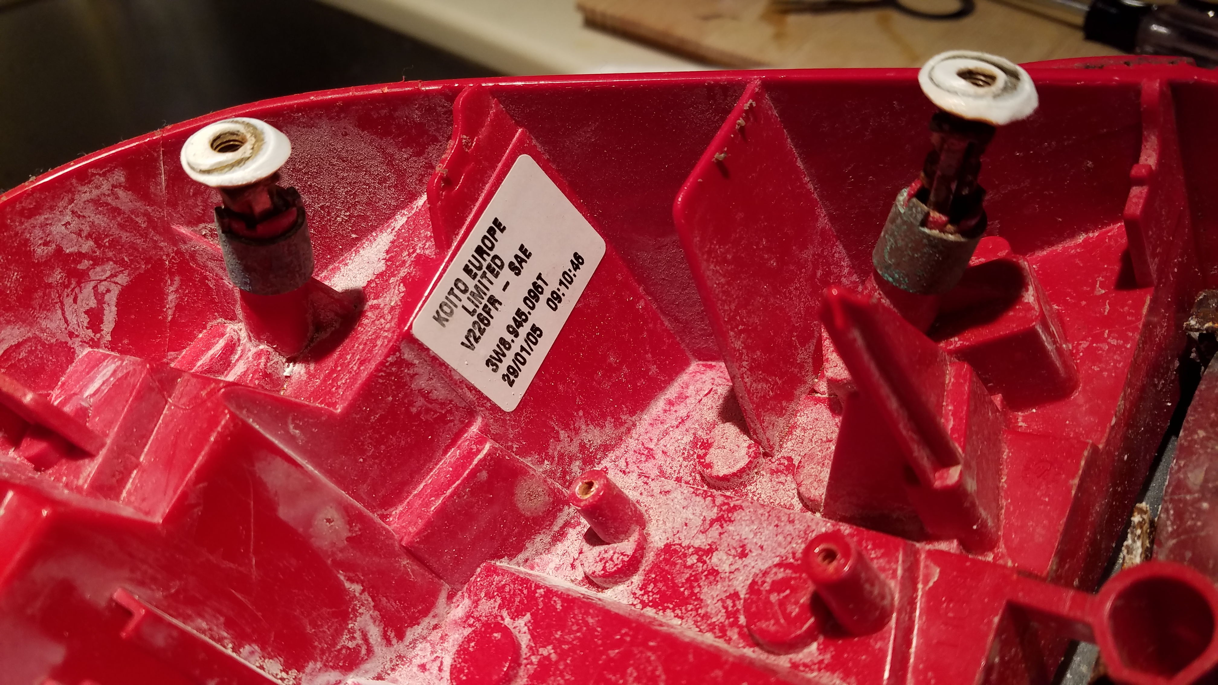

Hello Ron,
Yes, all the years taillights are bolted in, when using the plunger removal method, what happens is the bolts and bolts receptacle stay attached to the vehicle while these spring loaded bolt receptacles slide out of the taillight housing.
Hello Johnny Hotspur. I appreciate you FYI. I looked at my old cracked removed taillight and see how the bolt release feature works. I would try the plunger method before trunk damage and replacement. I know the possibility of braking the tail light during the plunger removal at a high cost of $2,000. I had a slight crack in my removed taillight, and now thinking about the removal procedure I would have attempted the plunger to see how easy the removal would have been. I think I would use the plunger and Duct tape the plunger to the lens fore a larger suction surface. I hope I will never need to try the removal.
