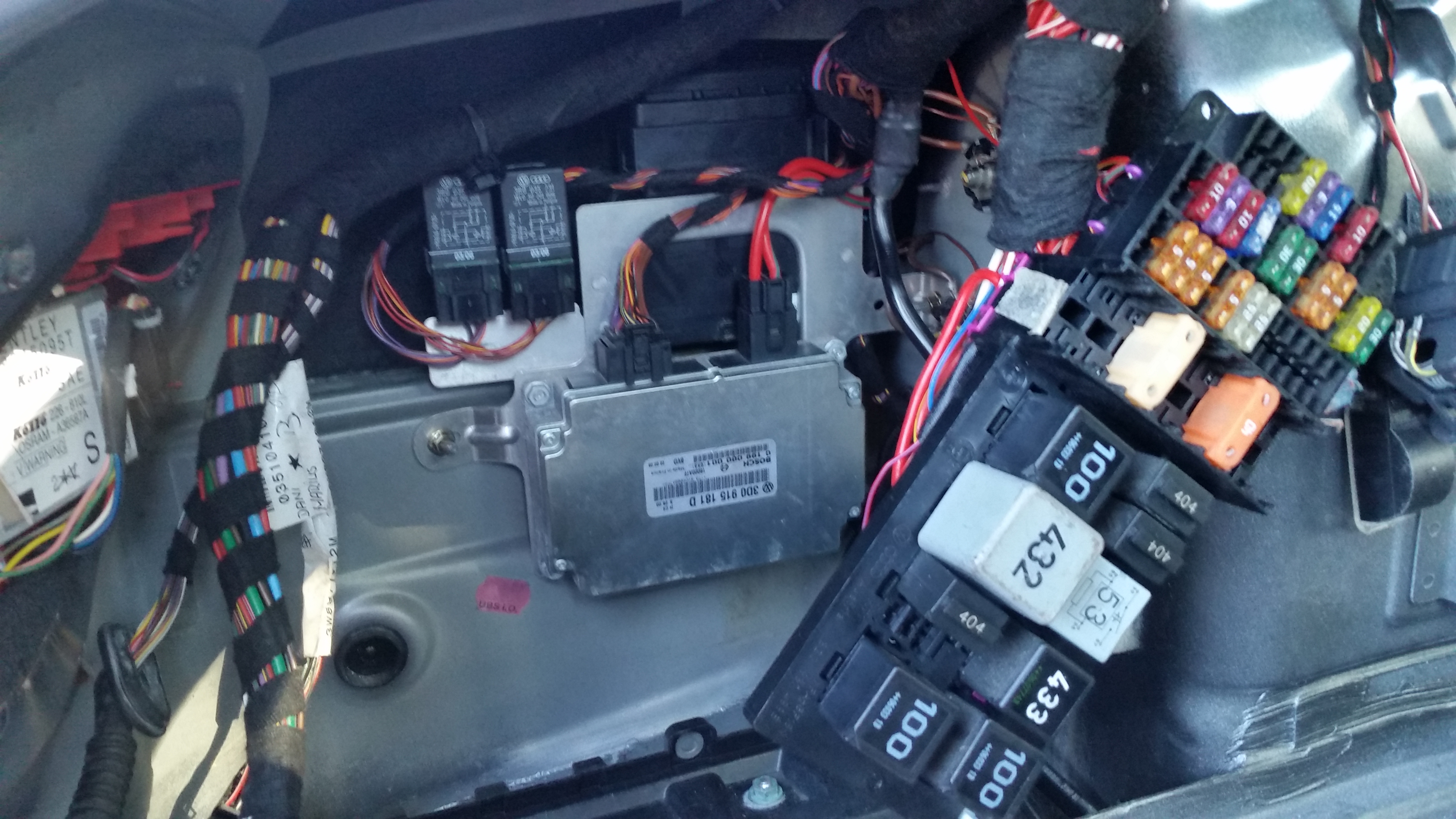

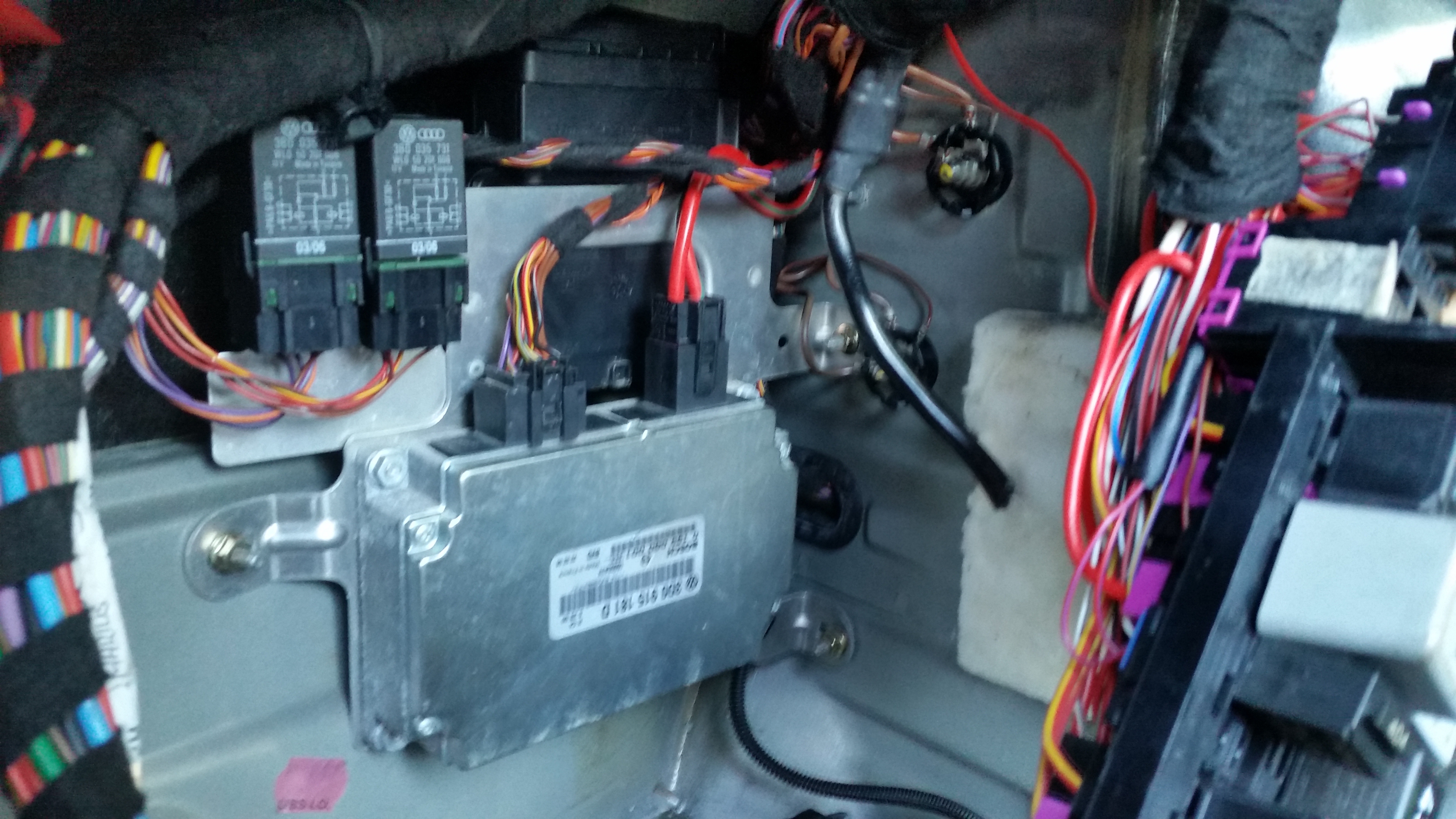

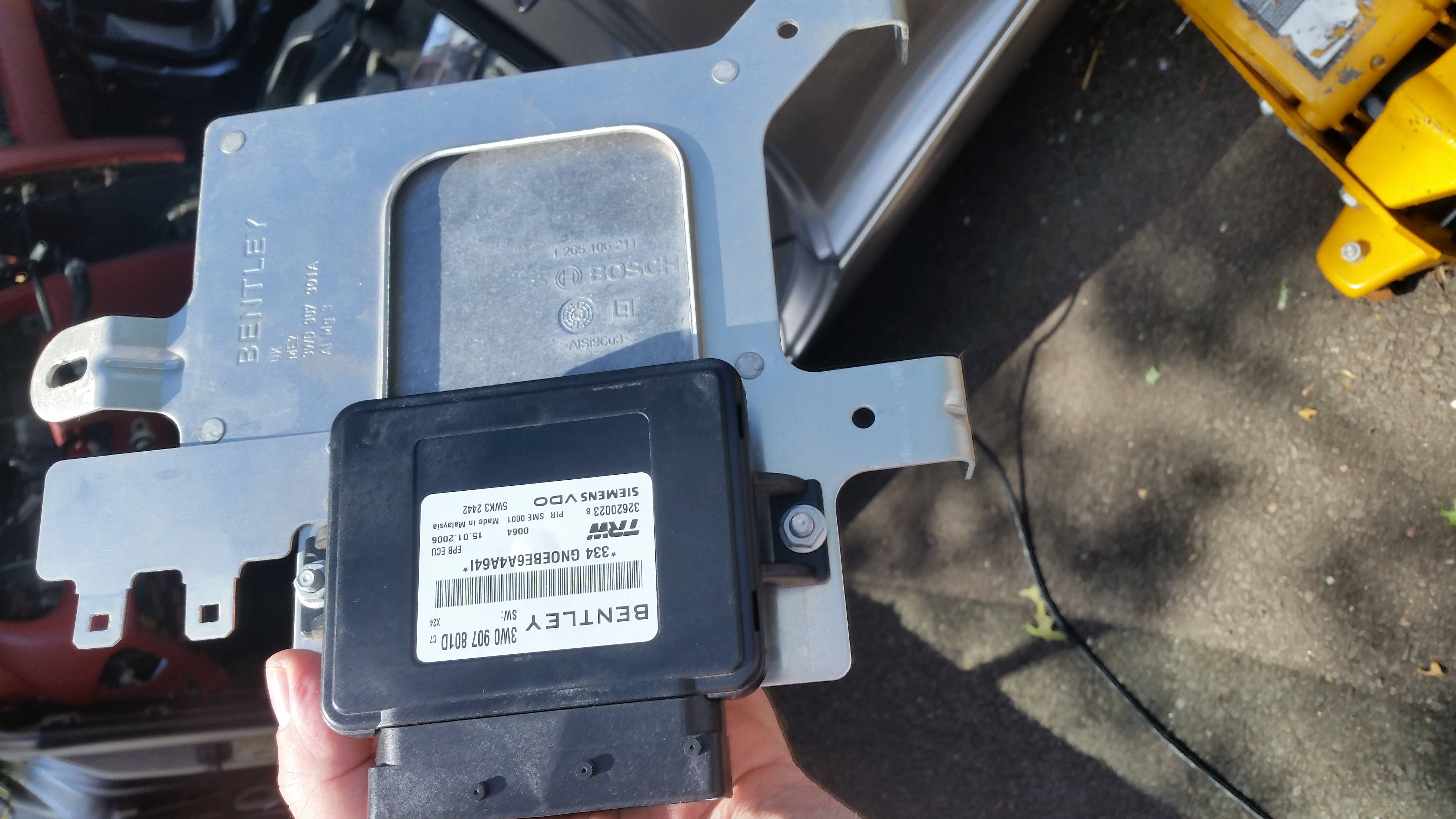

Hello Nairb999,
Check the sensor as Steven stated, BUT if you do need to replace the parking brake control module, it is located in the trunk on the left side when facing the rear of vehicle, it is part number 3W0 907 801 D, the prefix letter may be different for your year, but it shouldn't matter if if you replace it with a later version letter 2004-2008, it is located behind the battery control module part number 3D0 915 181 D, see my picture below of said modules, the black plastic module is the one you seek.
Also see my GT rebuild thread for more information.

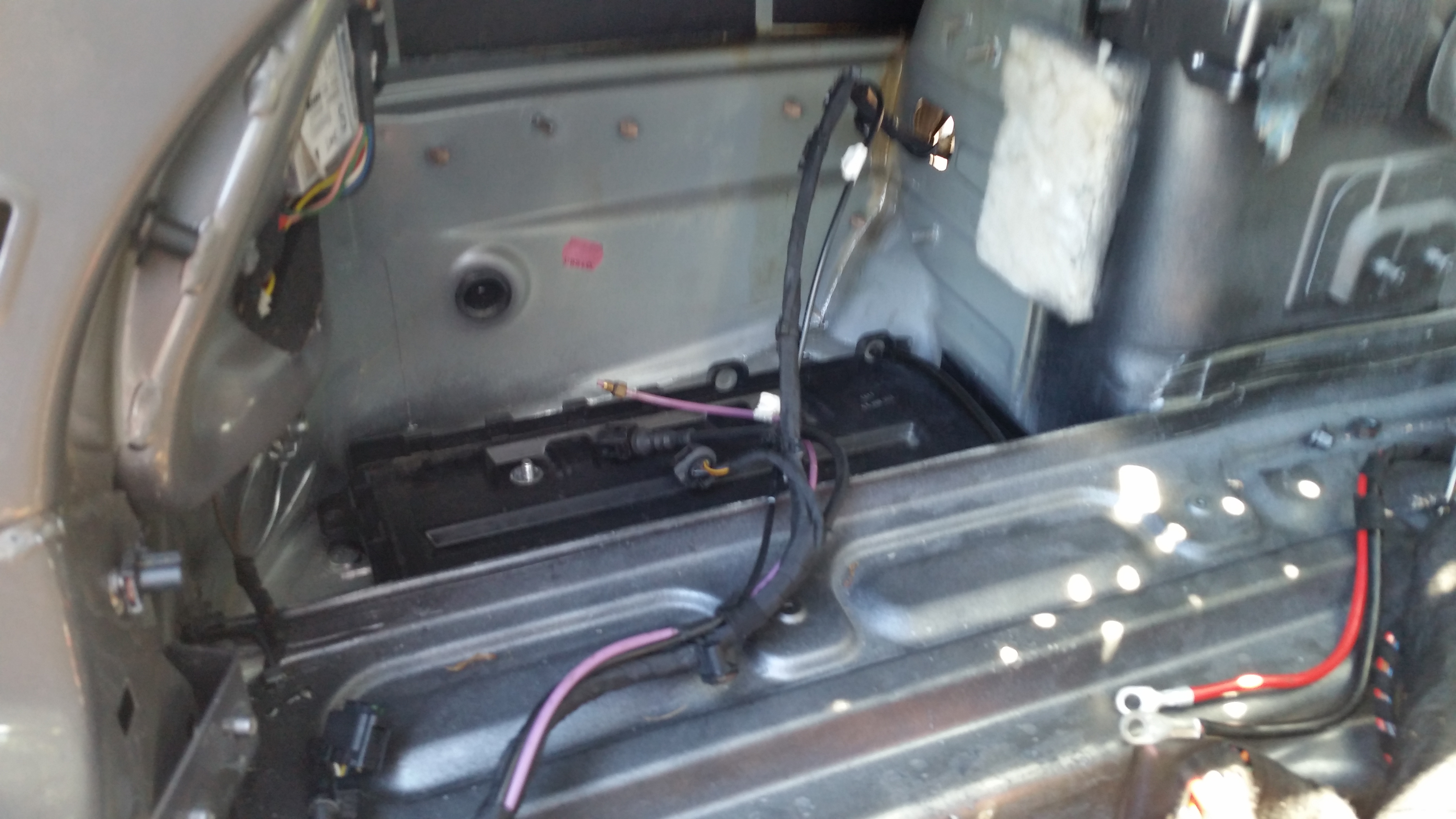

Hello Nairb999,
Yes, if it came to replacing said module then yes the left side house battery must be removed to gain access to remove the mounting bracket the holds both the battery management, and parking brake modules as shown in my pictures, BUT do check as others have stated on the sensor, let's just be clear if it is a ABS sensor which measures rotation of the axle, or is there a sensor for the parking brake, I tend to think not, and that the parking brake motors stop at a measured value of resistance by the PB CM, But if anyone knows for sure, please share.
