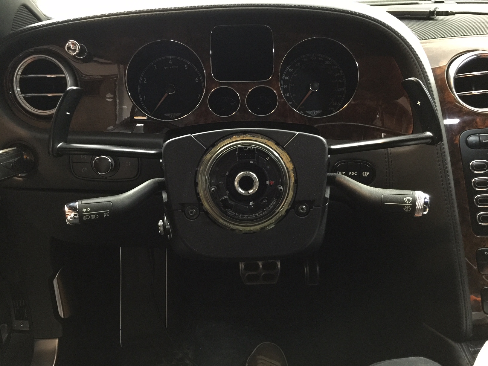

I just swapped my 4 spoke steering wheel to 3 spoke but the cruise control and heated steering wheel is not working.

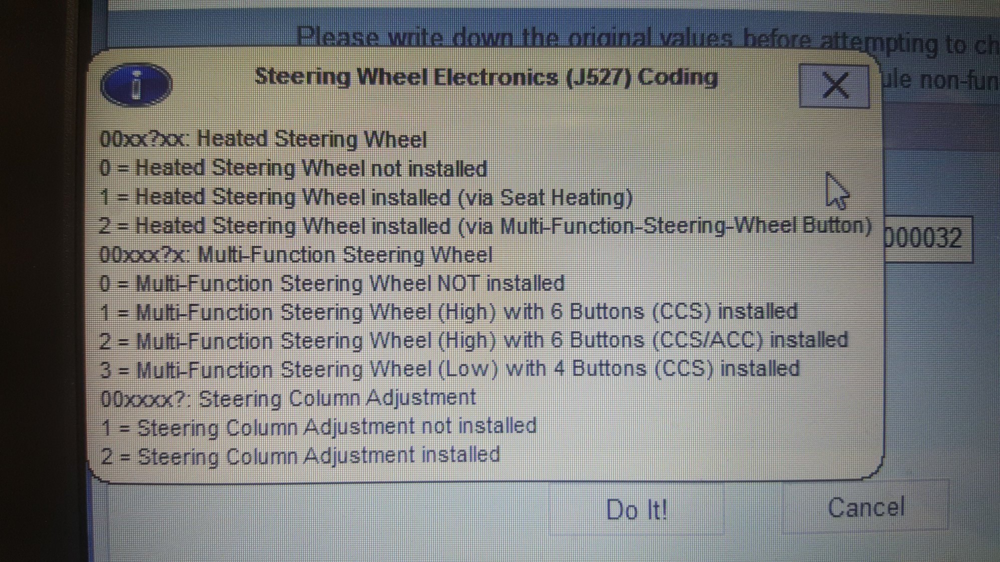

If you have a VCDS and 3 spoke, can you go into the Steering wheel module and tell me what your coding is?

Hi Lilo
I have the 3 spoke and VCDS. However im in the 2nd gen 2012MY now although I expect the coding will be the same?...
Also I do not have heated steering wheel.

thanks Mike for the code. Does your steering wheel have a heated button? Also, do you have the convenience access feature? Bascially the steering wheel retracts when you exit the car? The old style has a little button on the steering wheel but the new wheel doesn't have this button.
I just realized I could test each buttons in the car by choosing advanced testing value in the module screen. Very helpful in troubleshooting items like heated steering wheel or cruise control button because there is no visual feedback.

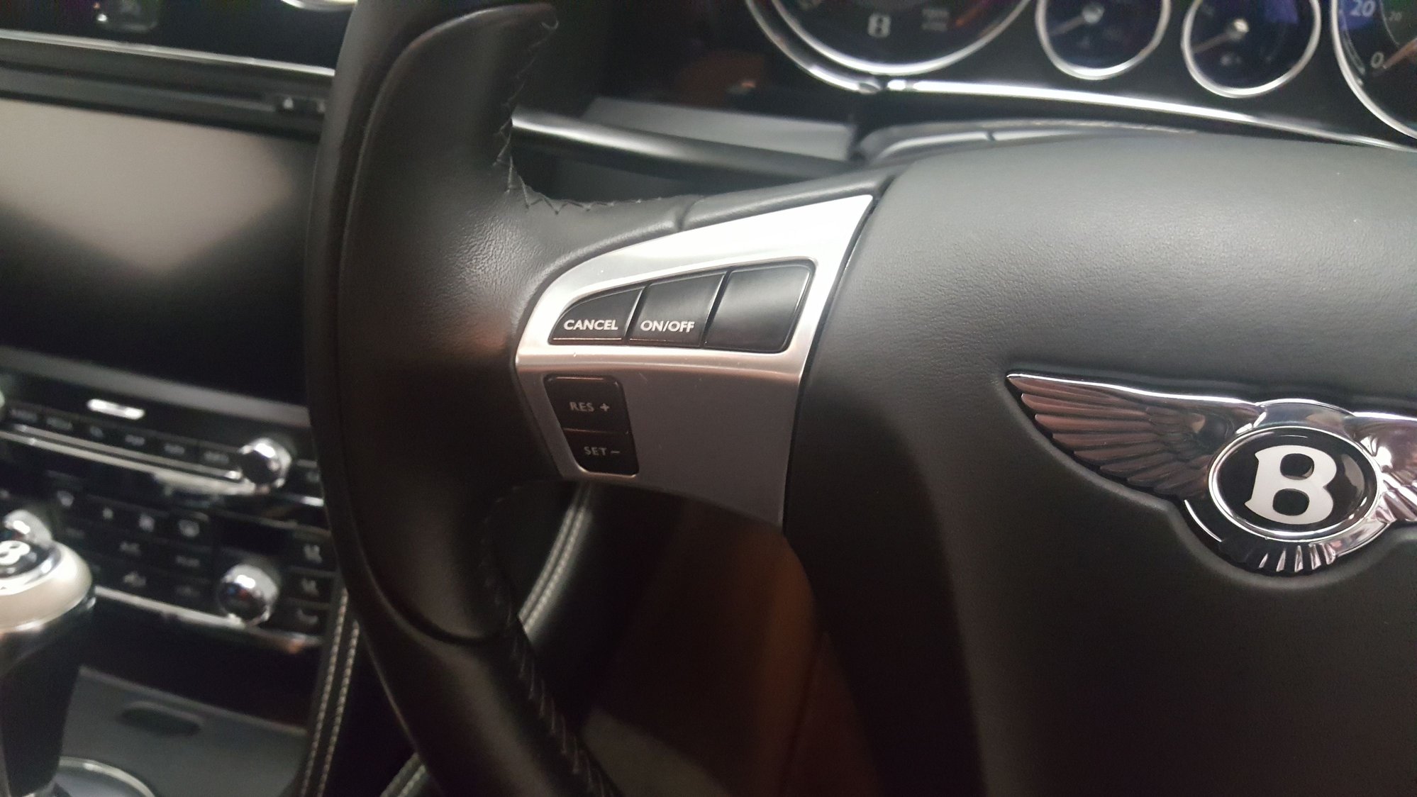

Hi lilo, just a blank space where the heated button would be. Also i DO have convenience entry/exit

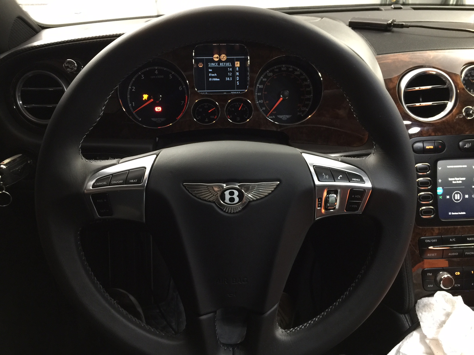

thanks Mike for the photos. Love your steering wheel. It looks brand new!

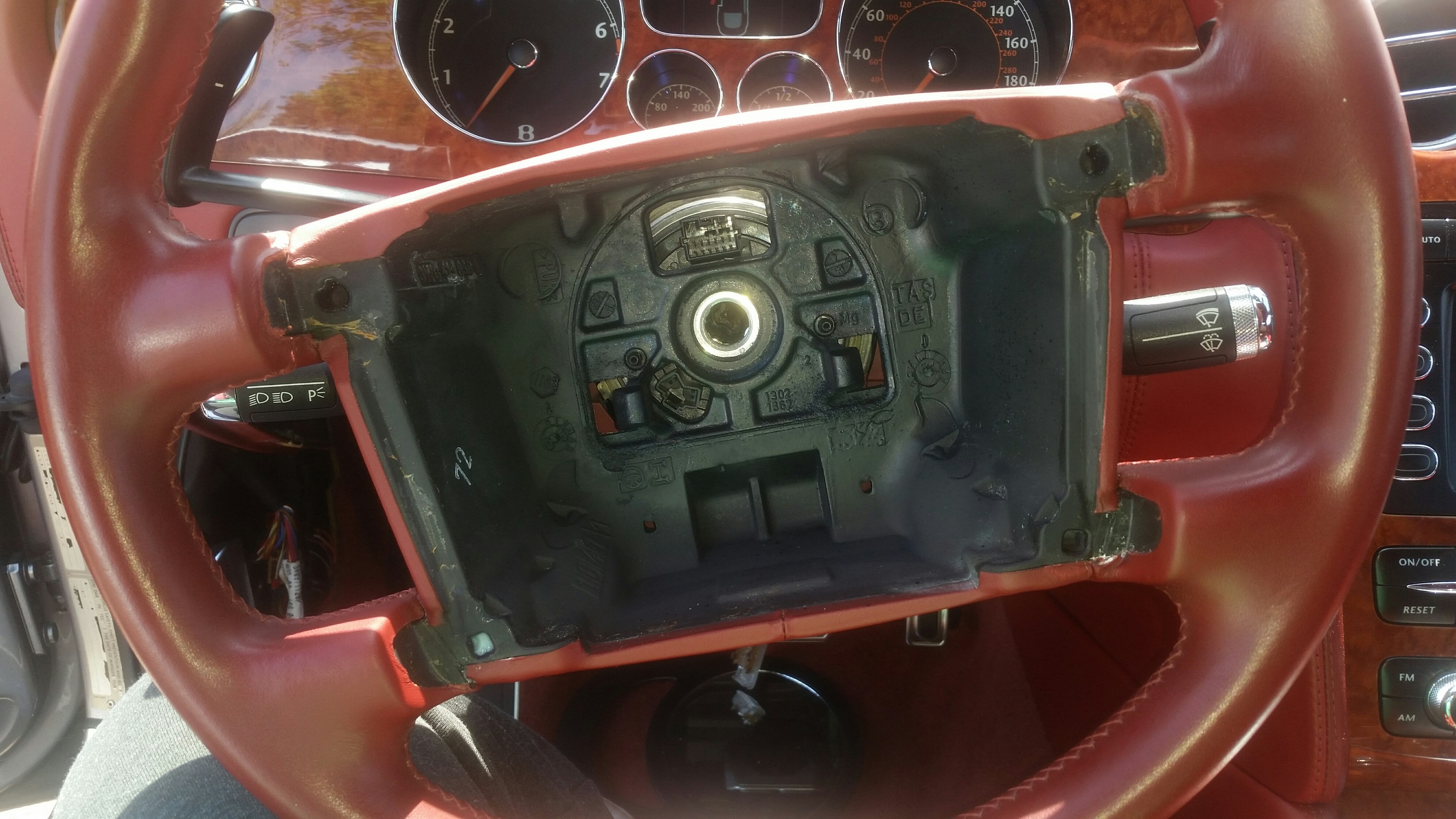

Hello Lilo,

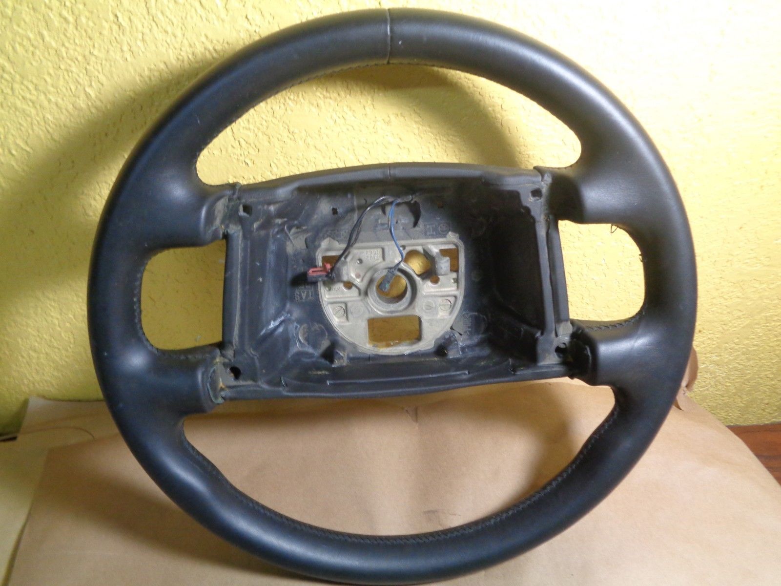

When you had the airbag removed for installation, did you see any wires coming out of the steering wheel itself as shown in the attached picture of the black SW, 3 or 4 spoke heated wheels will have these wires, if no wires, then no heat as shown in my red SW.....
ID:	476210   Click image for larger version

hah it is a shame that we can't somehow integrate the steering wheel function to the aftermarket item. I haven't tested the cruise control on the road yet because I sent the car to the body shop to paint my front bumper. However, i tested using the VcDS simulator and the buttons were functional.

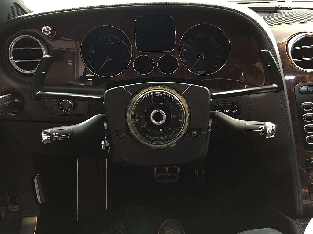

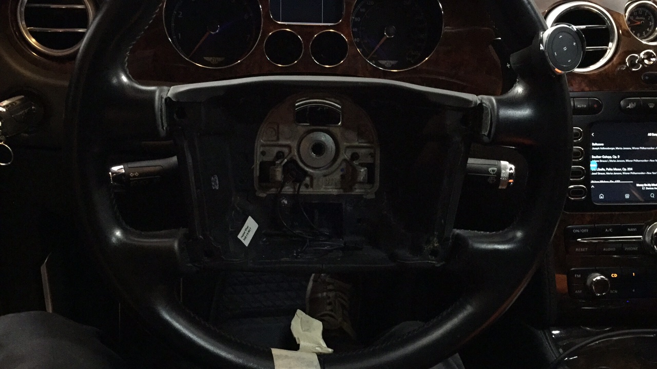

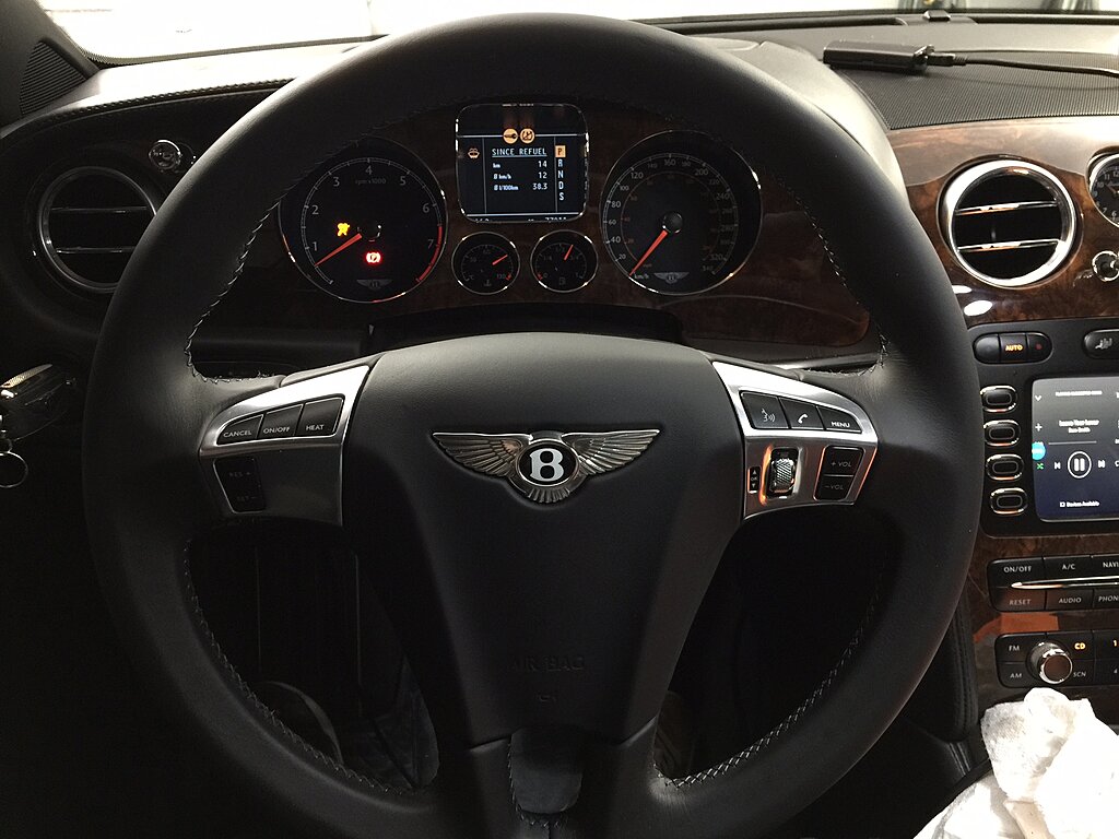

Originally Posted by Johnny Hotspur GT
Hello Lilo,
hi Johnny. Yes I had the wires when I removed the old wheel and swapped the new wheel. VCDS indicated correct button function and temperature indicator. VcDS says 28 degree celsius before heated button is pressed and gradually climbed to 31 degree. I couldn't feel or barely feel any difference. I wonder if it is because my ambient temperature is not cold enough (17 Celsius) to notice significant difference because my hand temperature is at body temp which is higher than 31 Celsius. Maybe I should hold some ice cube to cool down the steering wheel then turn on the heated function and see if it heats up?
btw thanks for your other post on steering wheel removal. It helped a lot! One thing my old wheel had was that the leather at the back of wheel didn't have the two access holes pre-punched. I had to use a screw driver to poke two holes in order to access the two holes.
