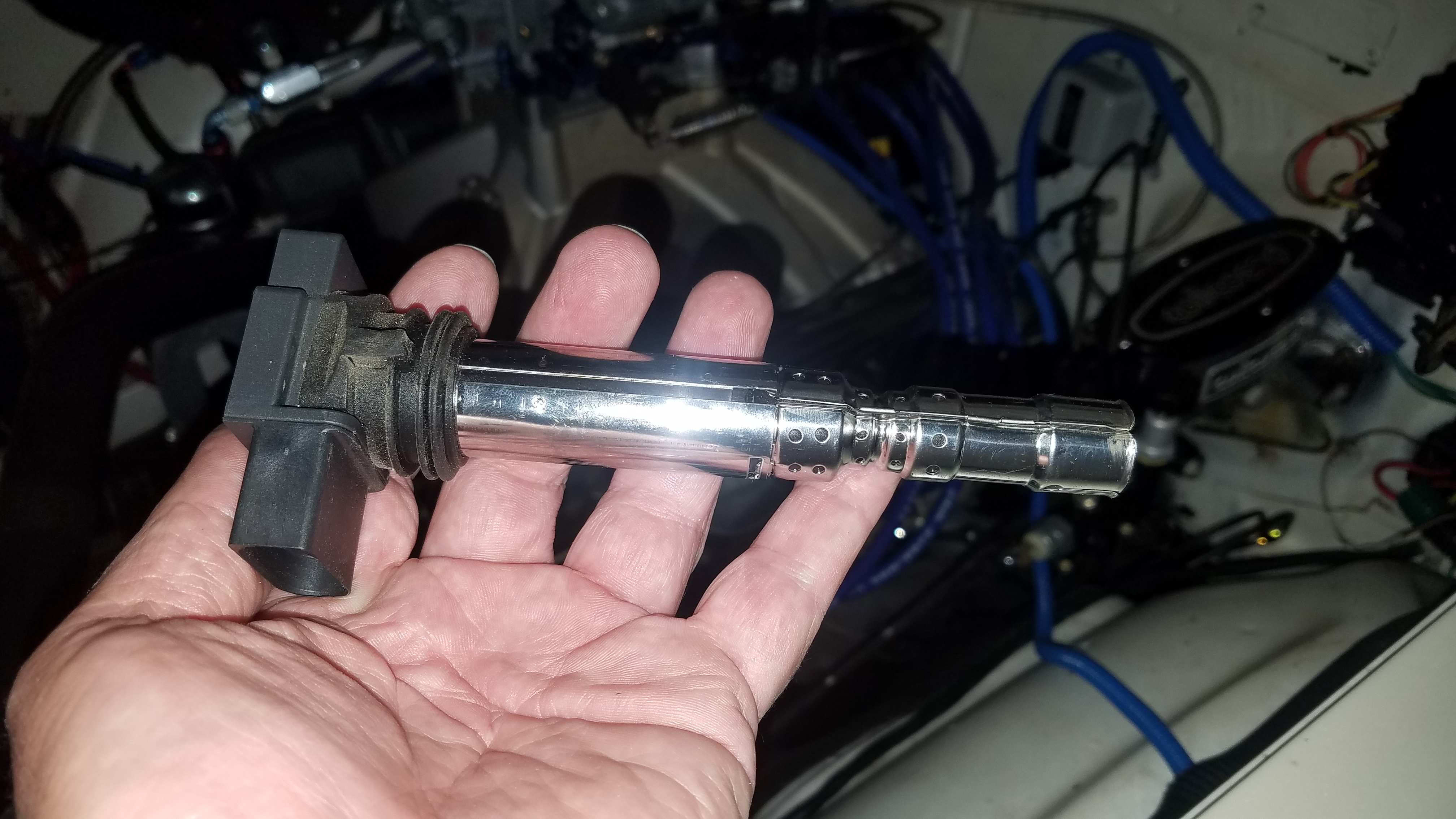

I agree with Les, and confirmed this last year with Jason Giannetti, the "L" is the latest update, you can see the dates on the pictured coils, L on the left, K on the right.
Photo courtesy of Jason Giannetti.

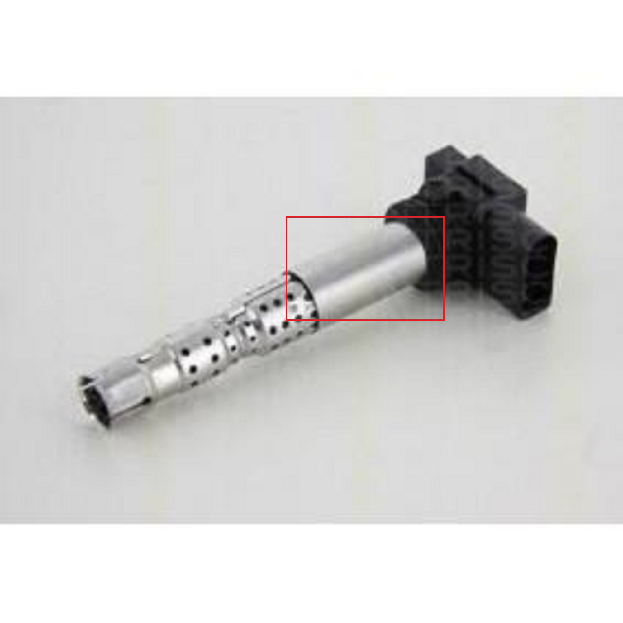

Hello Toney,
I am not sure if the Audi A8L W12 non turbo coils are useable in the Bentley, maybe a different rate of spark ??? But you asked for the Audi part number, so here it is, mind you that I purchased 12 of these back in August of 2013 for my 2005 Audi A8L W12 from Princeton Audi at $17.25 each, part # 07C 905 715A.
Also notice that the date on the old coils are dated 2009 (prior tuneup) in my 2005 Audi A8L W12, I believe that the new coils I installed were dated 2009 also, as can be seen on the box "31.07.2009", so at the time the "715A" was the updated replacement for the Audi.

This was part of the update, a longer shield to stop the coil from arcing inside the head.....
