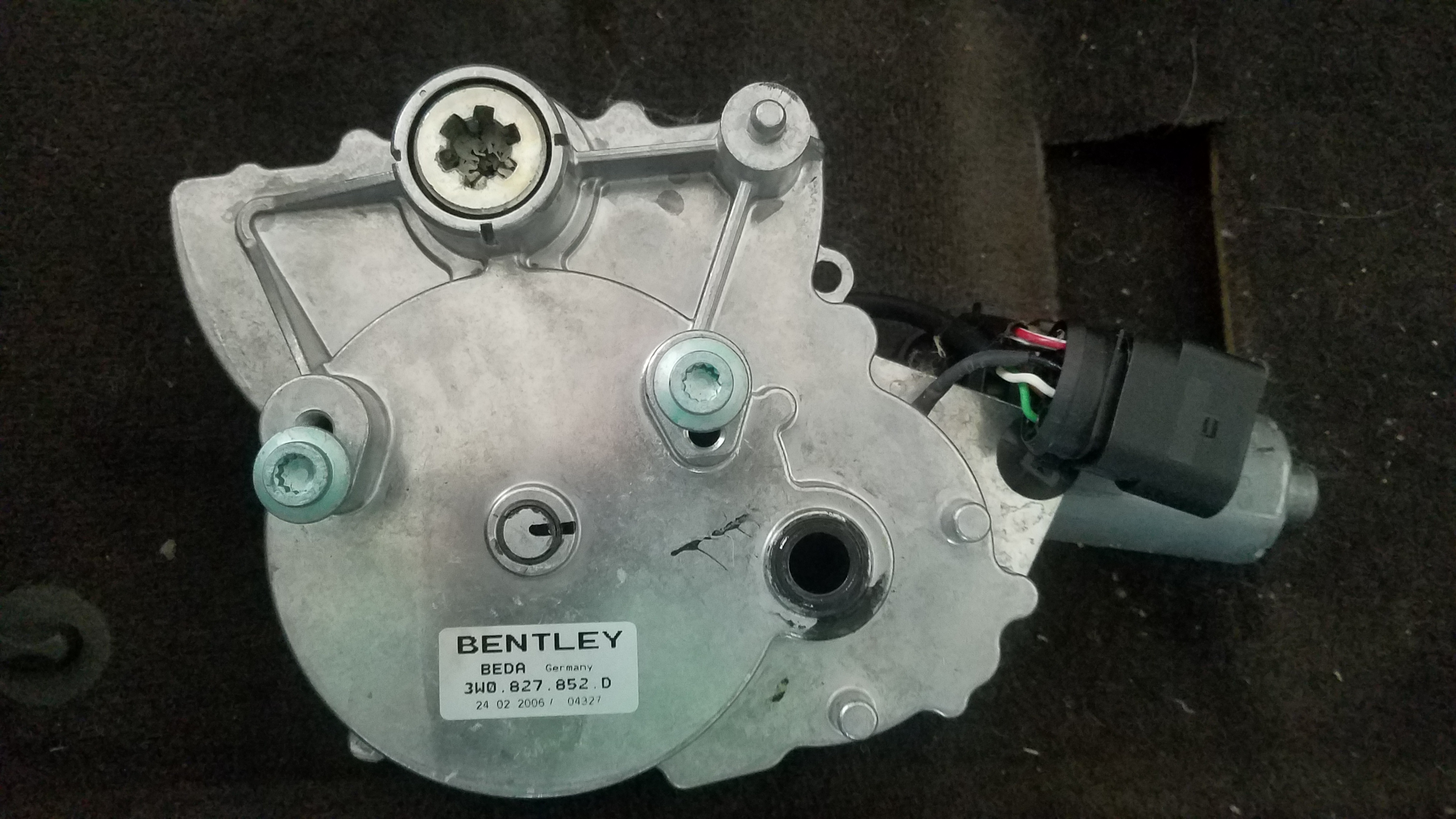

On a minor annoyance level, my trunk no longer closes smoothly. It drops the last 6 inches, and slams. It didn't so this 2 weeks ago. I suspect that the gas struts have lost some of their force. Is this likely?

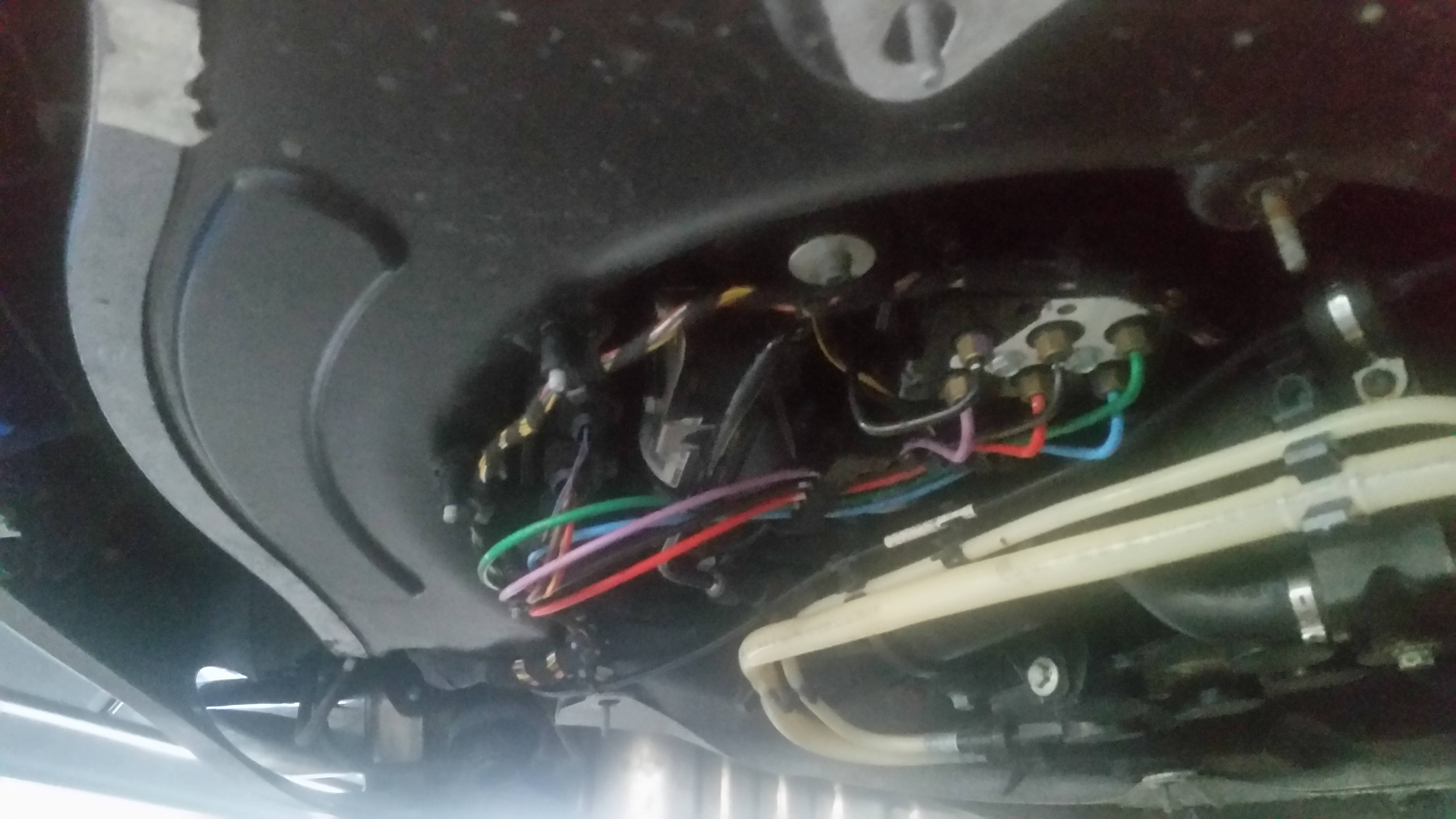

As far as releasing the air pressure, when I replaced all the upper, lower control arms, tie rod ends, etc. 13 pieces in all on my A8l W12, I had to remove both front struts to get at the upper control arm bolts, I myself thought the same, "how am I going to remove the air pressure after putting it in lift and jack mode to pull onto the lift when I forgot my laptop with Ross-Tech VCDS at home.....
", so after it was in the air I just slowly loosened both front air lines just enough to bleed the air, I then did the front end job and lowered the vehicle just until the tires touched the ground, then started the engine, took the suspension out of jack mode, lowered the lift another inch or so, and put the vehicle back in jack mode to lift off of the lift, or you can a VAS 5054, or 5052 if you have one, or the Ross-tech software and cable if you have it, see the video of the Ross-Tech SW in action bleeding and charging the suspension.As far as the power lift and close trunk lid motor, this is the first time IIRC hearing of a Bentley trunk lid motor failing, now I am not sure if Bentley did the same as Audi did with the A8/S8 power lift and close trunk motors, on the Audis the earlier units were plastic and would fail after time because of flex in the plastic housing, they would most of the time fail to lift the first 4" or so, and needed help by hand to get past that 4" point, then would lift fine, depending on the weather my Audi will either lift or not (4"), or will drop the last 3 inches, many on AW have replaced the trunk struts to no avail, others have added a small spring up by the left hand hinge to give it a pop open help needed, and that worked for the lifting problem, but not the slamming of the last inches before latching, now some have said that each side has a different part number trunk strut and that they have different load pressures for each side, and as the lifting motor only lifts one side, that makes sense, also the updated units are a full metal housing and also a higher torque rated motor, so check to see what you have in your 07 GT, as my 05 body did not have the option but I am retrofitting the unit from the 07 parts vehicle into mine, here is the 07 unit I have.

As for the trunk closer, it opens just fine. It's just that when it closes, it suddenly drops the last 4 inches or so. It didn't do this 2 weeks ago. I suspect that the small gas struts that help it open are losing their force.
