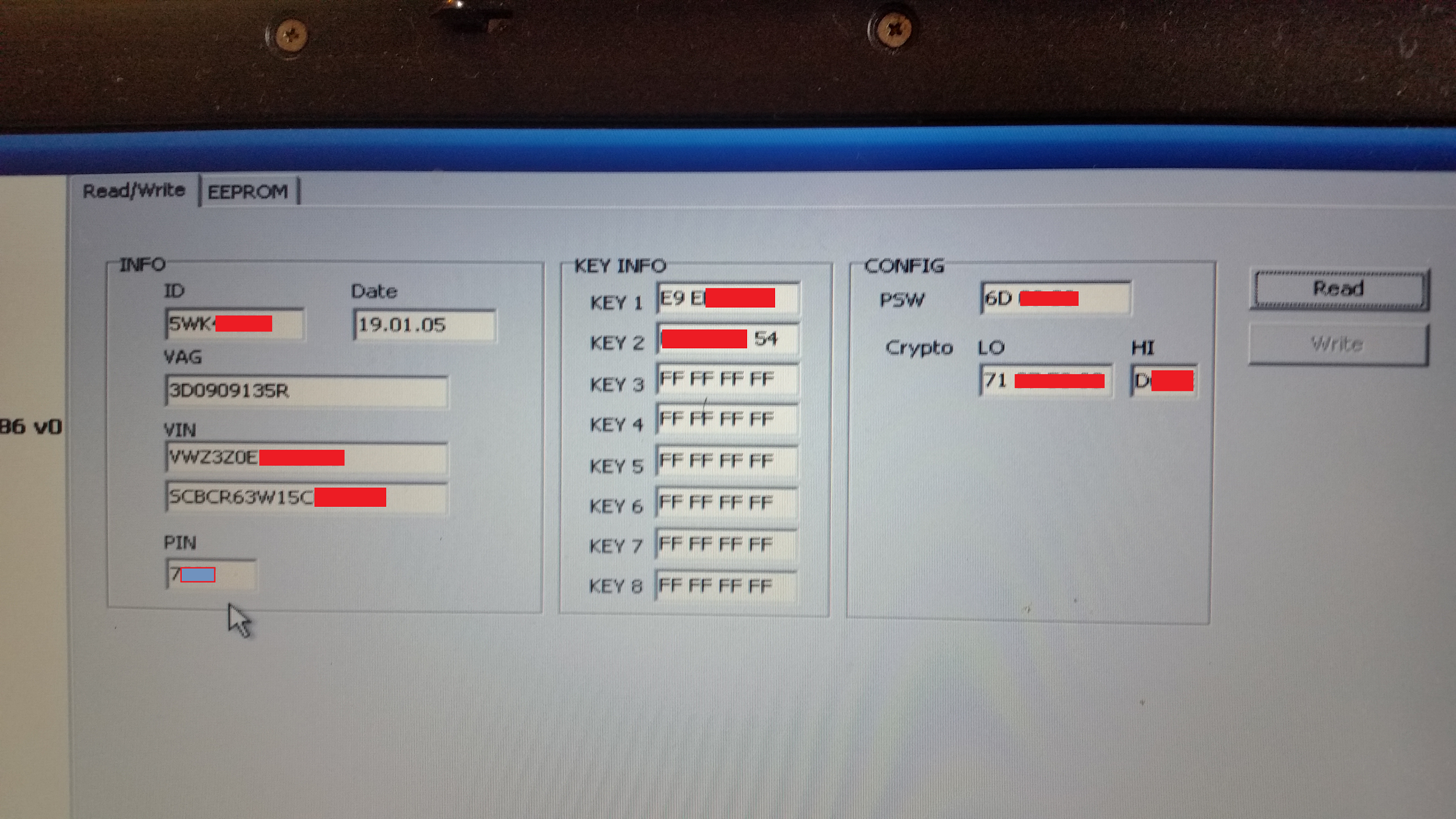

As far as reprogramming the key, that is the magic question, reprogramming a key that has already been programmed to another vehicle, some say it can be done, some say impossible, I have not found that person that can, and I actually stopped looking as I did it myself with new keys explained further on below, the most important thing to realize is that the older 2005 and prior keys were "READ ONLY", so one could use any old key of that year or older to a certain point off of eBay or the like, and add them to the vehicle, BUT the new style 2006 key is "READ & WRITE", but "ONLY WRITE ONCE", now why all the newer style keys are on eBay for big bucks if they cannot be reprogrammed is beyond me, but as I have said and read, many of the sellers I questioned back before I ordered new keys, stated that they knew people whom could return a Bentley read-write key to "Virgin State", but again, I did not find that person at the time.
So, I know first hand that I was able to program the brand new keys to my Bentley GT, and I have also had luck with a few used keys on Audi A8L's 2005-07 with push button start and keyless entry (smart key), there is a guy in NY who does "reprogram" used keys and KESSY modules, but there is a catch, as what the person in NY does is, if you lost all your keys you would send him your KESSY and he would use older guts of Audi keys to match to your KESSY, or if your KESSY were to be fried as mine was, he would "match" your keys to a used cloned KESSY, but when I pressed him for some answers, I did not like what I heard, especially for the Bentley, it turned out either way I did it, lost keys, or fried KESSY, or no keys and bad KESSY, it would always be that he would give me some old Audi key or put the old Audi key guts in the Bentley key housing, and the worst of all, I would loose push button start, and keyless entry, I would have to use the buttons on the remote or the key blade itself to lock and unlock, also to start, that was a no go for me...
So, if you yourself do not have the equipment to retrieve the required SKC = secret key code, AKA PIN#, it will be impossible for you to do, I know I had posted here before in my "GT Re-Build" thread of how I programed my new from the dealer Bentley keys, but now I can not find that info in my thread, but I do have the links for when I shared the same info on AudiWorld, also just to note, I paid $570.00 for both brand new keys ordered by VIN # which is for the cutting of the blades to match the drivers door and glove box locks, it was called a key service pack, now the keys still needed to be programed as ordering by VIN is only for the blade cutting, so being my KESSY module was easily accessible as I completely stripped the vehicle, I opened said KESSY module and removed and read the 93C86 chip with the CARPROG {$60.00} the get the SKC PIN#, once I had that I re-installed said chip, and used my Ross-Tech VCDS to program the new keys to the KESSY module, I know this sounds like a lot of work, but the KESSY module is located under the carpet on the drivers side floorboard in the area of your left foot, also I have read that this same SKC can be read from one of the engine control modules off of the 95080 number chip located in either ECU, but I have not confirmed that yet, I could open one to verify the chip does reside in either ECU if needed, as I have 4 ECU's sitting here, the dealer also quoted between $500-$700 for the programming on top of the $570 for the new keys, plus I would have had to tow her into the dealer, so I did it myself.
