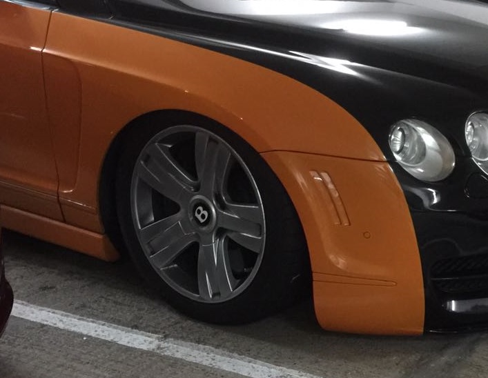

Funny how some things happen as after the replacement of my front GT struts my friends FS strut failed last week.
I didn't think much of this as parts do wear and it is a known problem for these heavyweights. However, it cant be a coincidence as another friends FS also failed within this time period.
We've had pretty hot weather lately but I doubt they can kill the air strut so easily. Each of our cars have covered different mileage but in terms of manufacture year we are all around a 07.
Has anyone tried replacing just the air bladder section on the strut?
J
