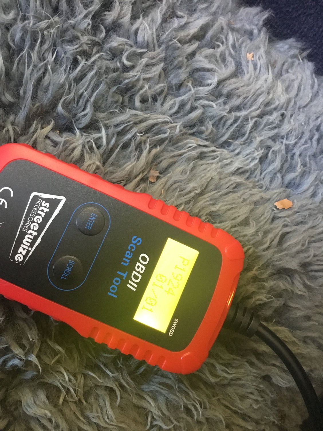

Hi ,guys the CEL came on , no symptoms runs fine ( 2004 conti GT )
After I did not fully click the oil filler cap .I think I added too much oil , so I removed about a pint .
i have used an OBD2 reader .
initialy I thought oil vapour may have mucked up a sensor in the inlet kinda excess crank vapour ?
I disconeted the air intake pipes and shot WD 40 into it while running, the CEL light went out straight away when I reved it up .
About 200 miles later it came back on ,same code .After deleted. It comes back on after 10 mins while warming up .
Any how any ideas what code P1924 means please

The CEL has gone out. This was the stored code now deleted.
P1924
It went after topping up with 60 L of Swiss She’ll RON 98.
i did put French 97;in on the autoroute down .
Ihave Googled it and the best response is this
8331P1923Engine control module (ECM) 2 – malfunctionTrouble code(s) stored–
P1924Engine control module (ECM) 1/2, pin coding – impl usible signal.- ECM
So does anybody know what the “” pin coding for (ECM) 1/2 “”[ presume both module s ? ] “ implausible signal “ means please .
Bear in mind it ran perfectly with the CEL on and runs fine / same with it off .
i read somewhere a guy had his software re programming done ,in old school talk is that chipped ? For more power .
A few weeks later he got a P1924 - but the thread pettered out - not conclusive
Anyhow it’s gone spontaneously since 60 L of RON 98 .

"implausible signal" usually means the value returned from a sensor is way out of spec. In short, the sensor is working in that it is sending a signal, but the ECM can't make any sense of the value. I have seen this caused by a low battery, frayed wiring, loose connections, etc. You will need a VAS5054A or equivalent diagnostic system to chase the problem deeper. If you flushed the error codes and they haven't returned, I wouldn't worry too much. The CEL is a true PITA as it indicates a problem with too many variables.
