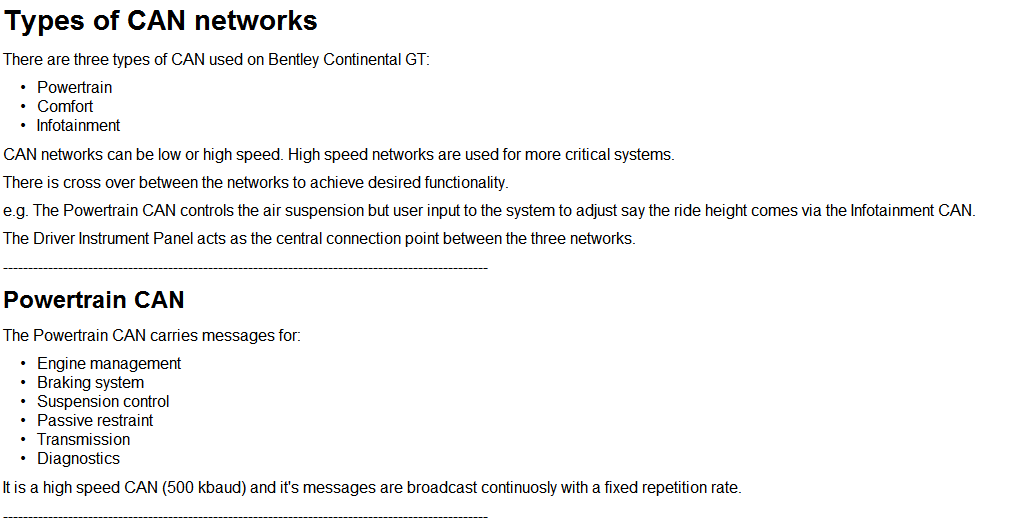

May I ask why you would be looking for the gateway module, if I were you, I would disconnect both batteries, charge them up and load test them, then replace if necessary, what you are describing is typical of dead batteries, also so you know, the Bentleys do not have a stand alone CAN-BUS gateway module say like the Audi A8L has, the Bentleys CAN-BUS is spread out in the instrument cluster and the Infotainment head unit.
