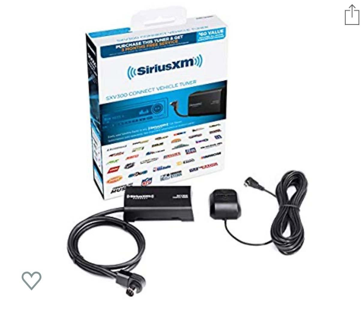

[quote=Rico.Adams;4802953]
TJ ... When you did the upgrade to the infotainment system did you install a DAB arial or something else as in the US you guys use a different frequency, I have a DAB arial in the rear window at the top
Don’t know what they call it here vs over there but it was the magnetic one that comes with the tuner.
SiriusXM SXV300v1 Connect Vehicle Tuner Kit for Satellite Radio with Free 3 Months Satellite and Streaming Service
Amazon Amazon
