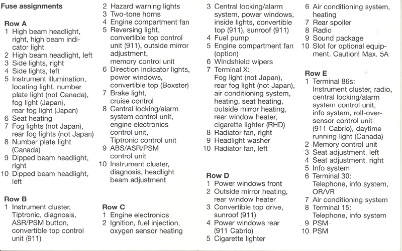

been trying to get this radio thing sorted out. thanks for all of the help so far!! as previously stated, i have the codes. i had to disconnect the battery several times to finally get the system to ask for both codes, but it did and i have successfully entered both. the problem now is: the audio portion still does not work. the navi works fine. the ac controls show up on the screen. everything is working except the audio portion. the radio, cassette and cd changer are all non functioning. so, i opened the hood,trunk to remove my cd's from the changer and noticed that i do not have any power to the cd changer either and i noticed the courtesy light is out. i checked the bulb. it is fine. i checked the hot and it is fine. i checked the ground and it is broken. does the cd changer share a ground with the courtesy light? just a thought. or, are the 2 totally unrelated?

while trying to sort out all of these audio system problems, i have had to refer to this fuse assignment chart quite often. i posted it here just in case anyone else needs one.

Man that sucks - Mine was working great before I brought it to the shop. They change the battery out and said I need to enter the radio code. When I got home and enter it - got nav to work fine but no ration frequency pickup, no CD and no Cassette.!? Is there another fuse on the head unit itself? That is the only thing I can think off since Changer and amp usually need at least a remote signal from the head unit...

Yes there is a fuse for the head unit...also check wiring. It is also possible the head unit went bad (this happened to me under warranty it was replaced)

Don't throw your unit out man - the problem is the fuse on the head unit... I remove it and change out the fuse - got my tune back instantly (CD, NAV, Radio, and Cassette - good to go)!

When I got mine the battery was dead dead. The jump from the tow truck extra duty jump system blew both the radio fuse and the head unit fuse. Took me a while to figure out that there were two fuses.

Same happened to me from jump. 10A fuse on back of radio.
