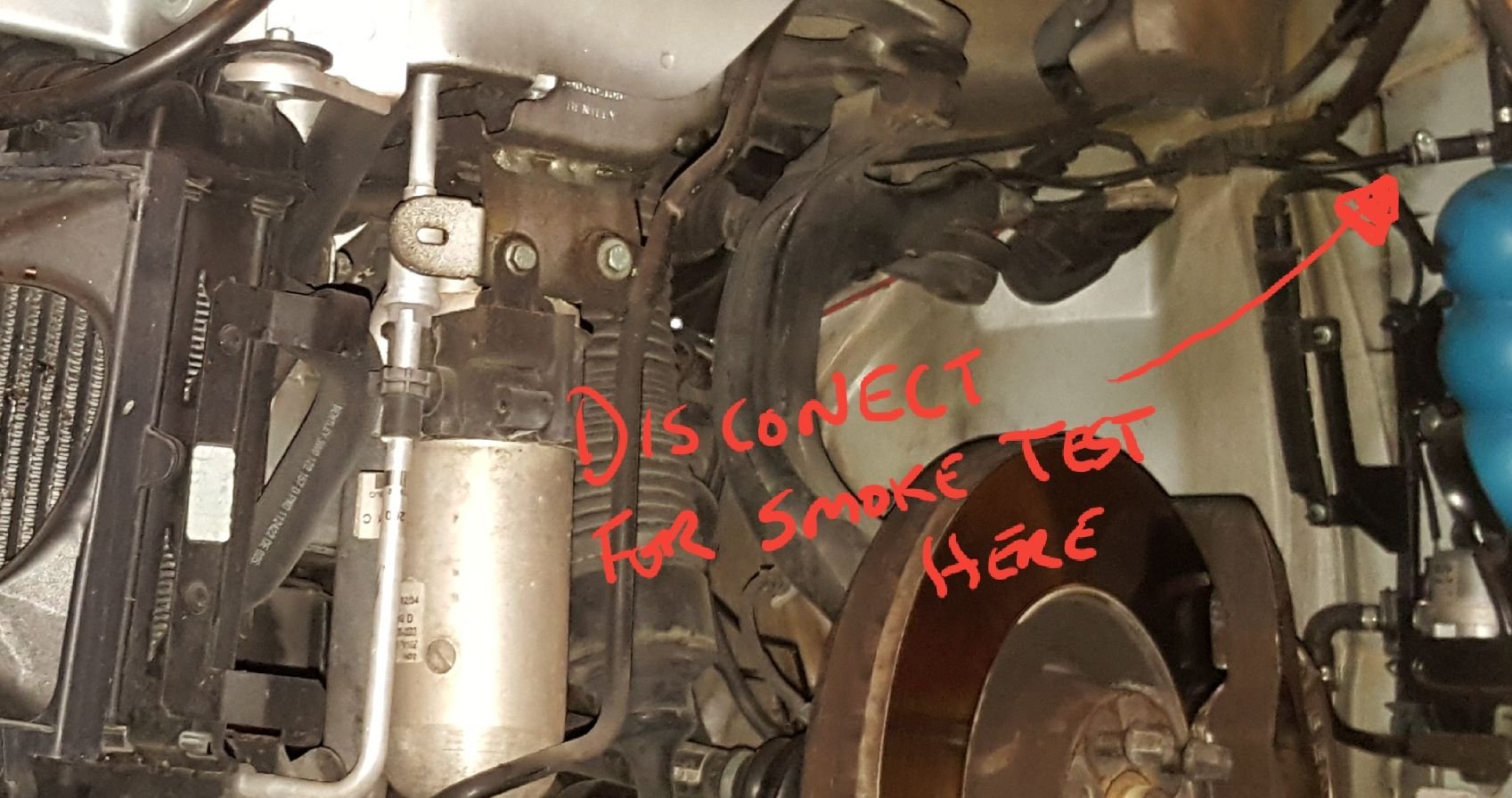

Trouble codes p0445 and p0442 could be an indication of a vacuum leak behind the steering rack? Smoke testing will reveal the truth. In the meantime best to erase all the trouble codes and start over. The trouble code laundry list looks like a weak battery at one time.
Attached is a photograph of where to start the smoke test. This will involve removing the inner driver side wheel well shroud left side. The plastic line which will be removed from the vacuum pump is where the first smoke test will be conducted.
Leave all other lines connected.
From the area where you took pictures there are two 13 mm plastic lines. The line on the passenger side right side, disconnect it carefully from the round plastic one-way check valve. The one-way check valve should remain on the rear manifold connection. The 13 mm plastic tube should have no components connected to it. Please do not handle this 13 mm line carelessly, it will crack very easily behind the steering rack and definitely leak. These lines have become fragile over time. With the vacuum pump line reconnected, inject smoke down this 13 mm line. This test will reveal if there is a vacuum line leak that controls the EVAP system. Smoke riseing behind the steering rack indicates where that leak is. There is a metal junction behind the steering rack that contributes to the vacuum lines cracking.
There are factory oitiker clamps on the vacuum line junctures. When replacing the clamps either use fuel injection clamps or use oitiker clamps, not good to use standard radiator worm clamps. Oiteker clamps are available on eBay and Amazon.
There are other areas to smoke test, let's start with the above two.
Not sure on this but sometimes a loose gas cap can cause the same problem.
