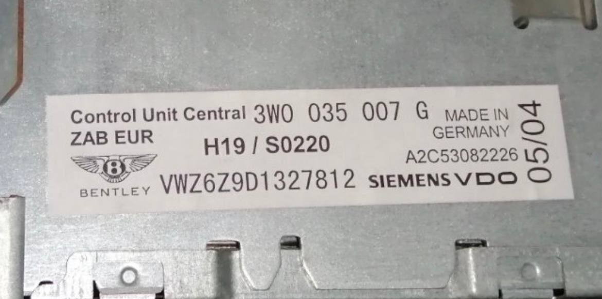

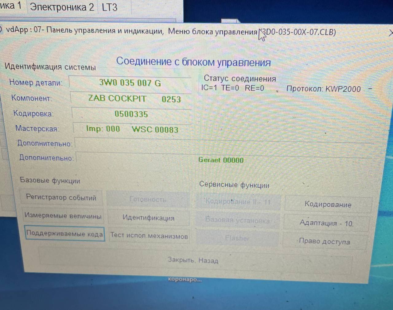

Oh, then i don't understand why there were no DAB stations, when i was in covered zone. still, not a big loss, due to low bitrate. one more thing to do - video-in-motion, i need access code for "ZAB cockpit" to find speed when in cut's off video

I know about this algoritm, and used in touareg:
firts digit - always 0
second - second symbol from the end
third - fifth from the end
forth - last digit
fifth - forth from the end, like:
BUT! it didn't work (
and my vsds is offical, localized 21.4.0 PRO version, it has no Advanced ID - 1A, just identification on the place of that button
So i used serial from sticker on other side of head unit
still loocking for the solution. But, I think, newer head units can be edited with this code
