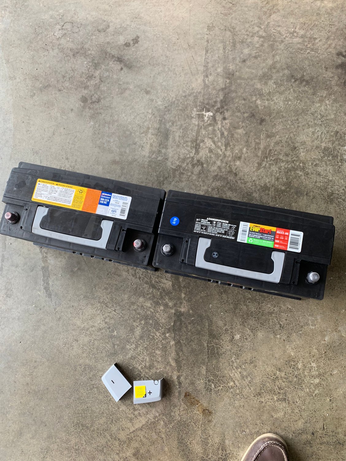

Small hammer or something else to seat the battery connector
A H8 sized battery is required. I bought mine from Walmart, it is a Everstart H8 for $118.00 and a 3 year replacement warranty. You DO NOT need a fancy battery from a fancy manufacturer such as Optima, Deka, or Duralast Platinum.

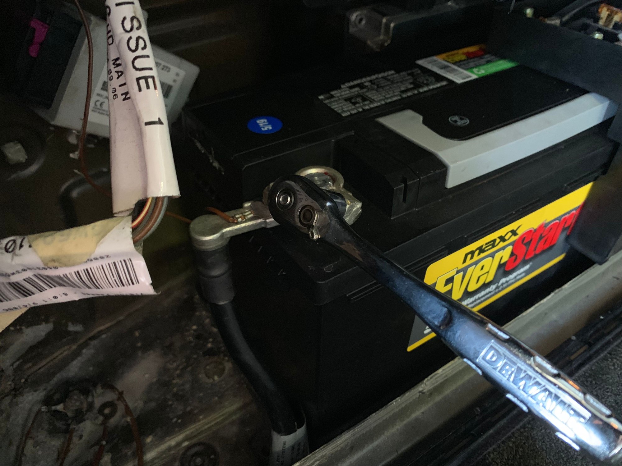

Second step: Use a 10MM socket to disconnect the black negative (Earth) terminal. Set it beside somewhere. It is the terminal closest to you. The left side of the battery.

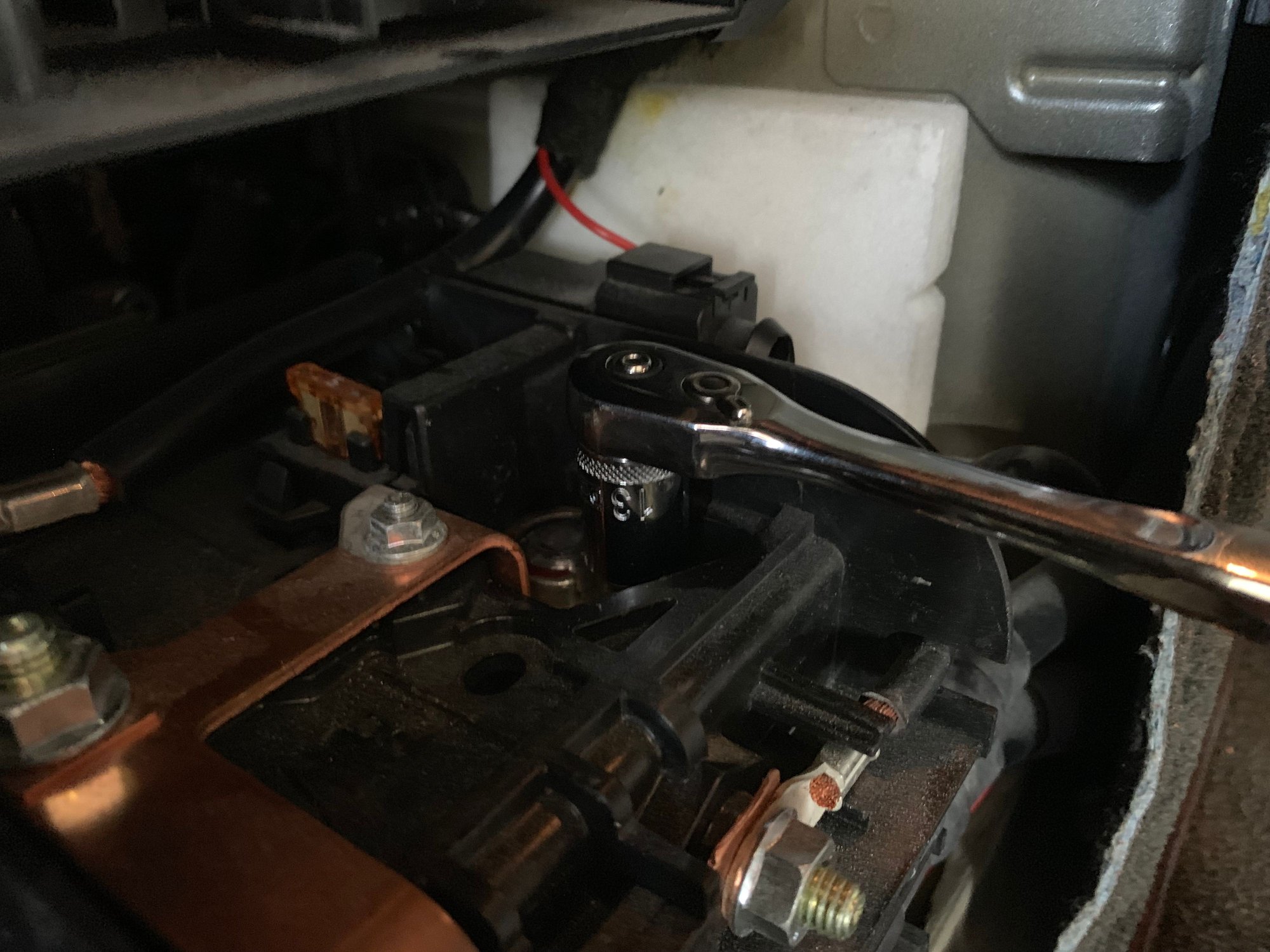

Third step: Use a 13MM socket to remove the positive terminal. It is the large nut similar to the negative. Lift off the entire black block and set aside.
NOTE: If you can not move the block far, some cars have another wire leading to ___. See photo, remove this to get some more room to get the battery out.
Now, there is a small bolt (13mm) on the right side (farther away from you) of the battery, this is the hold down. Unbolt this, and set the bolt aside. The bracket stays in, but you should now be able to move the battery away from you towards the front of the car.

Positive terminal
The bolt in the middle of the photo is the hold down.
