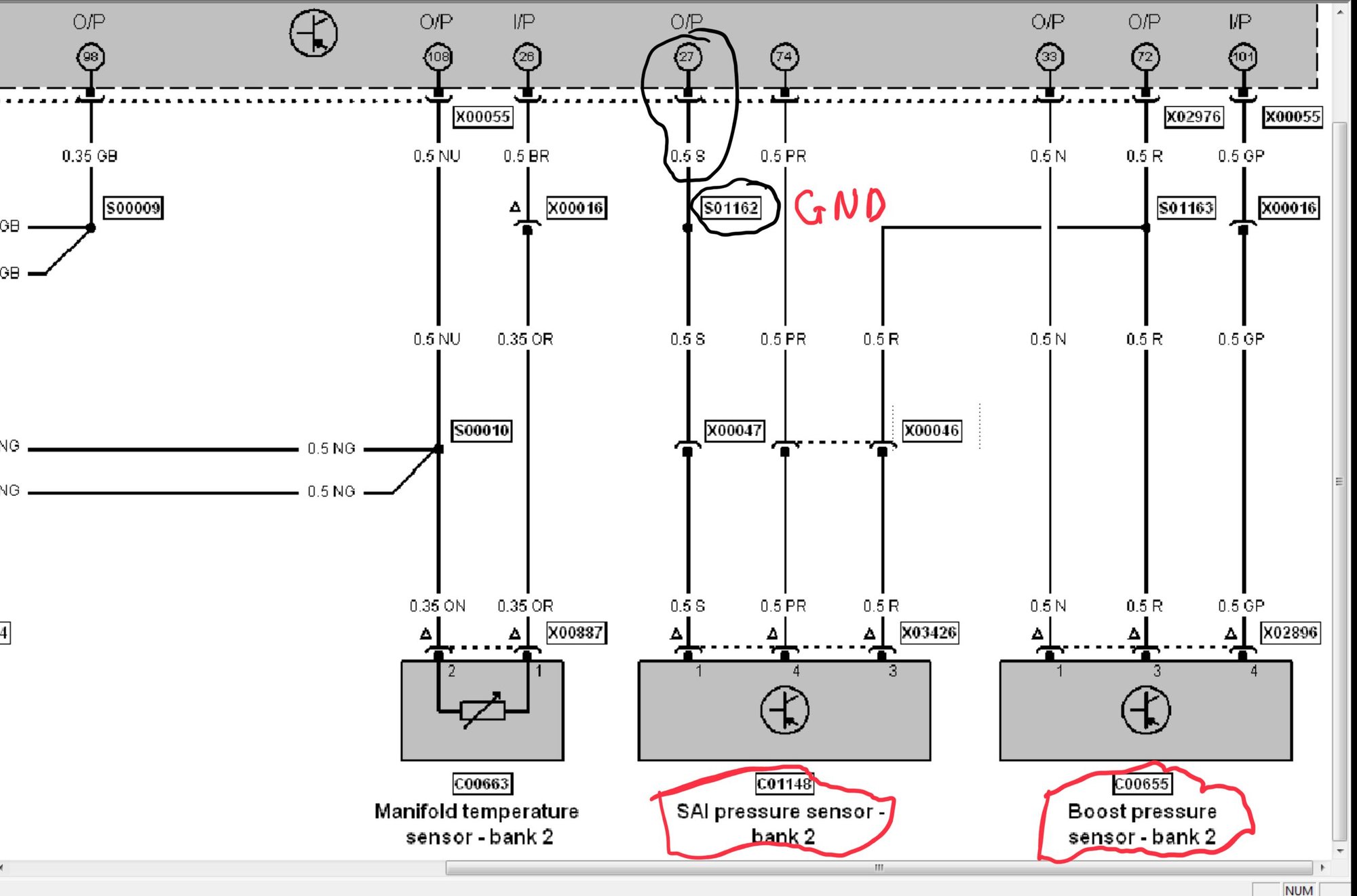

@BWings that the one I got from Audi dealer here...
anyway I found some nices thing today...

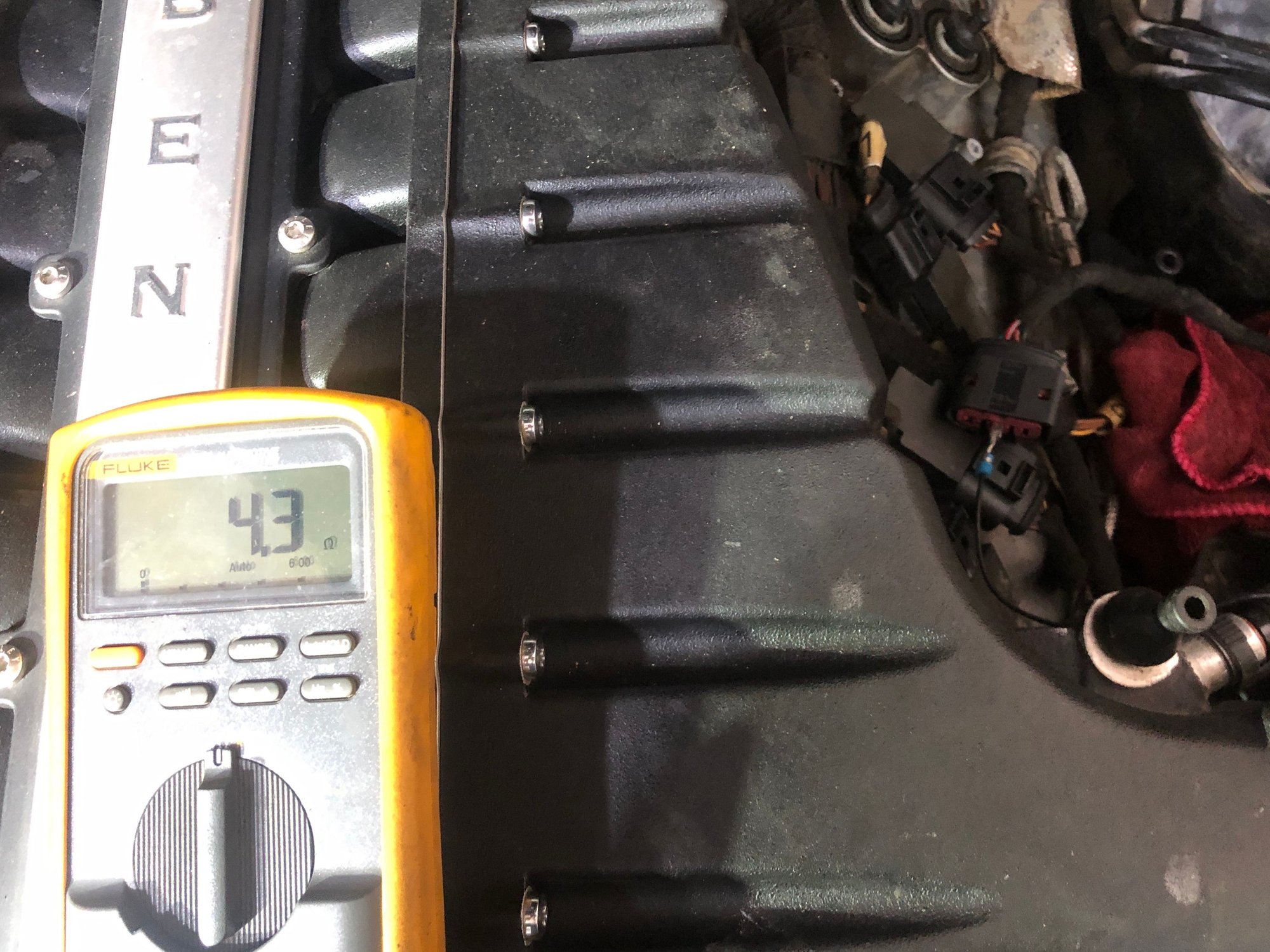

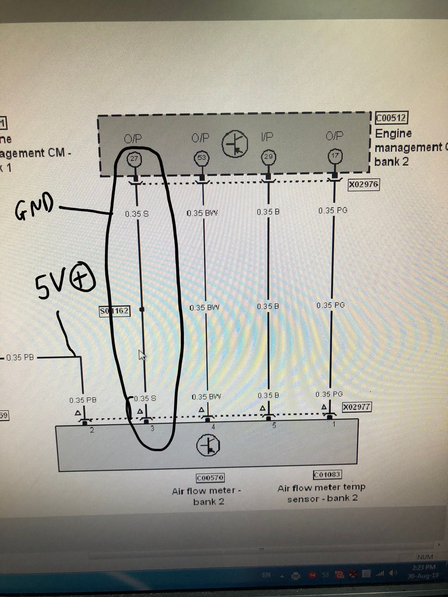

PIN 3 from MAF which go to ECU then GND...
I CHECKED pin 3 from BOTH MAF then do a COMPARE...
here is BANK 2 read 4.3 ohm then when I'm knock in the ECU it change the resistant... sometimes OL...
and here is BANK 1 ... 0,8 OHM constant...

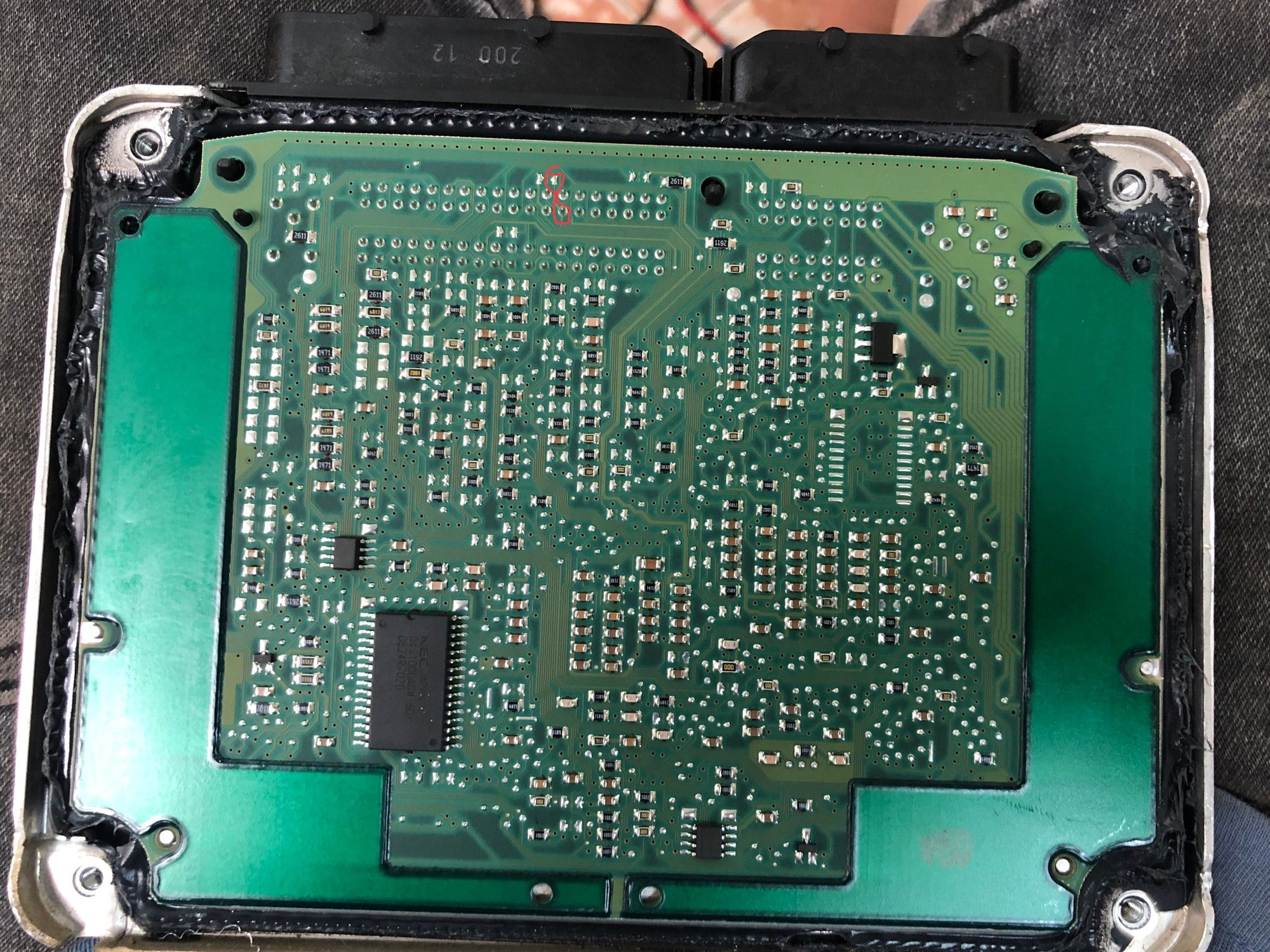

then I follow the wiring diagram.. to check that the PIN 3 which actually going to pin 27 of ECU 2..
then I found out the Pin 27 on ECU 2 not solder well... I solder it back then it read constant 0.8 ohm like Bank 1...
Today is Thunder storm.. I will wait the weather back to normal then test it then let you guy know

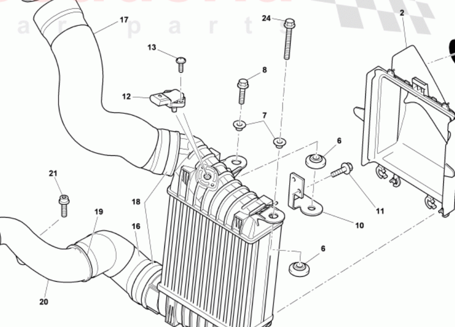

While you have this much access, one more remote possibility. If you can reach the pressure sensor in the leftside intercooler, check wiring and sensor. This pressure sensor also inputs to the ECU for fueling. Here again, I cannot find any examples this sensor failure leads to a P2190, but it is very difficult to reach unless you have disassembled like you have. A good opportunity. #12 in this image.

NG,
Make sure the large hoses to and from the leftside intercooler have good connections no cracks or leaks in the hoses.

@BWings I did check the sensor as u said plus I swap the sensor from bank 1 to Bank 2.. also..
I did check all the hose of course when I'm doing a clean up... it has a lot of DUST there..
I 'm using the Foam Cannon to clean it up

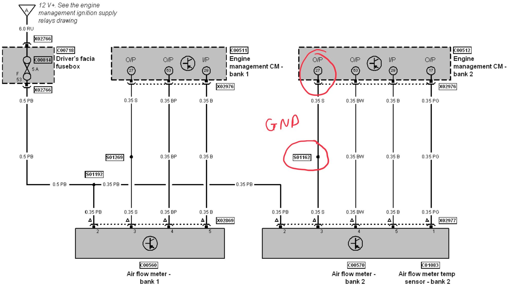

Today I look at the diagram again... and Find out why if PIN 27 (GND FROM ME 7.1.1) getting loose it will set multi code which Include
SAI Pressure sensor
Boost Pressure Sensor...
if u look at the diagram.. both SAI Pressure Sensor and MAF sensor both going to Pin 27 they use the same GND..
so If one lost GND both will lost GND also => 2 fault code set then Misfire due to In correct Air Measurement...
SAI connect to Boost Pressure sensor.. then if SAI lost Power Boost Pressure Sensor will do the same...
Good Start for anyone who has the same issue...

ONE more THING....
If pin 27 fail completely...
DO U THINK WE CAN USE DIRECT GND ? bypassing the ECU GND

I hope I am not speaking too soon, but congratulations!
You are a very good risk taker with much electrical knowledge!
Not sure on the ground. In theory, yes on a bypass because a ground is a ground. My concern is this is all low voltage circuits 5v, and digital electronics on a Can bus, but could make a fix like yours simple.
Best to you sir!
