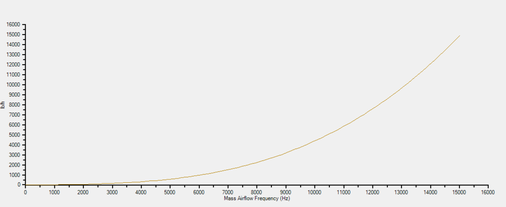

Take a look at this MAF graph. It shows typical MAF output frequencies from less than idle to past redline. Idle is around the 3000 to 5000Hz range. As you can see by the slope of this curve the low frequencies around idle can be off by a very small amount yet cause huge amounts of over (or under) fueling as the ECU will chose a fuel delivery based on the Hz signal it receives from the MAF (Right or wrong).
So, if this were my car with a P2190, first swap MAFS and see if the problem follows to the right side bank. MAFs can have a failure in only some places along its curve. It can also fail completely. Since it appears the engine is running at all other RPMs and operation conditions, I would eliminate the MAF FIRST before pursuing anything else.

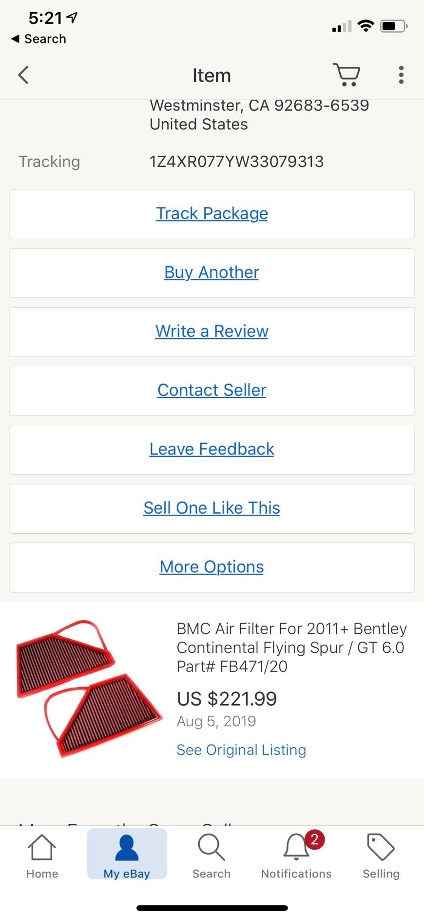

Maybe I will try to change the spark plug and Air filter first...
I will order Autolite XP3923, I have very good experience with this brand, and the BMC air filter ( did anyone try it yet)

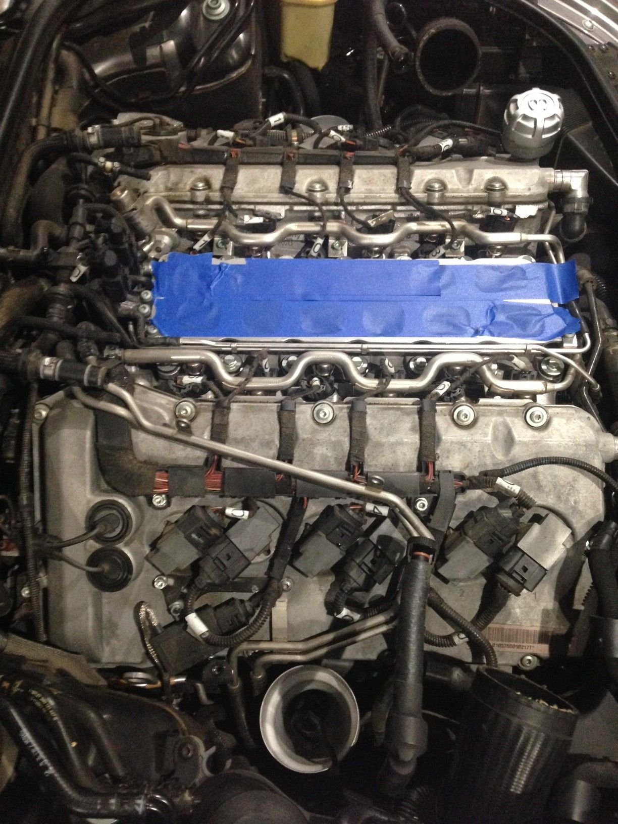

One other thought on the P2190 - if you've had the intake manifold on and off for different reasons are you sure about the gasket integrity? This gasket is prone to leaks and should be renewed every time removed and intake manifold bolts torqued properly. A leak here could cause a rich fuel issue and it might only be at one bank 2 port.
The gasket fits where the blue tape is in this picture.
If instead of removing the entire manifold, yours was disassembled on each side, then those gaskets too can contribute.
