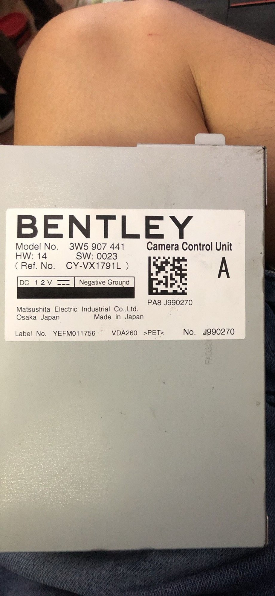

My Bentley has bad Rear View Camera Module... the part no is : 3W5 907 441
I ordered from Scuderia Car part and it will come here in 3 or 4 week...
While waiting for the Module I just wonder did anyone replace it before? I heard it need calibration tool.. what happen if we doesn't calibrate it? will the image still come?

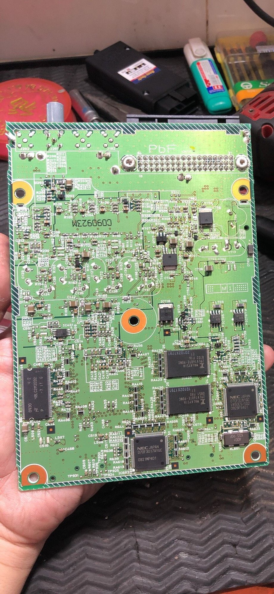

or anyone know how to repair it please teach me because The module still talk with ODIS it just doesn't sent out the image

@Johnny : because I have both car so First thing I do is I swap the camera module from the black one to the white one..
but the black one is belong to it so it already has the calibration and coding.. and of course it plug and play..
I just wonder about the brand new unit does it need to do calibration as I saw in the ODIS screen..
but if u said that then I will be happy... because it need a lot of money to buy VAS calibration tool

@johnny : Yes, I have both car, because in my country the part is so rare, and I need to wait about 3 to 4 week to get the part from the USA, so normally in order to diagnostic something, I will swap part from car to car.
This time I swap the Rear view camera module from the White car to the Black car in order to verify that is the correct problem.
My camera still working good, just the module is bad and I went to scuderia car part to get the brand new replacement.
I just wonder if I put new unit in any calibration need to be done like in the ietis said..
