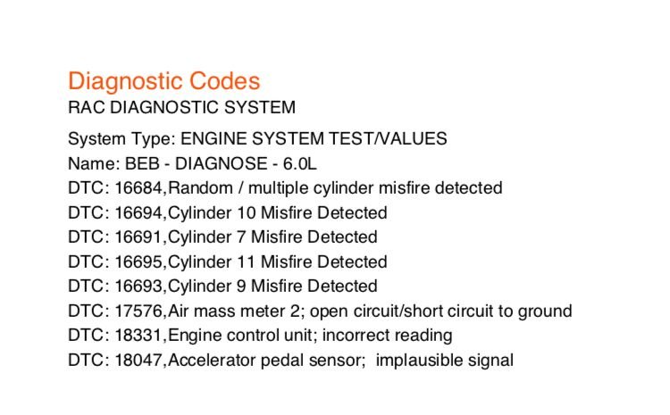

That said, lets concentrate on the list of codes you posted in #3. In diagnosing this sequence, and I am assuming the shop that produced it just deleted these to see if they came back? Instead, you now get a P0202 and P0741? If you delete these two codes they come right back? Do I have that right?
In looking at the list of codes in #3, at a glance, I would concentrate on two and put aside the rest for the moment. The two serious codes you have are:
18047 and 17576
These two codes and the source of failure that caused them probably caused all of the rest of the misfires including the multiple misfires. It is a coin toss which one of if both are the culprit, but lets take them one at a time. BTW, both are serious faults and could cause limp mode which is what you might be seeing now in the P0741.
18047 - This platform is a drive by wire. There is no physical/mechanical connection between the accelerator pedal and the throttle bodies. Instead, the pedal uses a sender unit and sends a range of voltage signals in the 5v range that receivers in the TBs pick up. Motors in the TBs then set the butterflies in positions to match commanded throttle. 18047 essentially reports that this signal went completely out of the expected range (probably momentarily). Since this is an extremely serious signal (you can't have the engine in an RPM range you didn't command via accelerator pedal) the EMS will instantly default to limp mode. The pedal sender works like a rheostat and a simple signal dropout that is intermittent can set all of this limp mode in motion. You might see this again, and if you do, you'll probably need to replace the accelerator sender unit or wiring could be at fault.
17576 - This is also a serious fault. It reports the Bank 2 MAF has either failed or wiring to it is the problem. BTW, all of the misfires are the cylinders from bank 2 and this is bank two MAF. The misfires are likely all false and were reported as a result of the MAF failure bank 2. Also BTW, MAF wiring issues and MAF failures are pretty common and another recent long thread just addressed a similar problem. The MAFs are a primary input to the fueling algorithm, as such, if the MAF quits sending a signal, even momentarily can set a limp mode.
Combining all of this including the first list of codes, along with the recent P0741 code, it could (but lower probability) be a bad ECU or wiring in and out of the ECU especially given this is an 04. The weird shifting you described in your first post now sounds more like limp mode.
And a note: just ignore 18331 (ALWAYS). This is not a fault of any kind. it is only a pointer that shows up in Address 01 (ECU 1) to direct the diagnosis to address11. It goes away when the real faults are corrected.

thats correct they deleted the codes and now just these 2 codes exist. The intermittent accelerator pedal has stopped showing up 18047. The fact it is now showing injector 2 there must be merit I getting that changed right? Does injector 2 also sit in bank 2 or bank 1?

Also since we sorted the leaking vacuum hoses all the MAF and cylinder codes have gone including accelerator pedal. So really just these 2 to focus on given I have done 30 miles on the car and the previous codes have not reappeared.

Good, then skip the first fault code list. Vacuum leaks will do that and also common in your MY. Then now I would see two unrelated faults.
