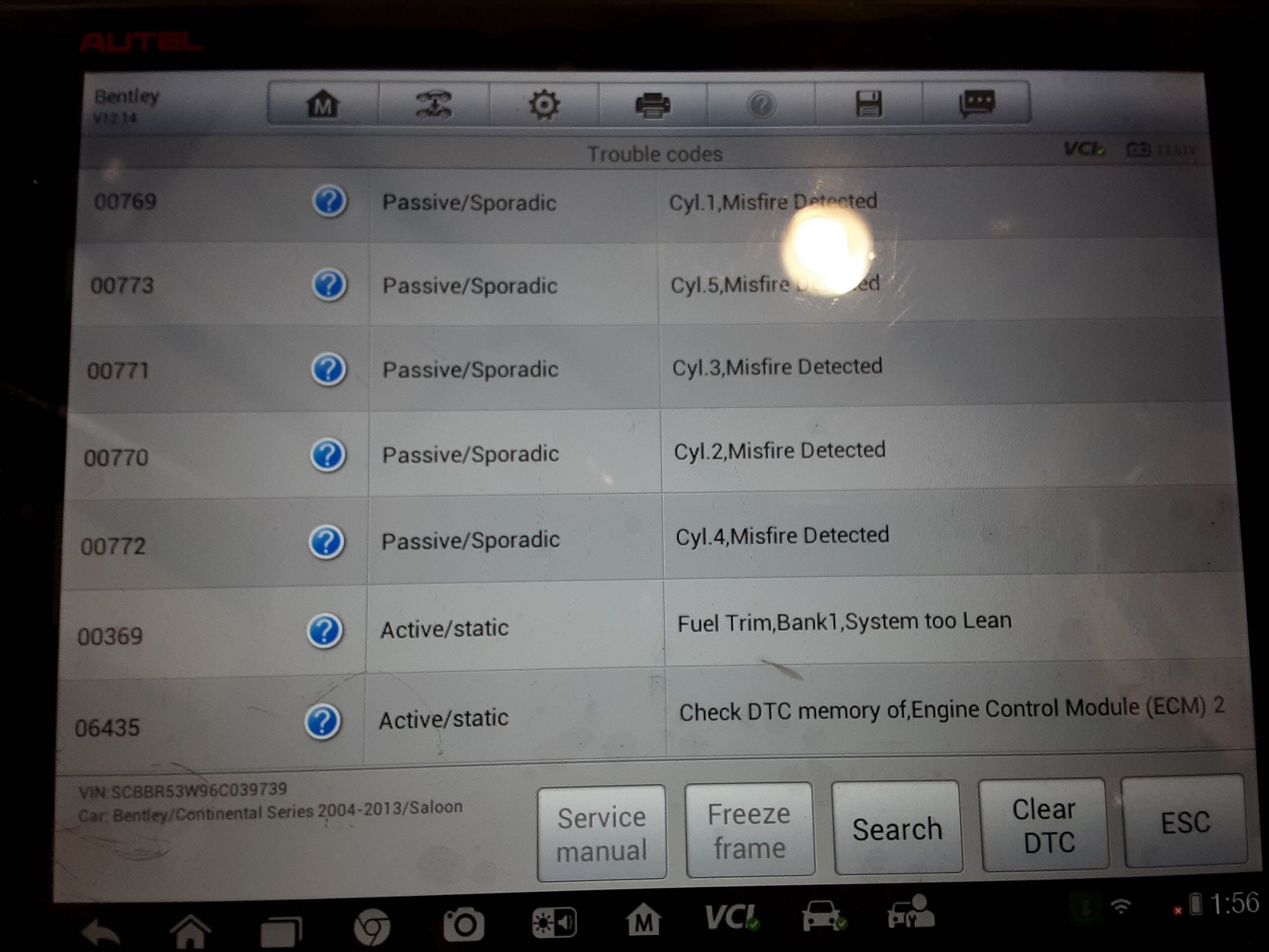

First update: he said codes were recently cleared... go figure... ugh. He said code is "too lean code". He said he will print out the exact code number for me.

Do the codes that I posted point in that direction? My Indy just finished up my state inspection and oil change, and he glanced at the codes and cleared them. He told me to wait for the light to come back on and we could diagnose from there. He did not seem too concerned. He said perhaps an oxygen sensor? He works a lot of high-end cars, including a few Bentleys in the past, but he is not exclusively a Bentley Indy so may not be super familiar.

Everything I’ve learned about my car comes from the great ppl on this forum. Look up the P codes and I’m sure they will lean towards one or two symptoms.

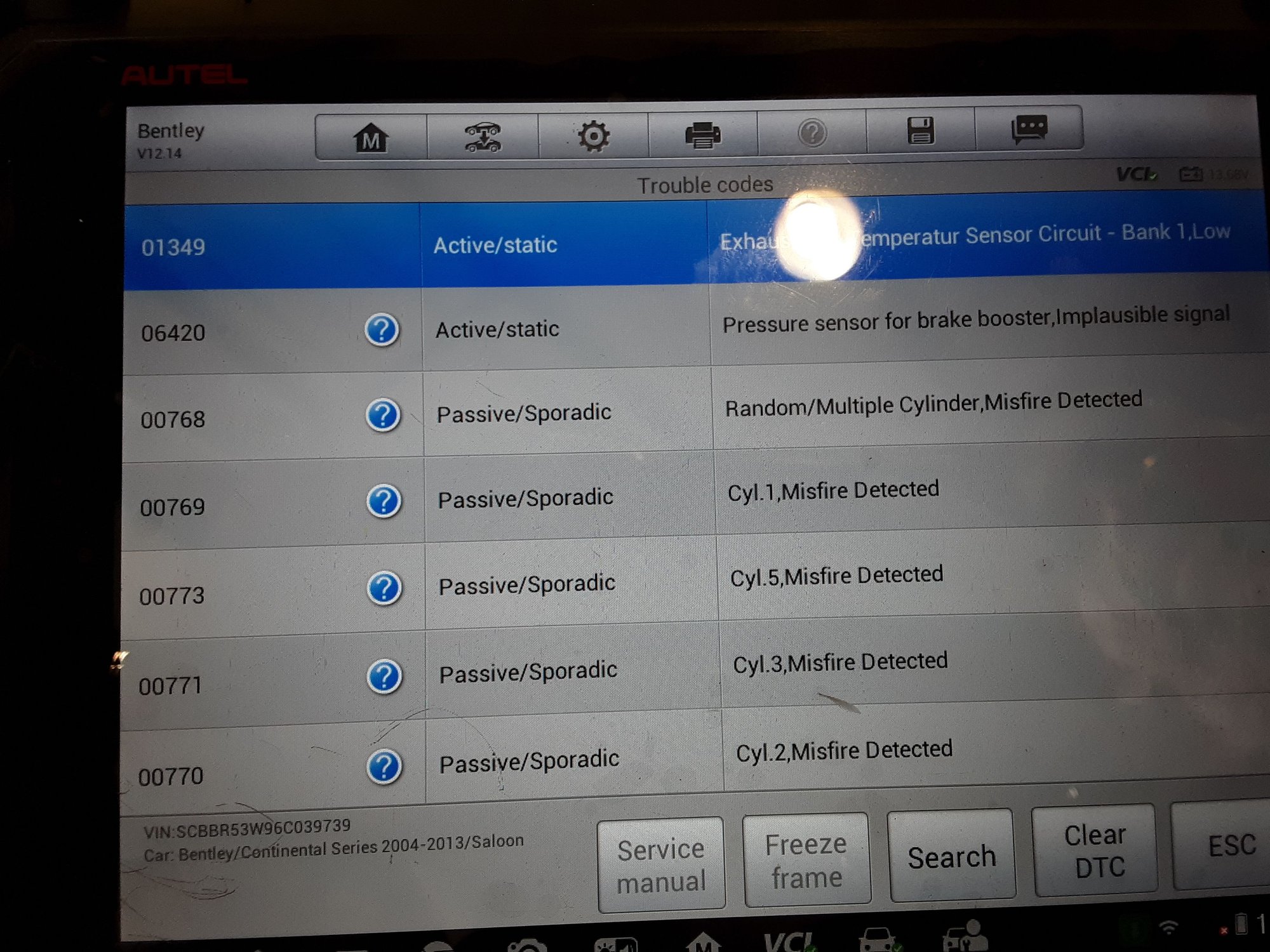

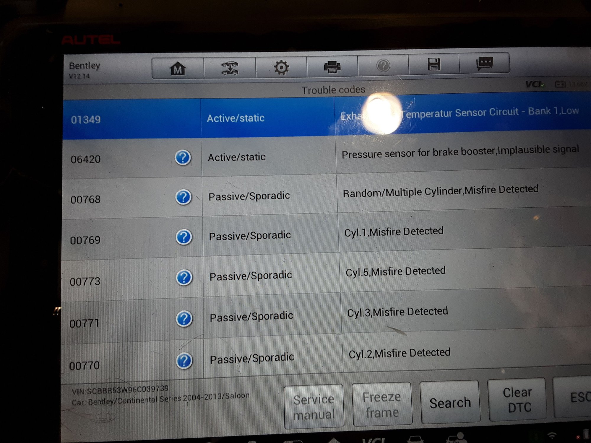

Yes, sir. I posted all the codes in photos a few messages up on this very thread. Let me know what you think if you have time. Thanks.
