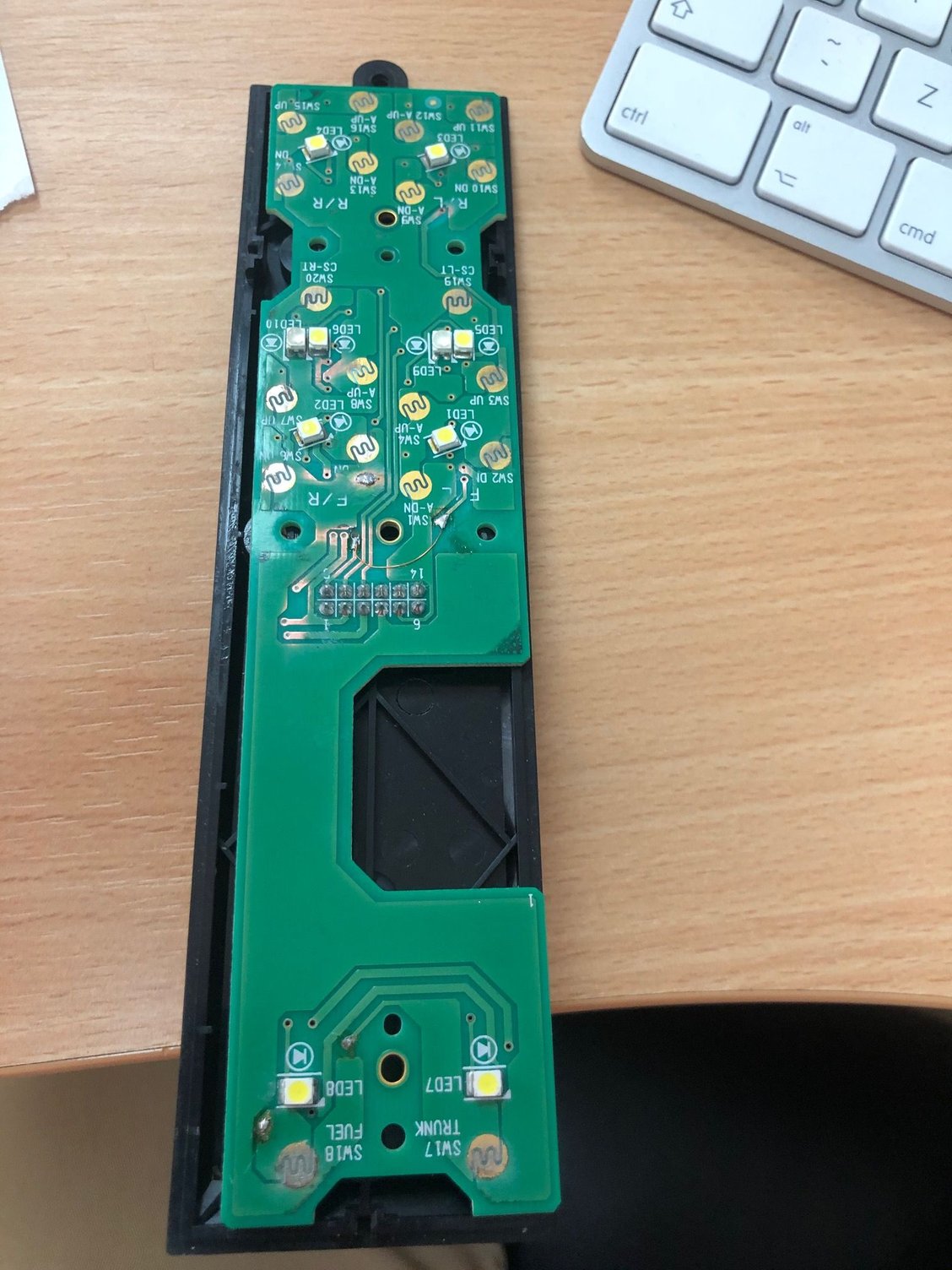

Thanks Dark Green,
I have given the VIN number to the supplier of the Kessy unit to hopefully ensure I receive the correct item. The new garage
are making quick progress. I need to find a replacement circuit board for the drivers side window, boot and fuel cap controls. Can anyone help here?

Originally Posted by jtec963
Thanks Dark Green,
Hi mate it's matt I had the same. Problem and bought one for a vw phaeton for 50 pound open the unit and just swap over the circuit board into your Bentley one as the keys are different

Just to update everyone. The car is now fixed and running very well. The Kessy was replaced - cost me around GBP£250. The window controls on drivers door were also f*+ked. Replaced this with one from a Toureg (thanks Matt!!) - cost me around GBP£60.00. Paid GBP£570.00 for labour.............. so all in the repair was around GBP£900.00. I think this was good value as the car has been off the road since November last year. Just took it our and it's like a flying machine again. Going to keep it inside and covered up from now on. Also, invested in a trickle charger because I've learned that the electrics on these are a fu*king nightmare when they go wrong.
