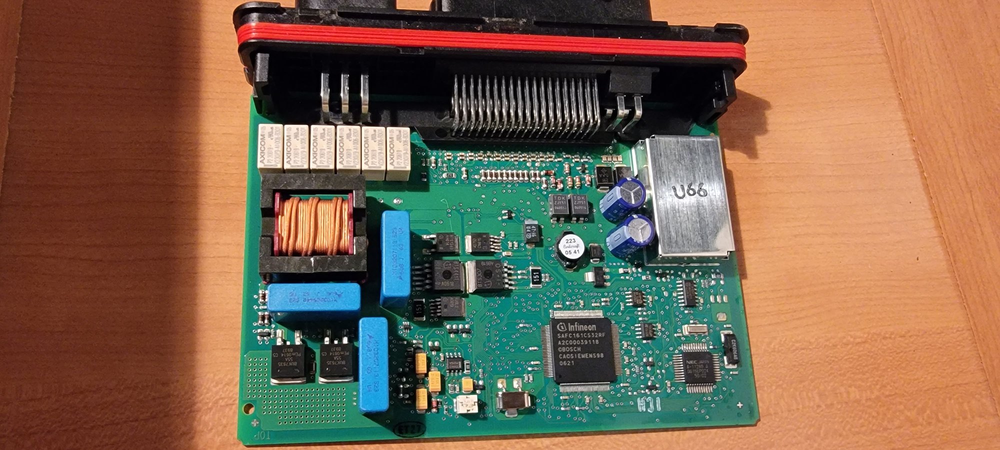

System fault and car won't start.
My Bentley got wet during a heavy rain and won't start. The battery became dead and I just changed the main battery. Car still won't start, message on the dash board says "system fault" take to a dealer. Key is stuck in the ignition and won't come out. The ignition is trying to turn but not start.
Originally Posted by jtec963
Just to
update everyone. The car is now fixed and running very well. The Kessy was replaced - cost me around GBP£250. The window controls on drivers door were also f*+ked. Replaced this with one from a Toureg (thanks Matt!!) - cost me around GBP£60.00. Paid GBP£570.00 for labour.............. so all in the repair was around GBP£900.00. I think this was good value as the car has been off the road since November last year. Just took it our and it's like a flying machine again. Going to keep it inside and covered up from now on. Also, invested in a trickle charger because I've learned that the electrics on these are a fu*king nightmare when they go wrong.
Forgot to say. I had the car fully serviced. All filters etc. Changed the plugs aswell. This cost me GBP£600.00. I would be interested to find out what people are paying for servicing. Thanks Paul.
​​​​​​Hello @Joey1021 ,
Welcome to 6speedonline !
As far as your problem, are we talking a GT, GTC, or a Flying Spur ?
Please elaborate on what get wet, are the cowl drains clogged, therefore flooding the twin ecu's, did you get water on the floor, carpets wet on top or possibly bottom, as the KESSY module is located under the carpet on the drivers (LHD) side floorboard.
Does the Instrument cluster power up as it should ?
Johnny
2007 Bentley Flying Spur. The water came into the car from under the car. The floor carpets were wet on top and bottom. I vacuumed the water and dried the carpet. Please help.
@Joey1021 ,
Ok, did you tell the Bentley dealership of the water problem, as if they knew of the water they should be checking out the KESSY module, but you have not mentioned that, so please tell us.
You say you vacuumed the water and dried the carpet, did you remove the side kick plate and door jamb sill to lift the carpet a bit to get to water under the carpet out, also while in there you would have seen the KESSY module and a black plastic box that hold 4 circuit breakers for the windows..
So please give more details on what has been done.
Also, please share your location, as one of us may help you in person if close by..
Johnny

Originally Posted by Johnny Hotspur GT
@Joey1021 ,
What happened ?
Johnny
Hi Johnny,
I found the kessy, but I need your instructions on removing it. It's still damp under the carpet.
I'm in Queens, New York. Where are you located?
Thank you, much appreciated.

Hello @Joey1021 ,
If you found the KESSY, then remove it by removing the two nuts holding it down, then unplug the two plugs as shown.
Then you will want to open it up and dry it out before it starts to look like the KESSY pictured below...
Johnny
Hello @Joey1021 ,
Johnny
This is the kessy.
I took the Kessy out and attached photos. There is another black box on the floor, should I remove as well. It is under the Kessy.

The other black box does not need to be removed, just open it and dry it out, then replace the 4 circuit breakers.
Johnny
